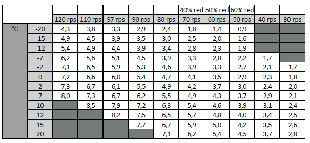

hello to everyone. this is my first post, and I really would appreciate your help
I am about to order my ASHP (Vaillant arotherm plus), and I need to decide between the 55/6 or the 75/6.
I will use it ONLY for heating, no DHW, no buffers, only 1 heating circuit only, only rads, all C33’s.
Last winter, even if it was quite mild (min -6C), we never went above 40C as a flow temp (condensing gas boiler).
Design temp for my area: -12 C, although we did not go below -8 since a few years.
Now my fear: if I choose the 55/6, below -8C, it does not cover my heat loss (missing by ~1kW).
I could use my gas boiler, as a backup (which I keep, anyway, for DHW only), for such cold weather,
Overall, I consider that is better to have a very low modulation from the 55/6 for the normal outside temp, instead of oversize (75/6).
P.S. is there any backup heater sollution from Vaillant (to be installed together with the 55/6) ?
I really looking forward for your advice. thanks, adrian
Funnily enough I was looking at something similar for a friend yesterday.
The 5KW model has a lowest modulation of around 2.4kW at 7C outside (which is when mine sort starts to cycle)
This is 30-35C flow diagram outputs
The 7kW at the same 30-35 flow temps will go down to around 3.2kW at 7C outside
At 40-45C, the MAX output of the 5kW is 4.9kW at -12C
And the 7kW at 40-45C at -12C is 6.7kW
As you don’t have and DHW to worry about and it sounds like you’ve got back up heating. If you’re very close to your requirements on the 5kW, maybe that is the best choice for you?
Vaillant do a backup heater, I think 3-9kW available
I don’t have one but have been trying to find out how they are wired up in case I need one (I’m also erring on the low side not the high side in terms of heat pump capacity). None of the easily accessible Vaillant schematics show how to connect it so its controled by the heat pump.
I was also wondering whether my 3kW immersion heater could be used as a backup. The answer must be yes with the right plumbing and control strategy!
What is your calculated Heat Loss?
Hi Brian, the heat loss is ~ 7kW at -15C and 5,2kW at -7C
Curious on the tech charts that it doesn’t show an output on the 5kW model for -15C or -20C?
because it’s the 65C chart, double check the pdf
Cooling upsets the CoP calculation! Should be just under 5.
The Wh, flow rate and yield come from ebus.
You’re right, good spot, apologies for that. I’ve updated the info a few posts back with the correct 30-35C 7kW data.
