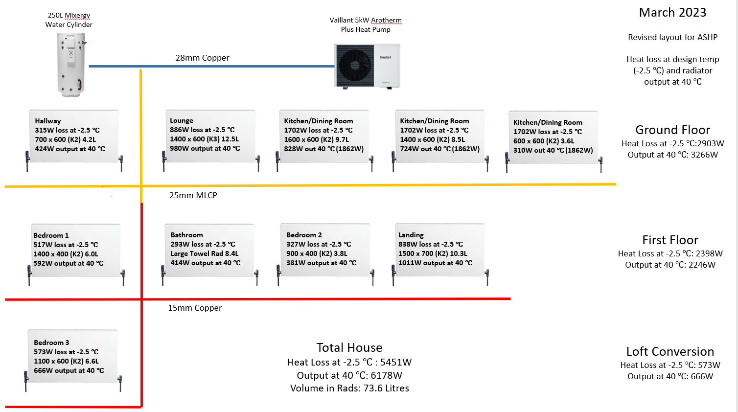

I’m about to have my gas boiler swapped for a Vaillant Arotherm Plus 5kW ASHP and have been keenly absorbing as much info. here and elsewhere as I can. I’ll be adding the ‘level 3’ heat pump monitoring package to add to my existing Solar / Battery monitoring platform. I’ve agreed to my installer’s inclusion of a 45 litre buffer tank and, while I originally wanted to run an ‘open’ system, for my particular application I can see the sense in it, despite the extra complexity and (some) losses. To some questions:
  1. Can I assume that the heat meter in the monitoring setup goes in the return pipework of the ‘house’ circuit rather than the heat pump side of the buffer? This way, if I can extract COP info. from the Vaillant’s integral controls (VRC720), I’ll expect it to be different than on the ‘house’ side of the buffer, as the flow temp. into the buffer will always exceed that of the outlet, if not by much.
  2. Currently my existing radiators are controlled on a room-by-room basis from my Loxone miniserver and associated wireless radiator valves. With the ASHP, I propose to apply room set points a bit higher than required temperature (as upper temp limits), then let the Vaillant controls run the system purely on weather compensation and flow temp. I’ll need to tune this to achieve some night set back in the bedroom(s) but expect the Vaillant controls will do this. Bearing this in mind, does anyone have experience of post-ASHP installation and integration (or otherwise) of third-party room controls? Also, where do you generally locate the Vaillant ‘thermostat’ controller? I realise it’s wireless and can be moved, but (again, without experience) assume it’s placed in a ‘living’ space.

Unless you need this for ‘separation’ (gycol in heat pump, water in rads for example). I really don’t know why they are putting this in?
You only need a minimum of 15 Litres volume in the system for the defrost cycle. That’s only a couple of open radiators.
I’d be very interested to hear the rational / design reasons for the buffer, especially as it looks to be £670? Are the suggesting glycol? And are you having extra pumps on the house side?
I’ve just got a full water install with anti freeze valves. Leaving rads open mean I don’t need a buffer!
Glycol, pumps and buffers cost money, affect COP and in most cases aren’t needed.
This will be my system going into this winter.
If my 1930’s semi doesn’t any ‘bumf’ I doubt yours does too?
Most heat meters certainly go on the return (they can be configured on the flow, but better on the return).
But I think it needs to on the pipework back to the heat pump, after any buffer.
On pure WC, it doesn’t matter where the indoor controls go. It just uses the outside temp and the heat curve to choose the flow temp.
There are ‘room influence’ modes that you can choose. So you could use those and move the controller around. Probably best starting with WC and see how it goes.
I use Tado smart TRV to close bedroom rads off around 7pm. Tado only closes the rads and sends no on/off signals to the Vailllant.
You’re right. Run it on vaillant controls ALWAYS. Don’t be having any other controls interfering.

Like you, I resisted having a buffer (i.e. a 45-litre low-loss-header - there’s no physical separation of primary and secondary fluids), but the installer’s view is that, for systems with radiators which will (probably) be turned down or off, the buffer will help to prevent the heatpump cycling on low-load conditions, i.e when heat loss is lower. I appreciate the heatpump will probably modulate down to around 2kW, but I see the point you make; theoretically I don’t need it if the system is ‘open’. Also, I live alone, and while I’m keen on keeping the system ‘open’ as much as poss, there’s really little point in heating un-used rooms, so the effective system volume will reduce. I also accept that adjacent rooms will lose heat to these unheated spaces, and I’m happy to experiment with rads on/off/setback to see the effect on COP and overall comfort / responsiveness. I also have a couple of ‘uninhabited’ spaces which have rads. and need to be heated to anti-condensation levels, one’s a utility room and the other a small engineering workshop with expensive machines to keep rust-free! These 2 spaces will be heated to around 10 deg. C., so the existing emitters will be throttled. Finally on this point, I purposely didn’t change all the rads. to match my heat loss calcs, which I think despite being carefully calculated, use CIBSE and other industry standard factors which tend to over-estimate the end result. I’m looking at my metered annual gas usage and making a judgement between actual consumption and heat loss calcs. Overall, I’m seeing the inclusion of a buffer as possibly frivolous (!) but I want to monitor the system closely to prove its worth, or otherwise. Later, if I can bypass it and lose the secondary pump too (yes it needs one with a buffer/LLH), I’ll do so with more confidence. Happy to discuss further! I note that the Vaillant heatpump controls both modulating pumps (primary and secondary) so I’m confident the two will play together well. The installer originally included for gycol, but I soon got him off that in favour of antifreeze valves!

Lowest I can get mine to steady state is around 450W in and 2220W out, so around 4.8 COP
Anything above 8C outside and mine starts cycling. But cycling isn’t bad in this instance, it’s just I can’t shed 2.2kW of heat in the house when it starts to warm outside.
Your usage may vary.
Extra pumps take electric (hurts COP).
Turning bedroom rads off at night makes sense, like I do.
But there will still be lots of volume in the system to heat.
Surely better to open some of these available rads and heat those than heating a £700 vessel of water?
The heat pump is gonna have to work to heat 45L of water in the buffer, so why not heat the water in the rads instead? 45L is more than half my total house volume.
The other way to consider, which is something i’ve seen is to just stick the buffer on the return and it be just a volumiser. So lose the secondary pump and it provide just a whopping amount of additional volume to your system. Ie, more open space to work in.
Either way, it will be interesting to see the outcome.
