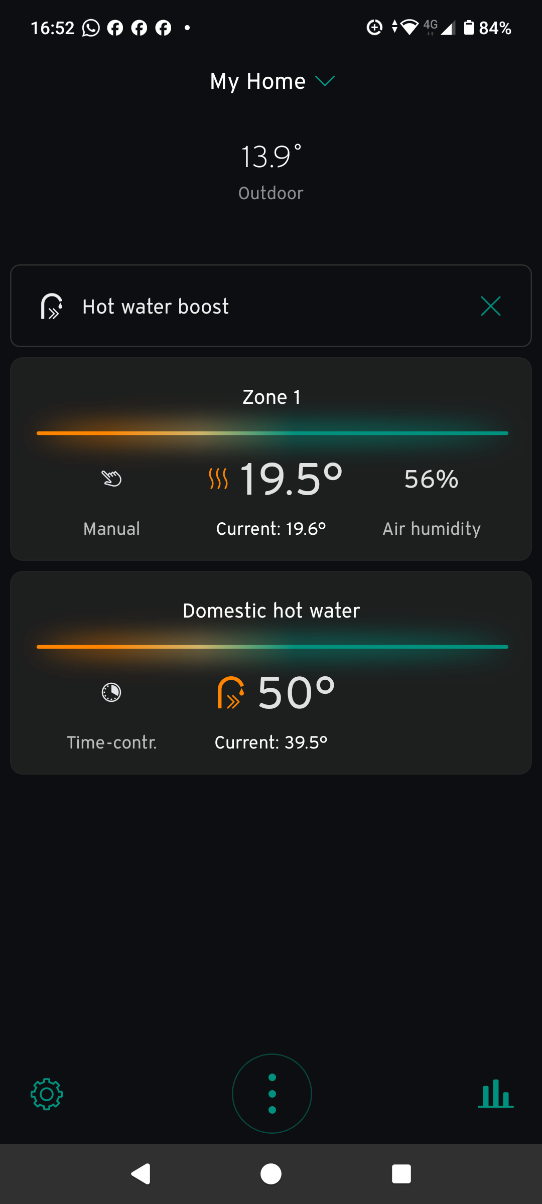

Hot Water Boost:
My normal DHW target temp is 50, hysteresis is 10, max 90 minute reheat period, and no further reheat for 60 minutes. At the moment it’s scheduled to only reheat between 10pm and midnight, and cylinder is only reheated 3 or 4 times a week due to low hot water use.
I’ve had visitors recently, and naively assumed that Hot Water Boost would do just that - heat the cylinder up to the target temperature on demand to allow a number of showers over a period of several hours. But that doesn’t seem to be the case, and despite some tinkering I haven’t figured out the algorithm used to actually kickstart a DHW cycle.
As well as target tank temperature, what other parameters come into play for the Boost to take effect or not? What’s least amount of temporary reconfiguration when I have a houseful of visitors?
What did the hot water boost do then? It should start a DHW cycle but it runs for max. 1h. When I want to trigger a quick reheat manually I either use a Hone Assistant automation that sets the DHW Target temperature to 70°C for a minute and then back, which triggers a cycle (as long as current temperature<70-Hysteresis). You can also just increase target temp from the Vaillant app for a minute.
Thanks Andre. The boost didn’t seem to do anything!
The first time I tried at about 9 am the tank temperature was showing as 32 degrees. The heating was on but Boost did nothing. I can’t remember what other changes I tried. After about half an hour I turned the heating off altogether (heating mode OFF) and a bit later I heard the DHW cycle start. I then turned heating back ON and DHW cycle continued.
The second attempt was about 2pm a few days later. The tank temperature was 39.5 so outside hysteresis range, but I knew there were potentially two showers planned and a big pile of washing up, and wanted to top up heating during Cosy 1-4pm cheap period, rather than during peak rate 4-7pm. This time I increased target tank temperature to 55, and still nothing happened. Soon after 3pm I cancelled the boost and tried again. Still nothing. I cancelled the boost a second time before 4pm and DHW reheated according to the schedule at 10pm.
In both cases the app appears to show heating, hot water and boost on which is a bit misleading.
I haven’t found anything in the documentation to say that the same constraints apply to a hot water boost as they do to normal DHW - but maybe I just haven’t looked in the right place.
I just tried your 70 degree tip - with the app showing tank temperature to be 35 degrees, I increased the target tank temp to 70 before boosting (and then quickly reset to 50 before I forgot!). That worked perfectly, I heard the diverter click over within a minute, tank was reheated to 50 and heat pump then reverted to space heating. But it might be easier for me to swap from time-controlled to manual while there are visitors staying, and then back to time-controlled again when they leave.
