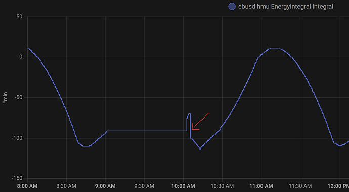

I turned your idea to reset the energy integral into an automation in Home Assistant - here it is if anyone else wants to use it. It currently needs both the MyVaillant integration and ebus as I have not yet found how to turn off the heat pump using ebus. I turn the heating back on twice just to make sure - in case the API is wonky. Local control would definitely be better.
alias: Reset EnergyIntegral after DHW run
description: ""
triggers:
  - trigger: state
    entity_id:
      - sensor.ebusd_hmu_statuscode_scode
    to: "Heating: Compressor active"
    from: "Warm Water: Compressor active"
    for:
      hours: 0
      minutes: 2
      seconds: 0
conditions:
  - condition: numeric_state
    entity_id: sensor.ebusd_hmu_energyintegral_integral
    above: -100
actions:
  - action: climate.set_hvac_mode
    metadata: {}
    data:
      hvac_mode: "off"
    target:
      entity_id: climate.zuhause_zone_haus_circuit_0_climate
    alias: Climate 'Set HVAC mode' to off
  - delay:
      hours: 0
      minutes: 1
      seconds: 0
      milliseconds: 0
    metadata: {}
    data:
      hvac_mode: heat_cool
    target:
    alias: Climate 'Set HVAC mode' to on
  - delay:
      hours: 0
      minutes: 1
      seconds: 0
      milliseconds: 0
    metadata: {}
    data:
    target:
mode: single
Full length heating cycle right after the DHW run:
Here’s the integral resetting:
