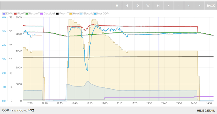

I am wondering whether the EBUS definition is correct. It can’t be the EEV outlettemperature I would say. In below graph, the compressor is ramping up, flow and returntemperatures up, high pressure up, low pressure down. But EEV outlettemperature up? How can that be… Am I the only one seeing these strange EEV outlettemperatures? maybe it is the temperature of the bearing of the compressor. According to the manual there would be a temperature gauge at the evaparator inlet, not so much directly after the EEV outlet. I have a arotherm plus, not a split unit, not sure whether that might matter for use of the codes. If I would have such a bad eev outlet sensors, it is hard to imagine that the whole thing actually works.
What is meant by Vaillant with EEVOutletTemperature? I think their heatpumps have suction temperaure sensor just before the compressor? Have you got refrigerant cycle schematic for your model with sensors designation? By rule they should have termistors just before EEV, after EEV on the evaporator coil and on the suction line of the compressor. Which one of them is this reading for?
These are screenshots from three different Vaillant heatpumps from HeatpumpMonitor.org:
On every one of them you can see a sudden dive of COP just after ramping down the compressor after reaching flow water setpoint temperature. Do you have the same anomaly on your Vaillant heatpumps and can somebody log the EEV position on a cycle when this anomaly occure?
This is from the last hour of Heat Geek`s Vaillant:
