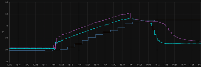

The position of the temperature sensor is crucial. Mine is quite low down so is not representative of temperature of water from the taps.
I think I am going to have build a curve, I have direct power monitoring and have a PCB I need to plug into the interface to start pulling the stats from it. Other than that I just have the data from myVaillant directly or via Home Assistant. I’ve been playing around tonight and its obvious the lag in reporting screws the data on an hourly/daily basis.
Testing out heating the water in the middle of the day to benefit from the warmer ambient temperature. Emoncms reporting a COP of 4.48 for DHW today.
170L tank was at 20C, heated up to target 43C in 50 minutes.
