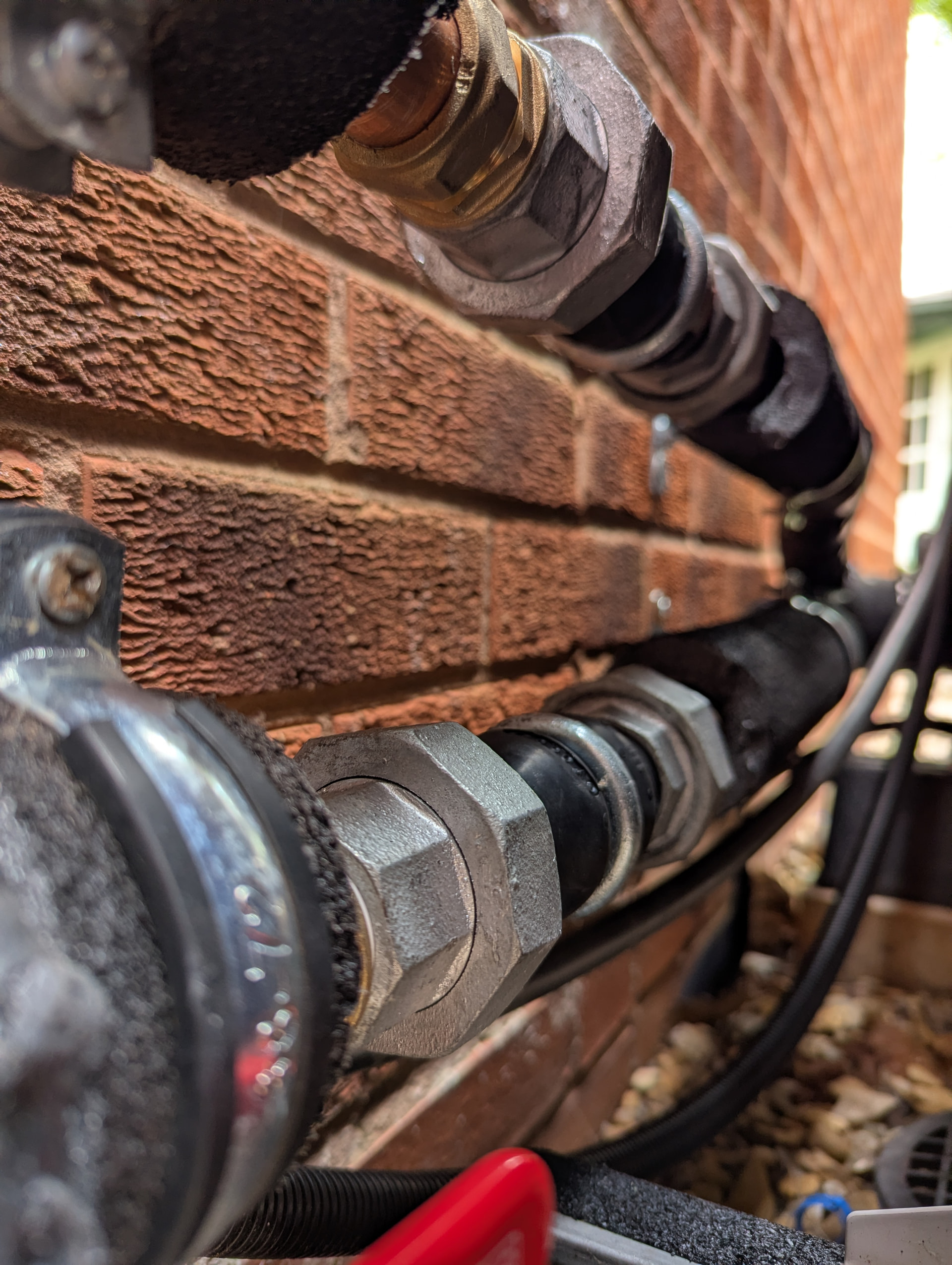

I don’t yet have the means to measure the impact, so my answer for now will be subjective and imprecise. To answer your question unscientifically therefore, I would summarise the overall improvement as ~75%. I’ll try to explain:
Before the bellows were installed I would hear an uncomfortable resonance in different parts of the house, at varying compressor levels. I would also feel a slight vibration in the plasterboard on the inside of the wall where the pipes run up the outside of the house, especially at higher compressor modulations. I no longer experience either of those things. Win!
However, at lower compressor modulations I am still hearing a faint buzz and feeling some very slight vibrations closer to the heat pump, so it’s like the lower frequency vibrations are still having an impact. So, still a work in progress.
I have a few hypotheses that I plan to test over the coming days and weeks (since I want this issue as-close-to-eliminated as possible):
  1. I suspect the flexible hosing that is immediately upstream of the bellows (see photo) may perform better if it were downstream of the bellows. The vibrations I feel on the connector at the end of the hosing furthest from the heat pump are arguably worse than those right on the back of the heat pump; it’s as if the the flexible hose exacerbates the low frequency vibrations. I may try to switch them round.
  2. I suspect that the cheap lagging used on the pipework that runs up the side of the house isn’t providing any acoustic insulation, and the noise of the pipes is transferring into the house. I may try wrapping the pipework in something like this instead.
  3. I suspect that the cheap clips that attach the copper pipes to trusses and joists as the pipework enters our house may be acting as an acoustic bridge into the building. I may try something like these instead.
  4. given the positive impact the initial set of bellows had, I may try a second pair in a vertical orientation in case they help to eliminate residual vibrations on a different axis.
None of my proposals at the moment include moving the heat pump off the wall, since I don’t think the vibrations are transferring through the mount. Instead I think they are travelling through and emanating from the pipework.

Yesterday my installer, Darren Russell our local Heat Geek, installed a pair of the Flex EJ rubber bellows fittings on the pipework behind our heat pump. It’s early days but it seems to have worked brilliantly! I can’t hear a vibration anymore. :+1:

  • I plan to experiment more on this particular point, but we felt that having clamps attached to the walls upstream (from a vibrations perspective) of the rubber bellows lead to more vibrations transferring into the house. I installed the clamps to the right of the bellows in my photo above, and the following morning both my wife and I agreed we recalled a new hum (albeit not especially strong) occurring during the night. After I removed the clamps (and let our flexible piping that comes off the back of the heat pump hang suspended again) we no longer noticed that hum. Again - subjective, and needs more data, but might be something to consider.
  • When a Vaillant engineer visited (prior to us installing the rubber bellows), they suggested using a rubber strip between the clamps and the bricks to reduce vibration transfer. I can’t say whether it’s helped us at all, but it seems like an easy thing to do. I’ve also used rubber washers for the screws.
  • Like yours, our plumber also used clamps that clasped around the insulation rather than directly around the pipework. As an experiment I installed new smaller clamps that held the copper pipes directly (in my photo replacing the clamp on the upper pipe, and on the lower pipe adding a new clamp to the right of the existing larger clamp), and we’ve noticed a further reduction in low frequency vibrations (emitted when the compressor is working between 25-30% modulation). I now plan to add insulation back around those clamps. (Full disclaimer: I am not a plumber, clamps around the pipes and inside the insulation may create other problems I’m not yet aware of).

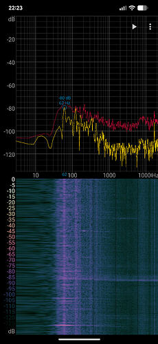

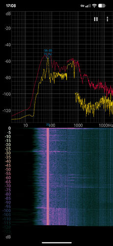

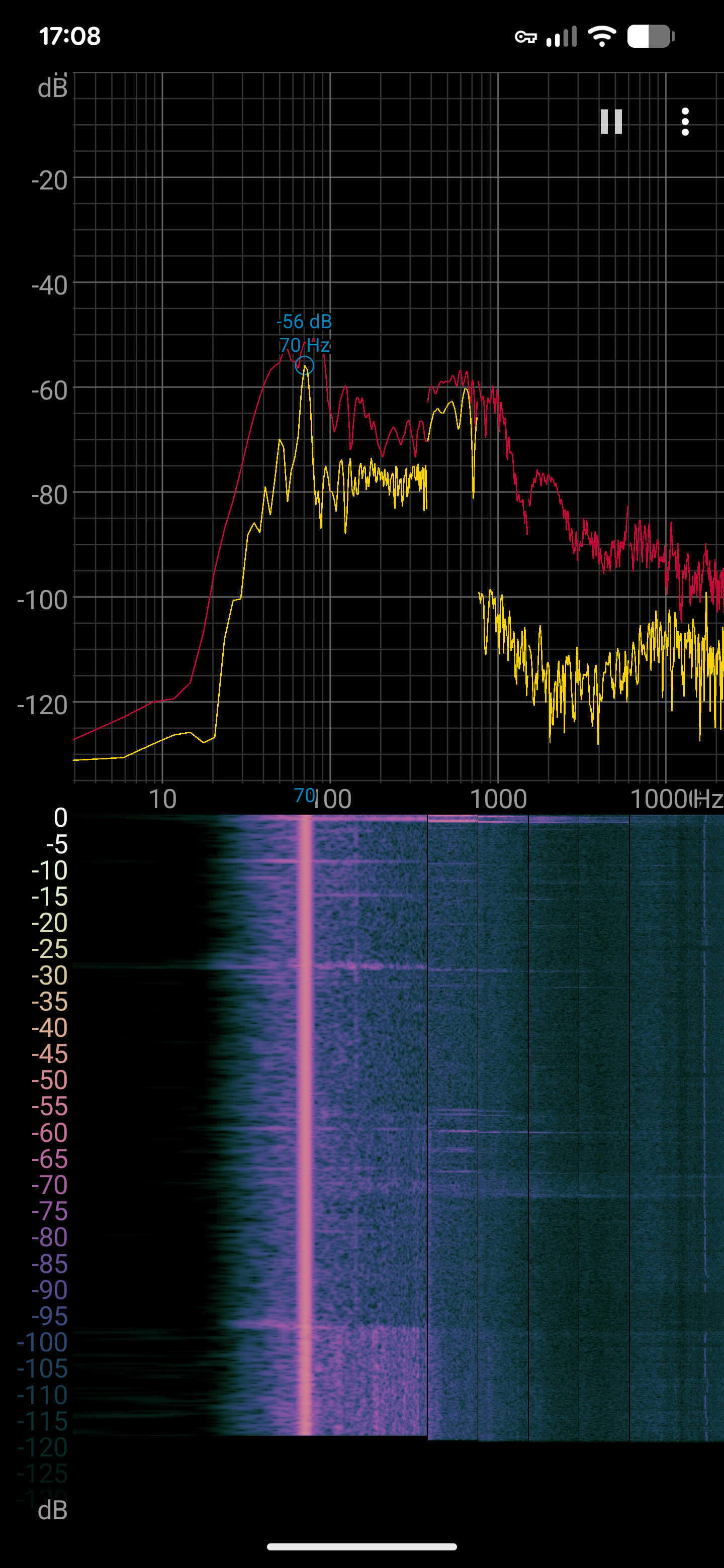

Use an android app that has an an acceleration spectrum graph (like phyphox) Don’t try to capture such noise with a microphone, it won’t work.
Just put your phone on any surface and capture the problem frequency and it’s resonances. You’ll then be able to see it easily and do so repeatably in an arbitrary magnitude (FFT) which you can compare.
Is that not this?..
Before
After
That’s an FFT, no? Why’s this not valid? It’s the same device. It looks like it works beautifully.
Totally valid and yes that’s the same.
I was just wondering why people were posting saying it’s hard to quantify.
Microphones in phones and RTA gear will have low pass filters that are unavoidable so any dB(A) measurement almost useless to track these down unless it’s unbelievably loud.
But will show up easily on an acceleration FFT.
What App is that from?
That’s an app I have on Android called Spectroid.
