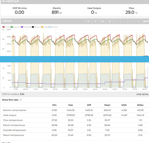

Time to display my ignorance and stupidity again!
I have been looking at some other heat pumps for a few minutes.
So my house might be good or bad in terms of heat loss and my radiators may be good or bad too.
But the heat going into my house is the heat it needs at the room temperature I have set.
My heat pump is achieving that room temperature.
So if my house needs 3.3kW of heat at this moment that is the same as any other house taking 3.3kW of heat.
Is that correct?
If so, my heat pump is is consuming 1kw of electricity to produce 3.3kW of heat why are some other similar sized heat pumps only consuming 500w to do the same job and why are some other similar sized heat pumps producing 6+kW of heat whilst using the same amount of electricity as mine?
Logically I come to the conclusion that my heat pump is either defective or badly designed?
I know this is stating the obvious but my heat pump is either consuming too much electricity for the heat produced or it is not producing enough heat for the electricity consumed, I can’t see any other explanation.
I have also taken account of my flow temperature, increasing it or lowering it makes no appreciable difference, if anything lower flow temperatures make it worse.
Is there any other plausible explanation?

And this is a Daikin 10.6kW Altherma 3 in Basingstoke.
Why would it be producing so much more heat than mine for less electricity, it’s essentially the same heat pump? Flow rate is the same, outside here is 3c warmer, my room temperature is 1c higher and my flow temperature is about 2c higher.
Is there any clue to monitoring issue here?
COP for 30 minutes is 4.73 which is more like where it should be but COP in window is only 3.68 for 27 minutes.
I see discrepencies between these two figures all the time now. I don’t recall seeing this for the first week of heating but for the last week I have been noticing this.
It may be something or maybe not?

Yes, the heat production seems erratic to me and it has some peaks and troughs in it that I would not expect to see.
The temperature sensor in the heat meter is pre installed and sealed.
The other temperature probe is in a pocket of a tee piece. It seat on a rubber o ring and it is either seated or leaking, there is no scope to get it wrong without leaks as far as I am aware and can see.
I am puzzled by it.
DHW was fine today, about a COP of 3.
It does seem to vary and there is sometimes this lump of electric use with no heat output that Marko and Vinny have commented on.
I seem to be unable to affect the heating COP much. Nothing I do with flow temperatures makes any difference.
It was looking better this morning but deteriorated after the DHW cycle.
COP was about 3.6 for heating this morning and later was only about 3.3.
The heat pump seems to be more efficient when pushed a bit harder, ticking over does not appear to be its thing.

It’s interesting to see that your 9kw unit seems to have the same minimum compressor power as my 10.6kw - about 920-950w.
You can adjust the flow temp overshoot number between 1 and 4 degrees - if it is now on 1 then increasing to 4 will decrease the cycling frequency and might increase the COP a bit.
It does look as though the radiator system is too small for the heat pump BUT that means you should be OK at sub zero temps when mine is struggling. Incidentally they did try to sell me a 16kW unit to start with - maybe they knew about the low temp performance drop off.
When I have a moment I’ll see if I can replicate your system on mine by shutting off a portion of my radiators.

Your system first hour on this morning, outside temp 11.5c
My system, first hour this morning, outside temp 9.5c. Similar room temps for both.
Compressors behaving identically the only puzzle is why yours switched off after 50 mins. The flow temp you are recording might not be the same as what the Daikin is reading? I say this only because the flow temp was not continuously going up when it switched off…
Here is the same data for my unit but taken locally and I have added the Daikin Flow and return temps which match closely with the probes I installed (double lines). It also shows the pump speed green lines which yours is probably mirroring.
My house is 230m2 vs 120 m2 so this rings true for 10.6kw vs 9kw heat pumps
