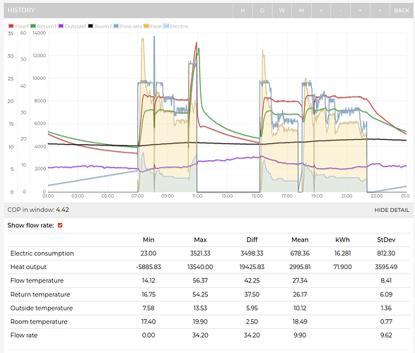

Zooming in on October 24th:
A:
C:
Are those overnight runs for C both DHW or is one a space heating blast? If DHW why two runs finishing at different target temperatures?
The cycling at minimum modulation & low flow temp seem to be hurting cop between 11:00 and 15:00, perhaps trying to run for a longer period there at a slightly higher flow temp and higher modulation might give better performance?

I have noticed in the last couple of days that I am getting a massive spike in heat production, nearly 19kW of heat, at the end of the DHW cycle. Then I hear some nose in the radiator I am sitting next to and the radiator gets really hot at the top for a minute or so.
I wonder if heat pump is performing just fine but there may be an issue with the heat metering. The temperatures are rising and heating up the tank in a reasonable time, but the readings seem a little noisier than I’d expect.
How are the temperature sensors connected to the pipes?
Where are the temperature sensors connected?
Where is the flow meter installed in relation to the pipework?
Do you have any other measurements, like tank temperature?

I see the COP for the last 30 minutes at the top left of the window drop to something unbelievable but when I isolate that 30 minutes I see a realistic COP, something like 1.2 for 30 minutes but 3.8 for COP in window.
I have been thinking about blocked filters, they were cleaned in July three weeks after the install but I would have expected to see flow rate problems?
What temperature is the tank heating from? COP is best when tank starts from cold. Need to be wary of starting temps when comparing DHW runs, as they may not be as equivalent as you think.
The start of today’s run @ 14:10, the return goes way higher than flow, suggesting that it was taking (borrowing) heat from the cylinder before the heat pump started up. The measured heat is negative for the first couple minutes as a result.
This morning’s DHW cycle @ 8:20 faired much better, yielding a COP of 3.94, which is pretty decent, though mostly thanks the slug of free heat at the end (though that may have gone to your radiators). Even the middle section averages a COP of 3, which is still good. I’d guess that the tank was colder this time.
That second DHW reheat in the afternoon was probably unnecessary, and could have been skipped entirely. Try increasing the threshold for how much the tank temperature can drop before it will reheat it (I’ve mine set to 20 degrees).
