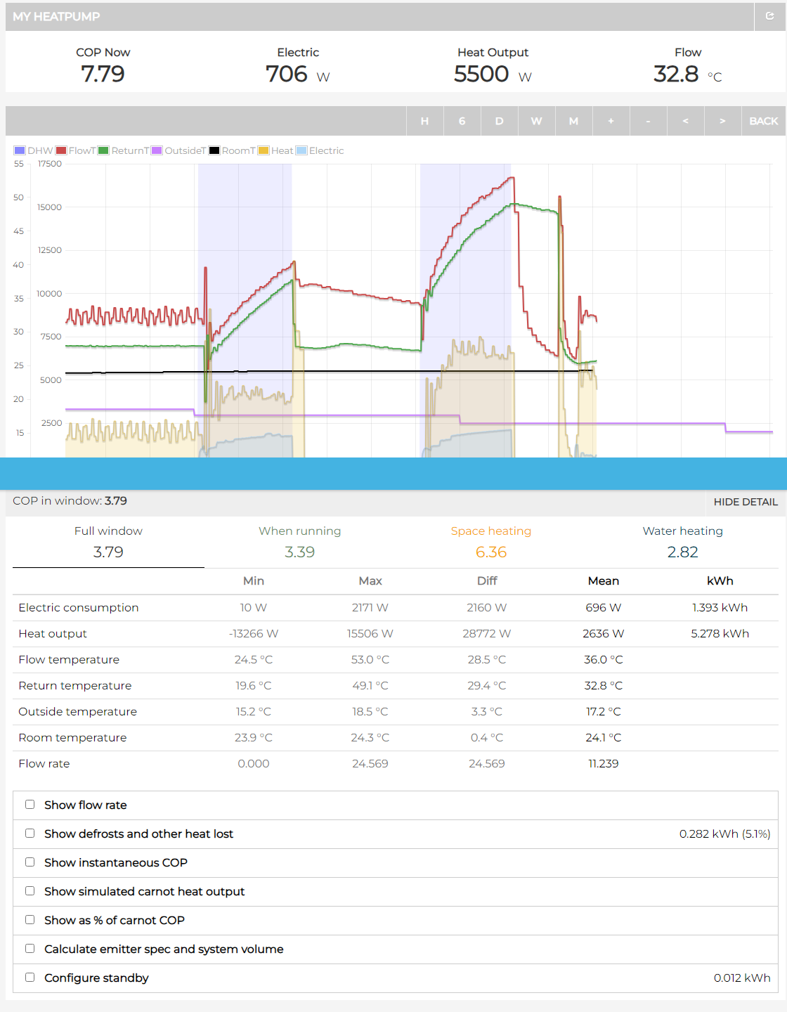

Something has gone quite wrong with my 8kW Daikin today!
Hi Tim,
I am no expert either, so it could be.
Octopus fit an automatic bypass valve.
I have this completely shut.
Maybe it is failing.
Could this give the results I am seeing?
Anything flowing through the abv goes through my heat meter but maybe if water is flowing through it, then the heat pump is consuming electricity but just not heating anything.
If water was going through ABV, then you’d have a short-circuit in your primary loop. Flow temperature would rise quickly, and heatpump would cycle like mad. I don’t think that’s happening here.
Then it can only be the heat pump.

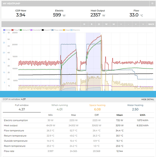

The DHW cycle went wrong again today so I stopped it. When I restarted it a few minutes later it is normal again.
It’s weird.
I have contacted Octopus again.
I am writing here just so that if anybody else has the issue there will be somewhere to look.

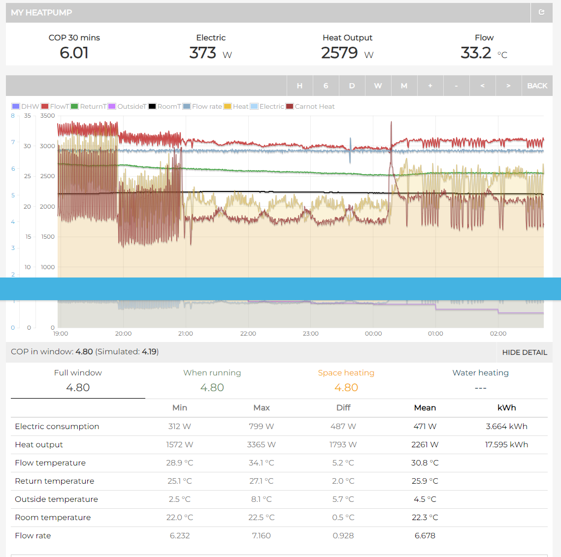

I cannot think what is causing this, if anybody has any ideas I would love to hear them. This can’t be right. This is 03 October 2024.
It’s curious to see in that last run there’s a change in behaviour at 15:30 when both the dT and the slope of the temperatures go up inline with the increased heat output. Hard to see how that could be result of an “inaccurate heat meter”.

Hi Matt, sorry, not been on the ball with your one. Its really odd. I assume that flat line is the flow rate? well… surely the inaccuracies we see with meters is due to inaccurate flowrate sensing. Yours looks spot on. As you say Ken, The heat meter looks OK. we are seeing here a roughly constant input power, and constant flowrate. then we see the dt widen for the last 5-10 minutes.

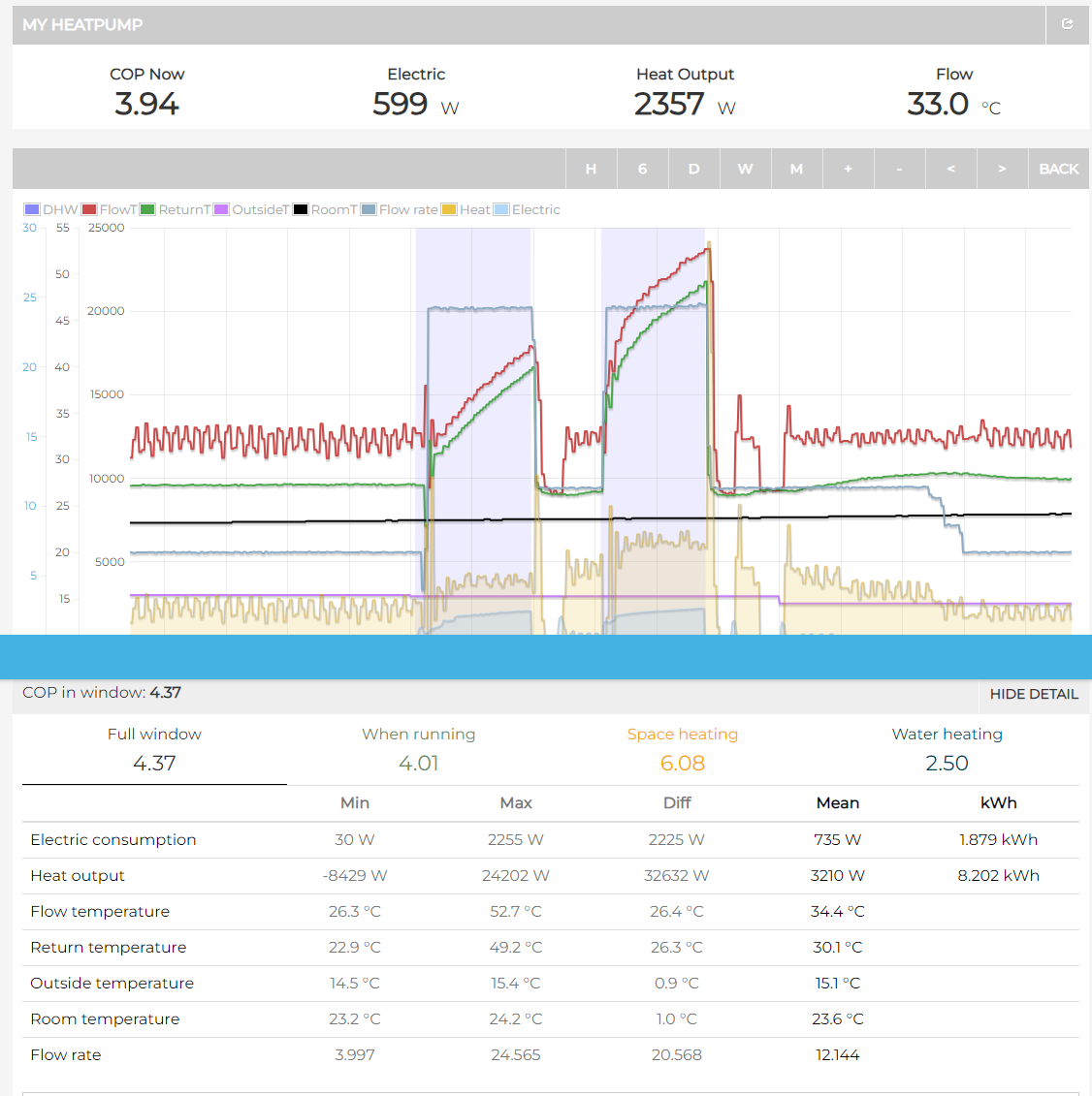

Here’s a link to the DHW cycle on Oct 3rd: https://emoncms.org/app/view?name=MyHeatpump&readkey=bbd1cd04728bd8c9f7acfb2ee51936d2&mode=power&start=1727963370&end=1727967590&flow=1&carnot=0.5
And October 9th: https://emoncms.org/app/view?name=MyHeatpump&readkey=bbd1cd04728bd8c9f7acfb2ee51936d2&mode=power&start=1728481780&end=1728485410&flow=1&carnot=0.5

@johncantor Yes, the blue straight line is the flow rate, steady at 24lpm as normal. I never see any issues here.
I also have the simulated carnot heat output showing on the graph here.
My flow and return temperatures do converge and meet perfectly every time the compressor is off
I see no issues with the heat meter and I am confident that the electricity meter is recording correctly as it corresponds to other data from my solar inverter.
I think my data is accurate.

There is no change in pipework or lagging. I would think the heat meter would still pick up any heat lost though?

I first noticed the issue on 14 September 2024 with space heating, loads of electricity and not much heat. The graph is at the top of the page.

The issue when running DHW is odd and intermittent but when it goes wrong it seems to follow the same pattern, something seems to `release’ as the flow temperature builds and I if I notice the problem I can correct it by ending the DHW cycle and restarting it.

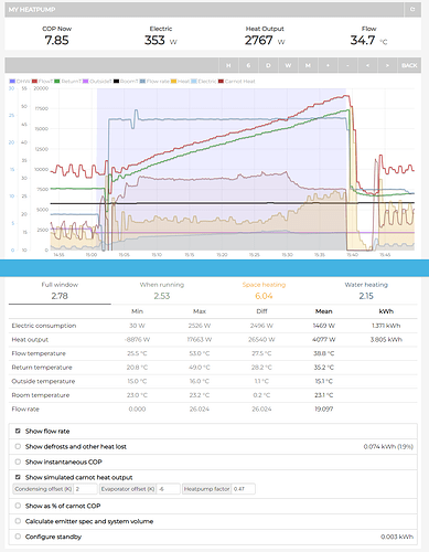

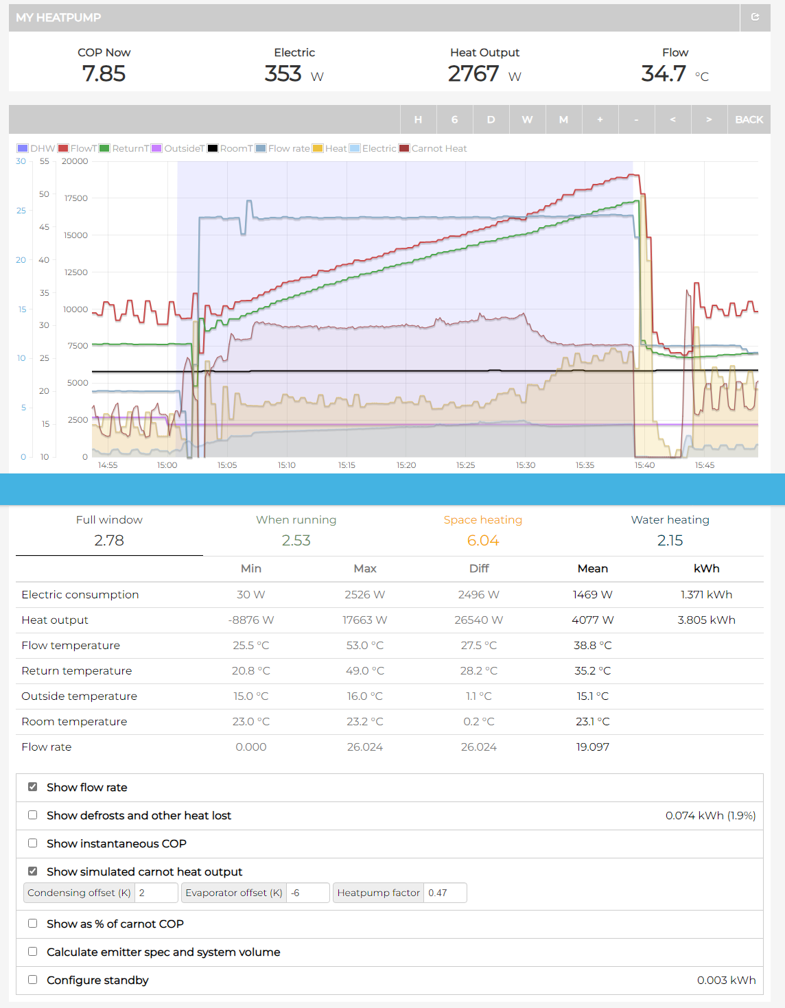

This is the evening of 10/11 October that John mentions. At this time the flow temperature was set at 32c but I see a steady decline in the flow temperature. I see this quite often and don’t really know why it happens. These particular Daikin heat pump all seem to have an erratic flow temperature, it is rarely steady.
It could be the expansion valve (eev) sometimes opening too much. It could be a sensor as part of eev control. It’s unusual, so I’m not sure it’s your prob. When the output ‘dips’ due to liquid entering compressor, the discharge temperature drops to about the same as the water flow temperature… This is not good. The suction sensor will probably tell us nothing unless very accurate… Actually, it might be better to fit it after expansion valve. I have seen similar expansion valve issues with my 6kw ecodan. I could show you similar ‘crashes’ in output

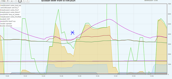

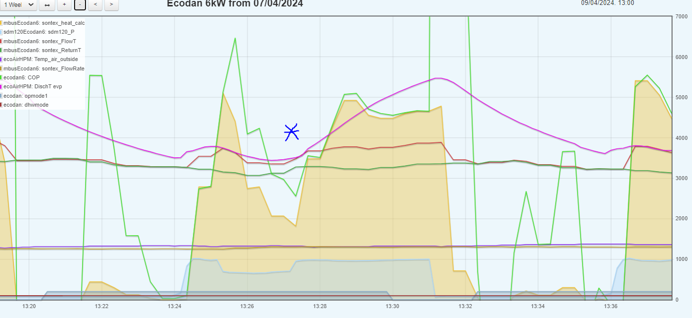

in the past, liquid entering a compressor was very bad and detrimantal, however, new designs apparently will cope with liquid. (there is a good mitsubishi video somewhere). My ecodan has definately had liquid entering the compressor
you can dee here a ‘dip’ similar to yours. the dip coincides with a low dicharge temperature (purple). normally the discharge is superheated by at least 20 degrees above water outlet temperature. see how green COP also dips at this time
