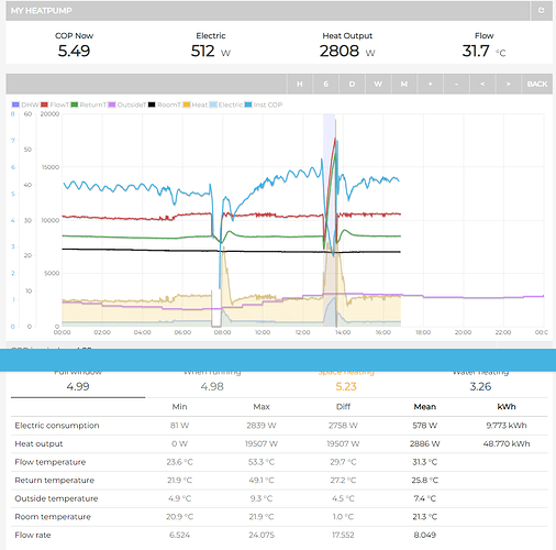

Something has gone quite wrong with my 8kW Daikin today!
I have the 6kw unit as well and I have seen something similar to this a few times.
I think that the compressor stops because the LWT target is exceeded. In this circumstance the circulating pump stays on and the water circulates until it cools down enough that the compressor decides to turn back on.
The LWT rising and then the compressor stopping and then restarting all makes sense. The question is why does the unit increase the power to the compressor all of sudden, without obvious reason. The few times I have managed to look at the MMI while it is happening the LWT target (based on WD curve + Madoka) is unchanged, there is just an increase in compressor power, heat is produced, and the LWT quickly overshoots.
No, it is quite different. The input power increases and the output power increases in what looks like lockstep. It could be related in that it is an obvious step change in behaviour following steady-state running, without obvious cause or rationale. So perhaps a result of the control logic either getting it wrong or attempting to achieve something that is not obvious to us.

I’ve been looking at this in more detail, and it is more similar to @matt-drummer’s situation than I first thought.
16 Dec 2024
The rise in temperature is preceded by a drop in LWT. At about 18:47 the LWT begins to drop, with a falling heat output against slightly rising input power. At 18:56 the input power begins to rise dramatically and this raises the LWT again. During this time the flow rate is steady.
The section between 18:47 and 18:56 is similar to the unexplained drop in heating output that @matt-drummer is experiencing. @Chris_Hill system appears to be responding to it in a different way though and the drop in performance is more steady rather than falling off a cliff.
