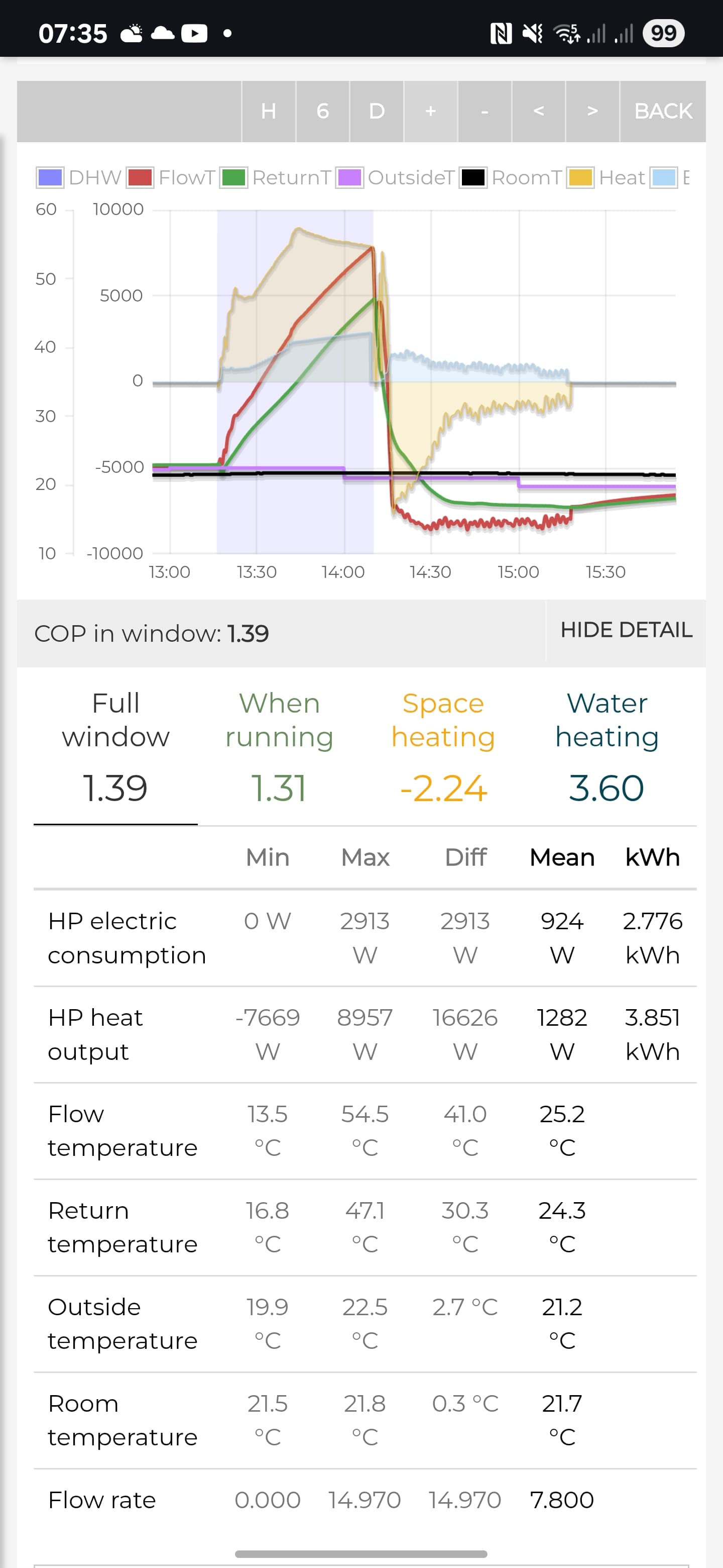

This is what I mean: the system was set to cooling the entire time and there was nominally never any heating. Those initial spikes must be some transient effect that I don’t entirely understand, but they reduce cooling COP, and rightfully so at it first heats the house and then cools it.
The conditions to auto detect cooling are:
  • kWh cooling must be greater than kWh heating in the data window (a day for daily data).
  • Cooling must be active for more than 5 minutes in a single period. The start of the cooling flag will align to the start of that 5+ minute period and will coincide with the first negative heat
It will therefore not include a positive heat peaks in the cooling periods …

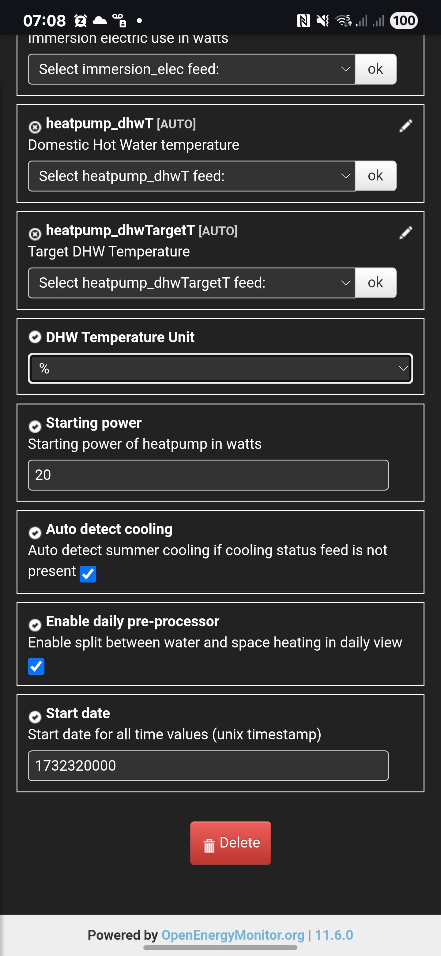

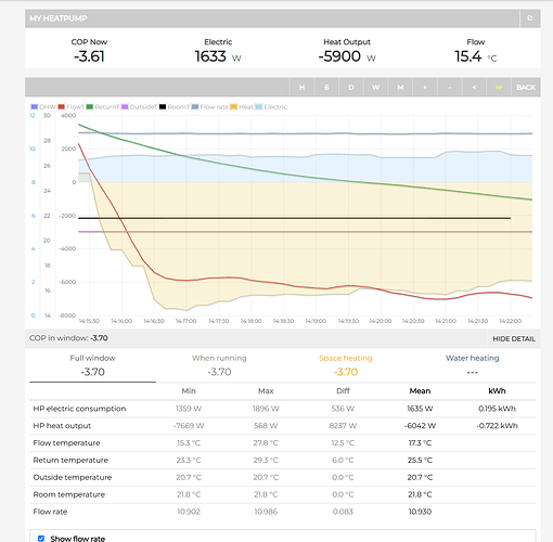

Hi, does anyone (… @TrystanLea ) know how I can get cooling to show on mine?
This is the 2nd time I’ve used my heat pump in cooling mode and it didn’t show either time.
Either you supply a feed to the app that indicates cooling is active or you tick the box to automatically determine whetger cooling is active in the app config.
I suspect I can’t get to the app config, my Installer ordered the kit so it’s set up on his account. He’s since gone out of business.
Edit: @Andre_K nevermind, i found the app config. Auto detect is already selected.
Is anyone able to offer any support? With the heat wave coming, I want to be able to use cooling without it tanking my SCOP.

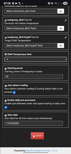

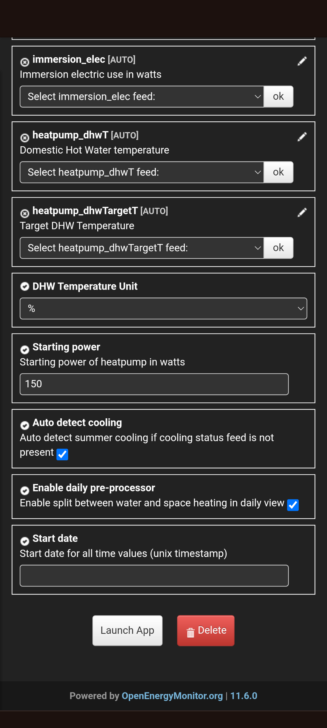

Can you show your app config screenshot?
@Andre_K

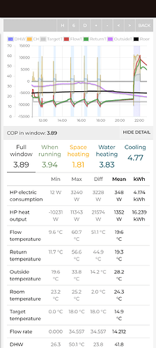

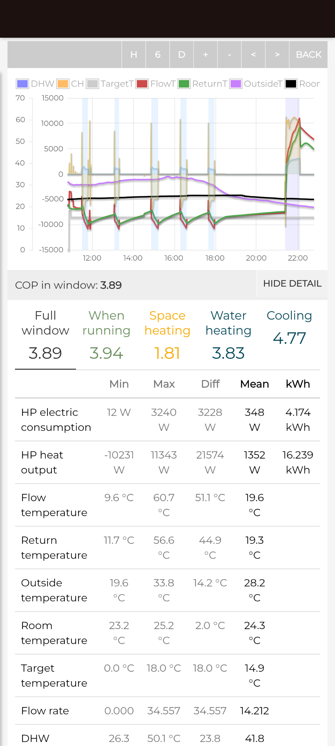

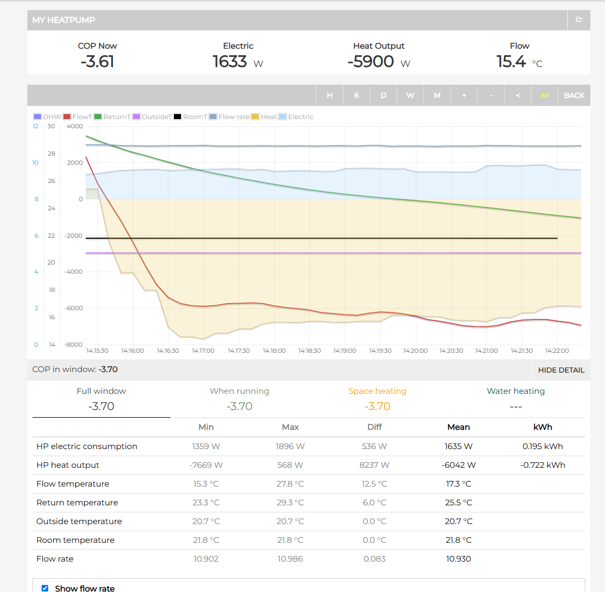

Can you show a more zoomed out view showing cooling and possibly a DHW cycle as such?
@Andre_K
Weird. Is this synced to emoncms.org and published? If so, could you please send a link to the public app so I can help debug?
The graphs shown above are from 12th June.

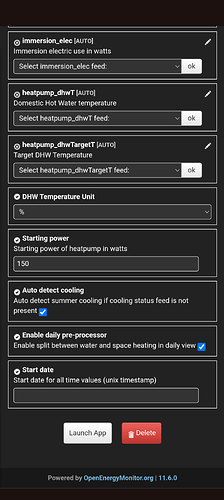

For some reason, the cooling auto detect appears as disabled in your app (config.app.auto_detect_cooling.value evaluates to false in the JS console). Can you go back to the app config, untick the autodetect, click the “Launch app” button within the config screen, then go back to the config, tick it and launch the app again?
I can’t see the “Launch app” button. Am I missing something? I might be doing something stupid.
For me it’s right at the bottom of the config.
Try the following step-by-step. Go to emoncms.org, log in if you aren’t already. Select the app from the sidebar to have it open, click the wrench icon in the top right. You should be seeing the configuration along with the Launch app button. If not, then I’m at a loss :sweat_smile:.
