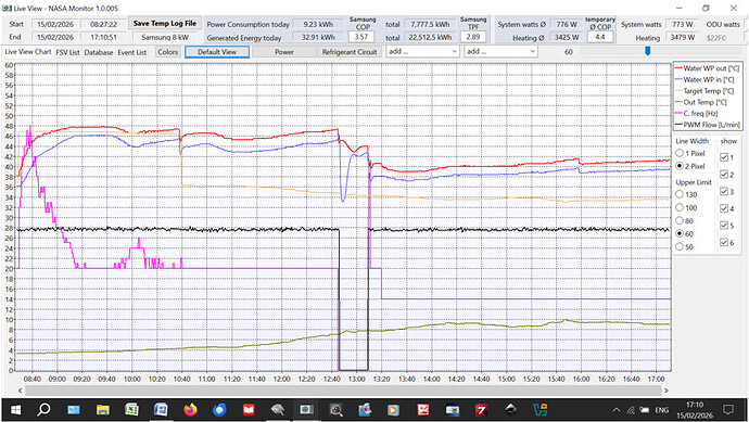

I wouldn’t claim to operate a minimum running cost setup, but have a look at a typical day’s monitoring output:
As you can see, I force the compressor to (pretty constant) minimum speed (magenta line), where it stays for hours at a time. I had #2091 set to 1 and allowed LWT to find it’s own level. I set WL down by 10degC at 10:40 after post-setback house rewarming was complete. The roomstat was finally satisfied at about 12:45, and switched the compressor off for about half an hour until hysteresis kicked it back in. The new lower minimum inverter speed of 14Hz roughly matched house heat loss so the compressor ran interupted until evening. No PWM as you can see from the black line.
So it may not be the most efficient HP on the market, but I’m quite glad I went with Samsung…

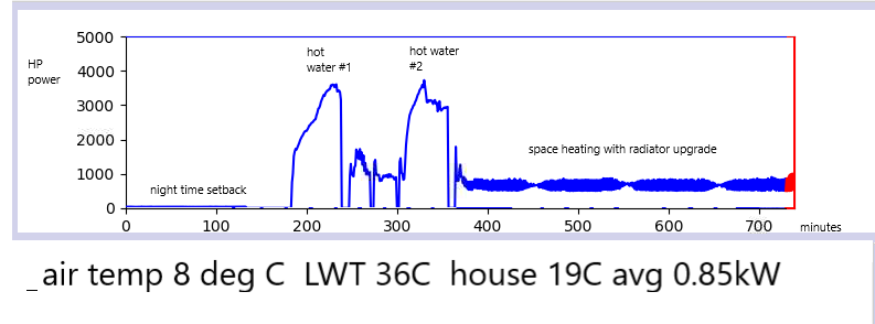

The latest firmware resolves the LWT modulation so that it will vary by upto 3 degC based on the MIM room thermostat giving a constant temperature without on/off compressor cycling. ( yes really! see below )
I have experimented with increasing radiator size and found it improves performance but you can run it at higher temperatures if you are stuck with small emitters.

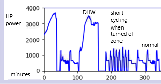

The above short cycling I can reproduce by when accidentally allowing the upstairs zone to shut off on a thermostat - it does warn about this - I now keep all zones fully open so that the volume and heat load is constant.
see above - rapid short cycling every 5 minutes when the zone closed resumed normal cycling when opened
I doubled the radiator sizes in the downstairs rooms and you can see the effect here. The compressor load is more or less constant and more efficient like this. very satisfying.
