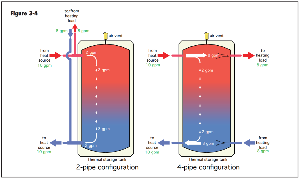

A tank plumbed in with two pipes acts as a “volumiser” to add capacity
Some folks plumb them in with 4 pipes as a “buffer” though which can, if not managed correctly, cause chaos.
It is also possible that the volume in the existing system is not being utilised effectively. If too much flow is “bypassing” through one radiator (or an auto bypass valve) then although there may be 100 litres in the system you might only “effectively” be heating the 20 litres that is short circuiting through an imbalanced radiator or an auto bypass valve.

Just stumbled upon this. Which setup you think is better ? Do you think it needs some additioal pump or I will conect it between outlet and return pipes and that’s it ? I have PWM pump installed on outlet.
Edit 2:

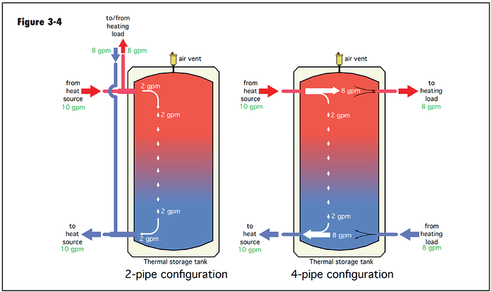

So found this, which configuration do you think is better for me ?
DO NOT install a 4-pipe buffer. You will only make things worse.
You probably DO want a 2-pipe volumiser in series because the heat pump is so large compared to the heat load for the house.
Install as shown the first option here:

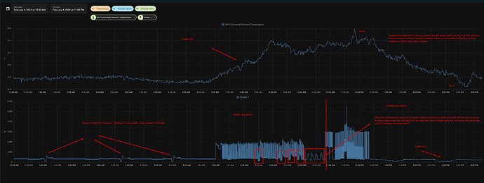

But look at this graph. You can see the issue with cycling in water law mode… Simply for some unknown reason this pump stops only for 3 minutes - aways. I think this is defined a minimum time the pump needs to stop. Seems my temperature in system decrease from 35C water temperature to like 32 in these 3 minutes so pump decide to start. I’ve switched to temp control and from 11 to 16 the temperature dropped only by 0.9C so the pump is still not running. Now it will start soon and continue until the target temp is achieved again. So I guess low heating performance of radiators together with small amount of water in a system. SO do you think this buffer tank could help here? I guess so, however, question is to what degree.
Why wouldn’t the heat pump start again as soon as it was able to?
You have asked it to flow water continuously at 35c
It stops when it can no longer do it and then starts again as soon as it is able to.
It is exactly what you are asking it to do.
I don’t understand why you expect it to wait?
It doesn’t know that your house is hot enough, it doesn’t know that it is producing more heat than your house/radiators can cope with.
How long do you think it should wait?
What you think is the correct time might not be the correct time for another owner.
As far as I can see the heat pump is doing exactly what you have asked it to and Samsung have ensured that you have to wait no longer than absolutely necessary for their product to continue to do what you have asked.
If you want it to do something else then you do it with the room temperature controller.
