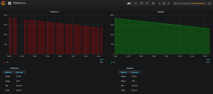

Still getting dropouts…
Edit - Caused by using the sleep() command to run the loop.
After I switched to APS, which gives me a true 5 second cycle time, the dropouts disappeared.
I don’t know how you have things set up behind grafana, but It would seem the issue is much like that seen with PHPfina based graphing. The fixed intervals do not work well with anything but data input at the correct intervals.
The use of “sleep(5)” will have made sure your loops were definitely not 5 secs due to the additional “runtime” of the loop.
I had included “timestamp.py” and it was imported into the example script I showed you. Using that is extremely lightweight but it not only ensures that the time taken by each loop iteration is exactly 5s (for example), but also that each of the 5s loops are starting at a syncronised time.
The phpfina feed’s “timeslots” all relate directly to the feeds unix start time, each “slot” is anchored to an exact point in time, which is why there are so many posting and querying irregularities.
What a phpfina timestamp really says is that this value arrived at some point between the declared timestamp and (timestamp + fixed interval + 0.999), that’s a 120% margin of error on a 5s interval.
Using the method I use, all data is always supplied in total sync, when I say total, I mean in all aspects with a acceptable level of flex, not that the loops are exactly timed to a atomic level.
If the device is off line (eg power cut, firmware update etc) when it resumes the loops will still be in sync with the data prior to the outage, as if the outage( and restartup) itself was an exact multiple of the loop iteration. And, because of the way it’s done it will also match the loops of other devices.
The one function “if ready():” does both the idle loop speed by implementing a sleep (as a percentage of the desired loop time) and the check to allow the timed code (talk to pzems here) to run.

Timestamped:1532513650.0        Actual:1532513650.07    Diff:69.0mS     (min:1.0,max:500.0,avg:251.1)
Timestamped:1532513655.0        Actual:1532513655.07    Diff:72.0mS     (min:1.0,max:500.0,avg:250.6)
Timestamped:1532513660.0        Actual:1532513660.08    Diff:77.0mS     (min:1.0,max:500.0,avg:250.1)
Timestamped:1532513665.0        Actual:1532513665.08    Diff:82.0mS     (min:1.0,max:500.0,avg:249.6)
Timestamped:1532513670.0        Actual:1532513670.09    Diff:87.0mS     (min:1.0,max:500.0,avg:249.1)
over half an hour it averages 0.25 secs “accuracy” of reading the registers, but note the timestamp submitted is always an exact multiple of 5.
