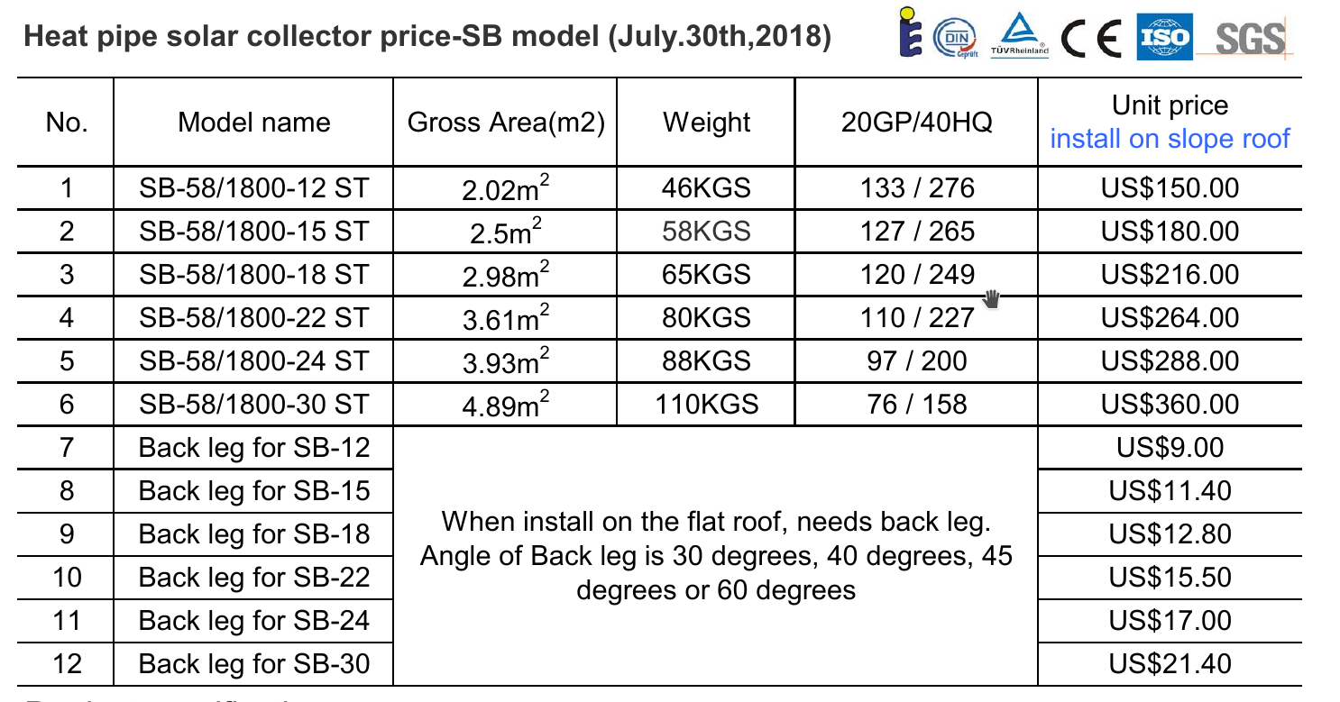

stephen
(stephen krywenko)
38
no worries-- But I think your market is over charging on the wet “HWS” as in Canada or in my province specifically --provincial approved system and vendor installed with out rebate are only 2.5k…Anode issue — are not your tanks glass lined??. now alot of them are carbonfiber/fiberglass. and if you use good fitting and PEX you’re good for +25years ( I believe my current hot water tank is something like +30 maybe 40 years old as bought it used to build my hybrid heating system ( will out live the 0.4mm evacs systems as the heat transfer pipe has about + 15 year lifespan— I suggest “wet-HWS"when ordering get the 0.8mm heat transfer pipe they are slightly less efficient but will last practically forever as they do not suffer expansion fatigue as the <=0.4mm will that where you get the premature failure from. if you have the <=0.4mm heat transfer pipe you can extend the lifespan indefinitely by buying 304 stainless steel tubing cut to 4 - 6” length and insert them on the tip of the heat transfer pipe… I being working with, installing evac tubes and importing systems in Canada since 2005… I ran into probably every type of install usage issue there is - the only maintenance i ever had personally is changing pump ( but I was experimenting with different pump types - the best pump is a wobble pump but it very difficult to fine them- very low power with positive displacement ), adding antifreeze or change a gas tube as someone shot one on my house from a stray bullet oh yeah and exploding heat transfer pipe but my climate way to cold for 0.4mm the manufacture replaced them all for free - 300lbs of 0.8mm heat transfer pipes as they sent me the wrong ones – these guys make really nice ones at a good price Bluesun Solar Energy Tech. Co., Ltd also provide 0.8mm tubing ~$230 with roof mounts and reflectors 18 tube 1800mm unit $288 for a 24
yeah Australia going to be hit hard by climate change-- your own government estimates put your temp rise at between 4-6 c by the end of the century( that was 5- 7 years ago - today i suspect it much higher then that estimate )
but any ways have a great day
ps here a picture of my last quote from them
