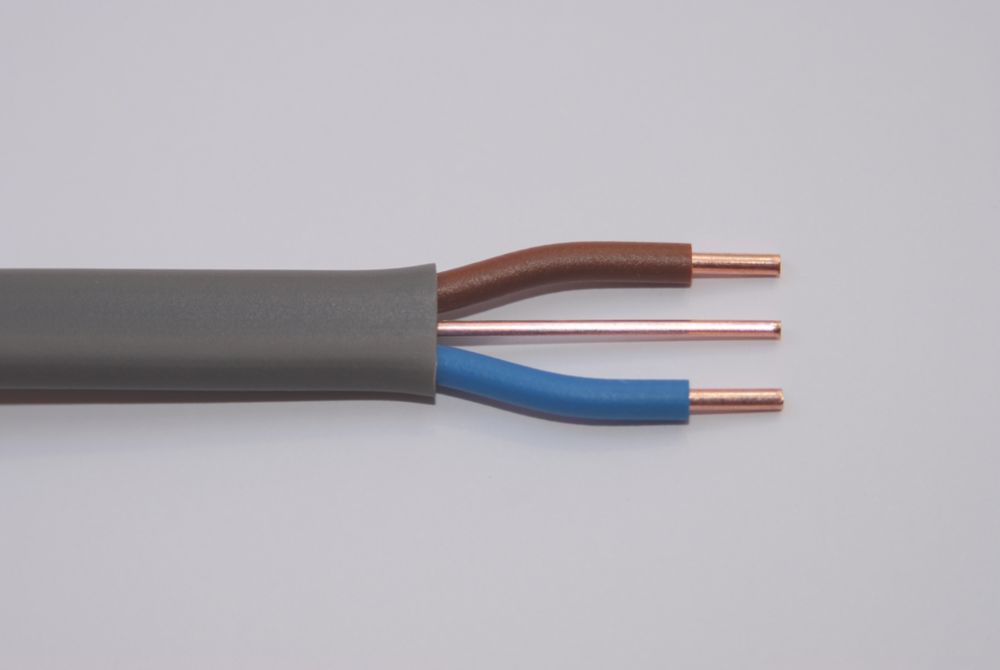

I’ve measured a few different pieces of our 6242Y 2.5 mm2 (this is the flat/oval type of cable used in the UK - picture below), and the width varied from 10.0 mm to 10.3 mm.
(Not that you’d put a c.t. on that - it won’t work!)
