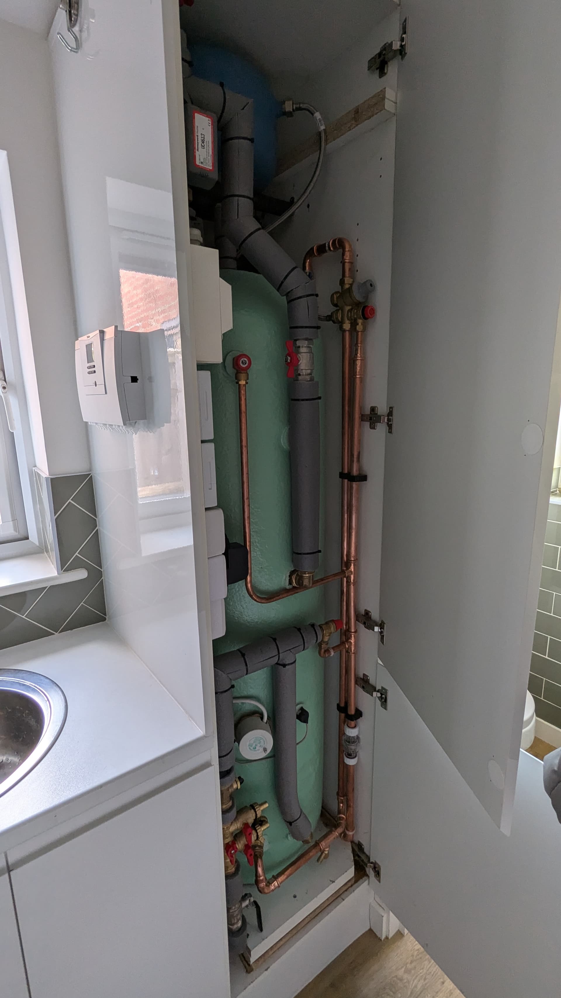

I had a heat loss survey done last week, and it turns out that I can get away with a 3.5kW Vaillant. Probably only space for a 120L, maybe 130L, tank in the cupboard, but as it’s usually just me that should be fine. Looking to get a green 0% mortgage to fund both the heatpump and some extra battery storage being installed in the summer.

In the end 0% additional borrowing from Nationwide let me bring my plans forward, so this past week I had a heat pump installed and next week the house battery capacity is being increased. Then just waiting on Octopus to take the gas meter out. :+1:t2:

Congratulations! :partying_face:
That looks like a good installation, what installer did you go with?
Very nice, congrats :clap:
