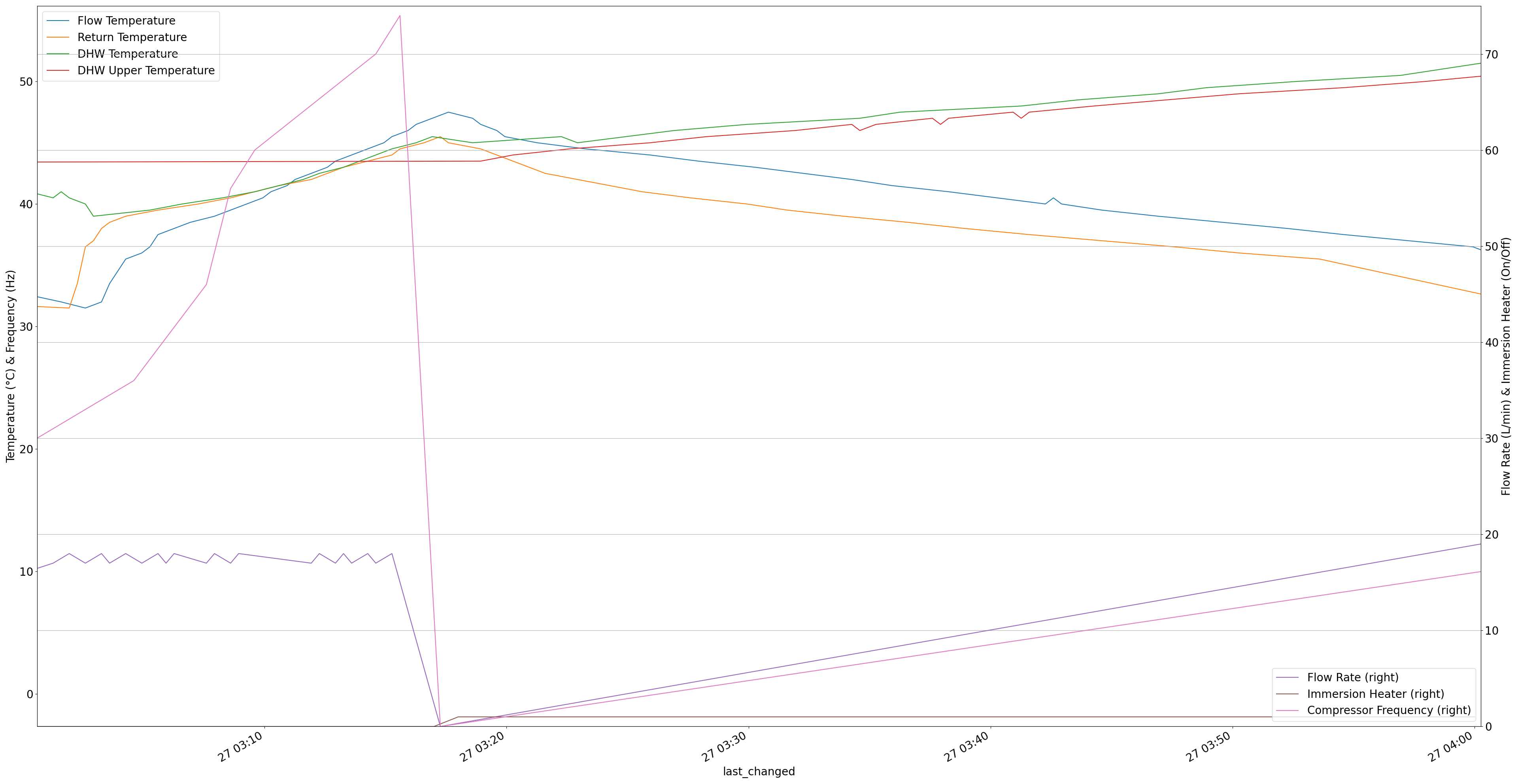

Still getting low COPs, some yesterday DHW COPs from the MQTT Bridge as low as 1.3, highest 2.16, averaging 1.64.

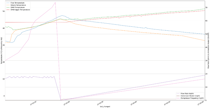

First Legionella with Bridge attached from last night, started 0300, heated with pump until approximately 0317, flow temp reached 47.5 C going up from approximately 32 C. Immersion switched on for approximately 43 minutes until 0400 where the DHW temperature reached 51.5 C, Ecodan yesterday DHW COP of 0.87!
Ordered thermal paste, insulation and power monitoring, surprised at how poorly it is performing.
Heating COPs from the Ecodan numbers are averaging 2.57 with sub 40 flow temps and generally mild outside temperatures.
Flow rate and Compressor lines going up to the right is just continuity of data, next values are post 0400 when heating kicks in. DHW is in Eco, both pumps are on 4 setting in FTC controller, Quiet mode enabled.

The actual performance of the Ecodan is likely to be not nearly as bad as it looks here, which should improve as soon as those thermal sensors get fitted properly.

If the immersion heater size is set in the service menu then it shouldn’t drop below 1.0
Is auto adapt minimum flow temperature reduced to 25 in the service menu too or the default (35 I think)?
Any way to double check the calibration of the flow and return sensors?
SD card fitted and showing healthy for the AA data?
I assume if it’s running at 20-25Hz on heating then computed input power will be around 0.55kW and it’s the delivered heat meaning the low CoP
