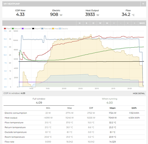

Some strange behaviour today and the DHW was relatively awful and the dip in flow temperature is very pronounced at times, at one point it wanted to run at 32c
This is the run with the pump speed limited to 60%, it would have been good if it had kept going but I think the Madoka shut it down, too much heat produced for the house.
I don’t think the Madoka suits my house with this heat pump, it is trying to do things the house cannot cope with.
Although my radiators can cope with the low flow temperature and deliver most of the heat available I think the Madoka is expecting the house to take longer to heat up. As the house is too small for the heat pump and the heat produced I think it messes it up.

If you look at the run it produced 4,500w of heat in just over 30 minutes, I guess the Madoka thought that was enough and shut down even though it had only got to 22.5c with 22.0c as the set temperature.
I have not found any way to control when the heating turns on and off with the Madoka, it seems to be hard coded at times, but then at other times not, I don’t know.
If I could control more I think I could get it to work better, I need control of the flow rate, the flow temperature and the points at which heating starts and stops.
I don’t think I have enough control though so I am stuck with the programming devised by Daikin which is I would say is for a house with different properties to mine.
I’m at a bit of a loss with it, I can get average performance generally or I can get it working really well but have to open doors and windows.
I always come back to the same issue of the minimum output, or more correctly, the minimum input being too much for a house this size.
