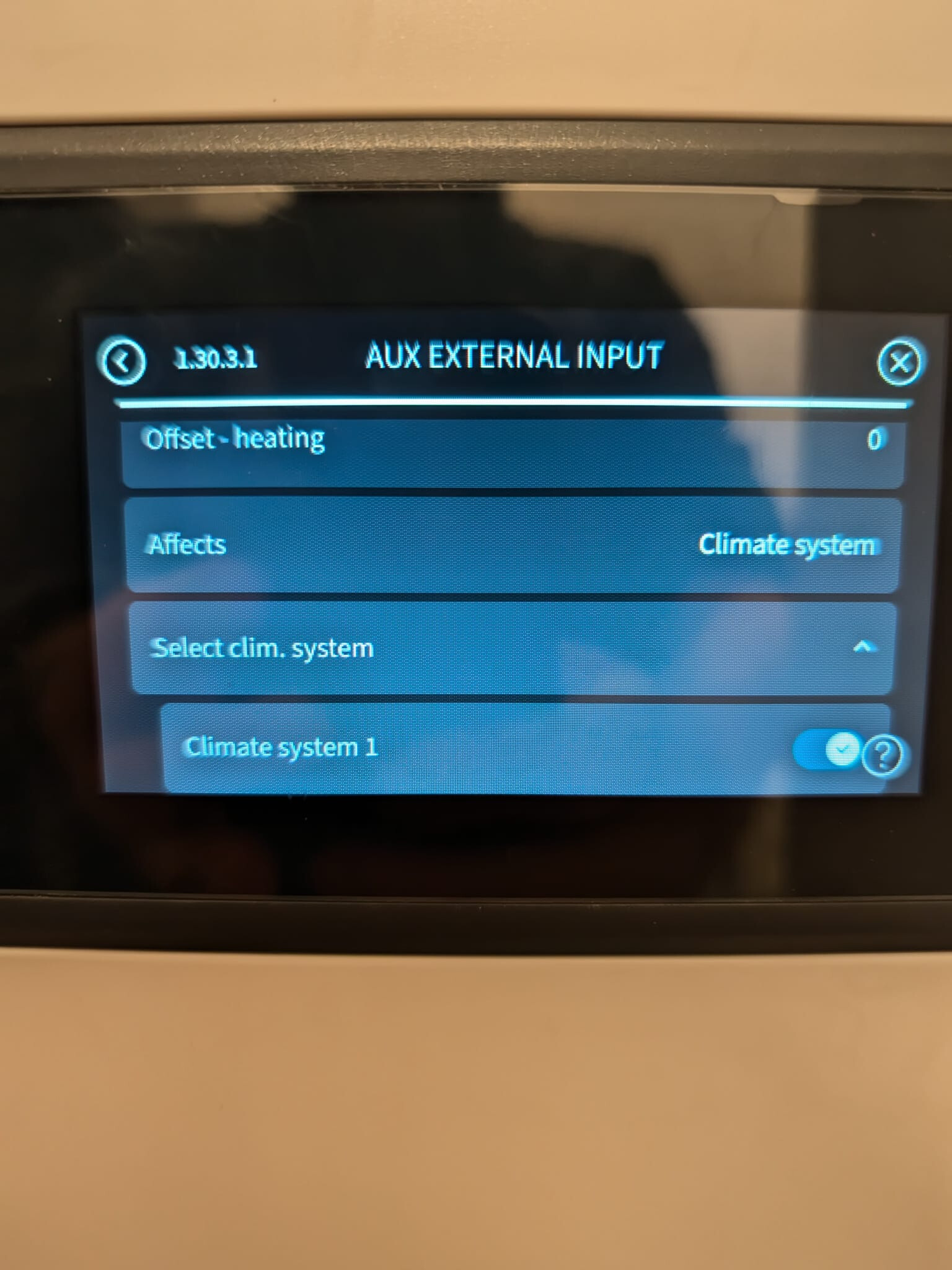

So, my “haunted Nibe” has Menu 1.30.3 ( External Adjustment ) :

It looks from here the external sensor is influencing it as it is checked, I doubt it will help but maybe try disable and report back if S1 changes

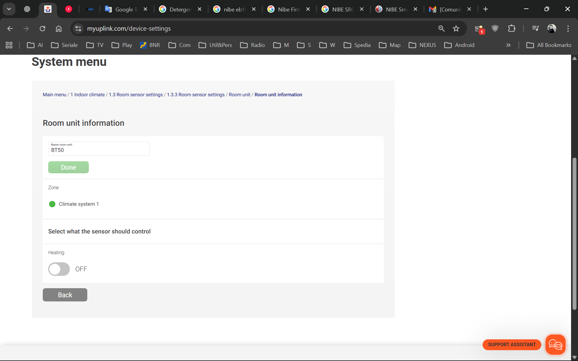

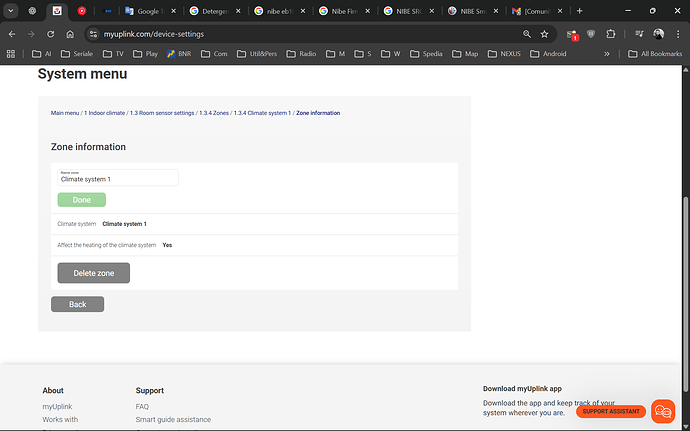

After resetting the DM, S1 remained targeted at 45. I followed your recommendation and disabled the external sensor influence and set my own curve. A few days ago I disabled the BT50 influence in menu 1.3.3, but today I noticed that menu 1.3.4 (Zones) has the setting "Climate systemClimate system 1
Affect the heating of the climate system : Yes
and the disable button is locked on ON (on the SMO S40 screen). I’m waiting to see what happens… As for the “technician’s theory” I think he wanted to “keep me busy” to have time to think or time for other work he has. For now I won’t buy a voltage stabilizer, I’ll install a relay that monitors the current parameters.

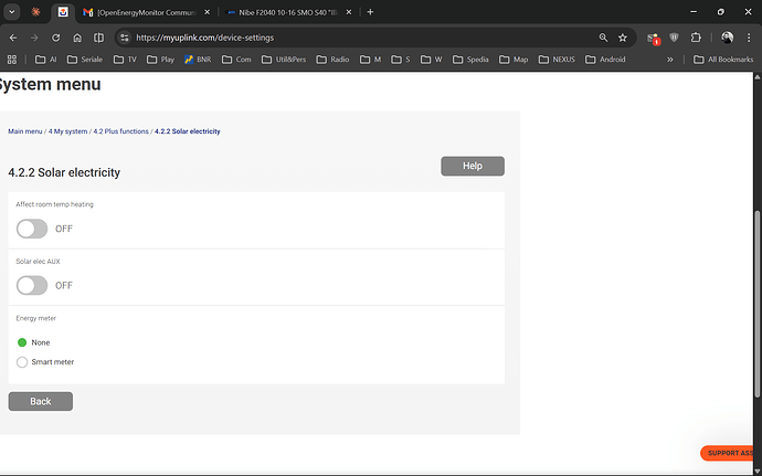

The problem started in Dec. 2025 when I found out from the website of the local company authorized by Nibe that through the Modbus protocol you can set up a collaboration between Nibe and Fronius. The idea of ​​testing this connection was that during the winter period I would set a time interval in which the production of the panels would (super)heat the water in the water tank to be used in the installation later. This is the concept that seemed interesting to me at the time. I made the Modbus connection, the devices were seen on the network, settings appeared in the dedicated menus of Nibe 4.2 Plus functions
4.2.2 Solar electricity

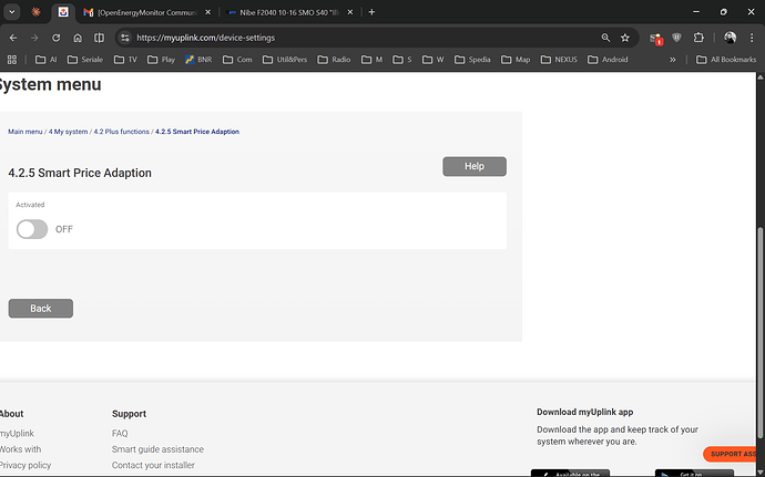

4.2.5 Smart Price Adaption
After a few days I realized that these settings need to be investigated more deeply to understand how they work, so I disabled all the settings in 4.2.5 Smart Price Adaption (in this menu the period of the day and the lowest tariff of the day were defined) but I left Modbus active and the monitoring of the current produced by Fronius through his SmartMeter. Now, I can only deduce that the deactivation of the settings although the sliders were clearly set to the deactivated position, the physical deactivation did not take place! Anyway, it remains in my analysis and that of the Nibe representative. It is a strangeness that persisted for approx. 4 months during which the Nibe representative performed 2 factory resets of the system. I’m still trying to “digest” what happened and for now I only have assumptions in my head. In time I hope to clarify them together with the man from Nibe.
