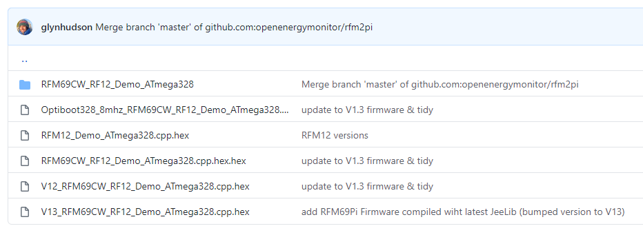

That link is what is in GitHub for updating an RFM12Pi according to the update script (as posted).
The point is, what is the radio module itself? I understand in the early days, for the emonBase using Martin Harizanov’s “RFM12B Raspberry Pi expansion”, RFM12Bs were used, then replaced by the RFM69CW. And then the “RFM12B Raspberry Pi expansion” itself was replaced by the"RFM69Pi RaspberryPi RF expansion".
As far as I know, the emonPi has only ever had the RFM69CW.
I thought the 12/69 in the name refers to the RFM chip. @TrystanLea @glyn.hudson
The GitHub repository notes aren’t definitive RFM2Pi/firmware/RFM69CW_RF_Demo_ATmega328 at master · openenergymonitor/RFM2Pi · GitHub but it does look like that is the right hex for the RFM12.
It ought to, but it doesn’t with total unambiguity.

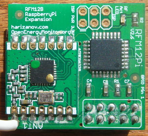

Very definitely a Martin Harizanov’s RFM12Pi “RFM12B Raspberry Pi expansion” with very definitely a RFM69CW.
I’m not saying this is the problem in this case, it looks like not, but it’s something to be aware of and check.

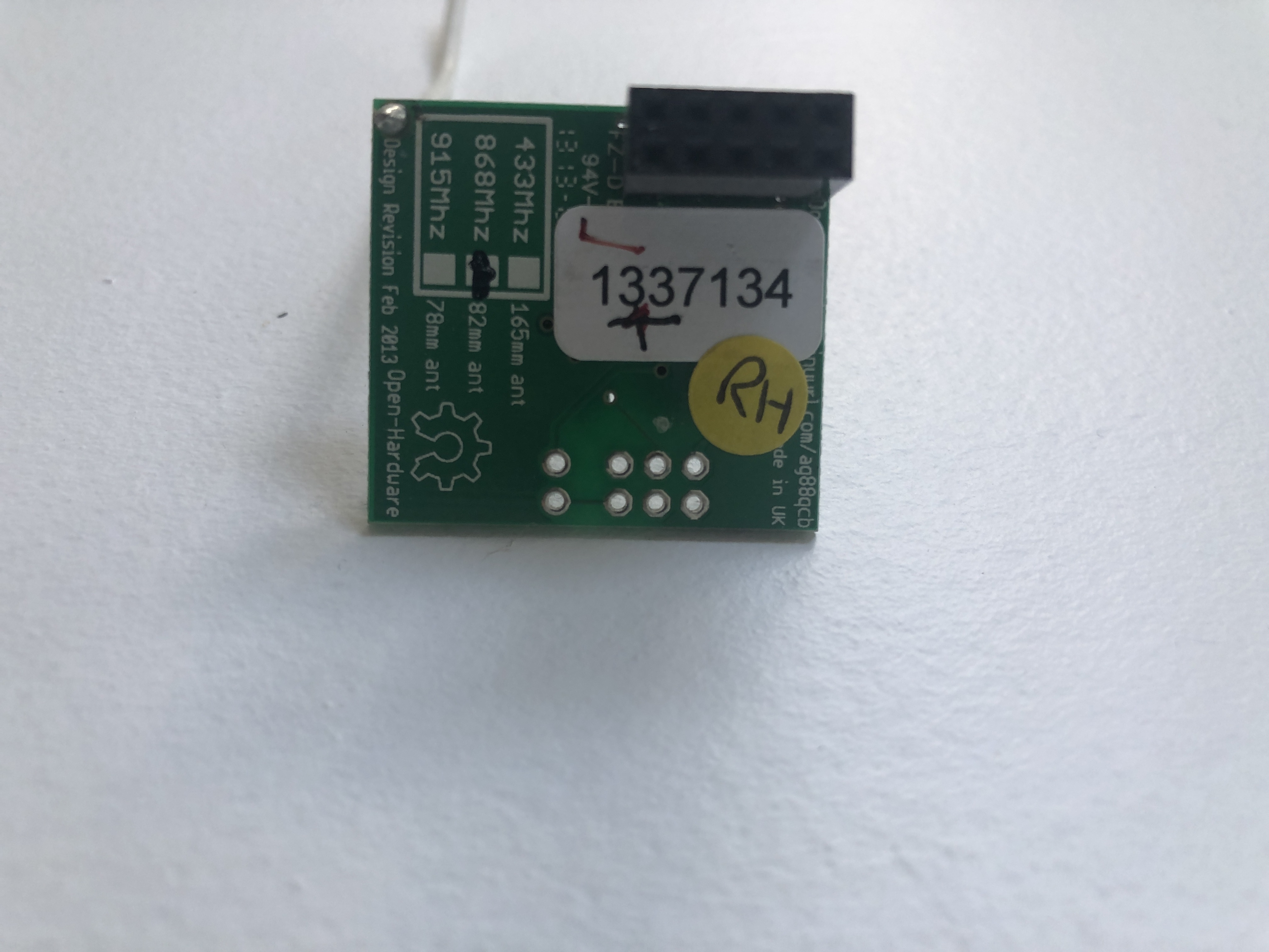

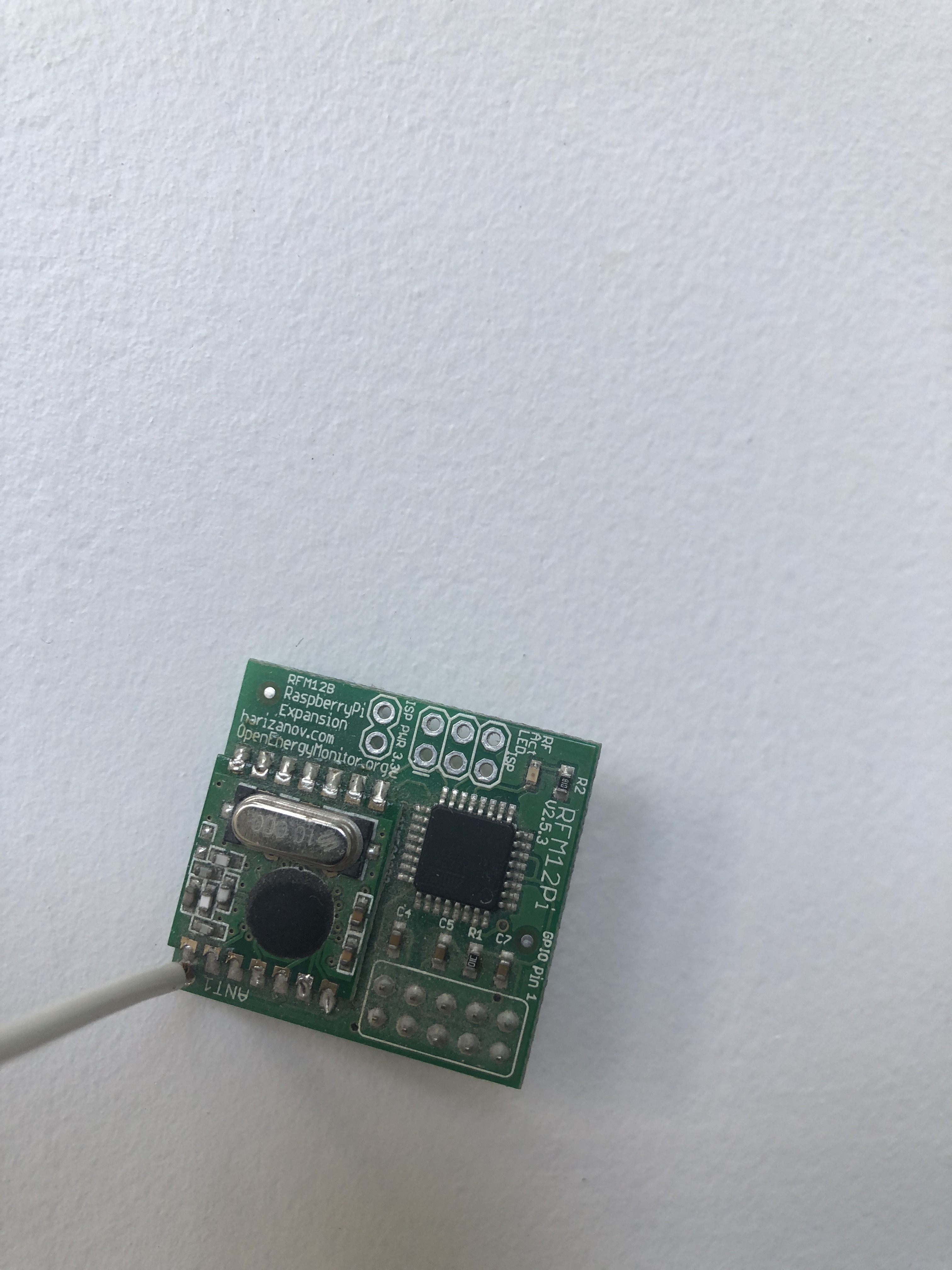

Here is my board.
Definitely a RFM12B. And unless you specifically uploaded the RFM12B version of the software, it will have defaulted to the RFM69 software and the sketch will lock up and not communicate.
This should not affect how the Pi itself runs, but of course if the radio isn’t working, you’ll have no input to emonHub, and nothing into anywhere else downstream.
The firmware that Trystan linked to (post 51) MQTT change now nothing works even after returning to defaults - #51 by TrystanLea is definitely for the RFM12B and communicates at 9600 baud (you’ll need that setting in emonhub.conf).
But that is not the same as what Brian posted here (post 63) MQTT change now nothing works even after returning to defaults - #63 by borpin
I have that file on my emonPi, and the C source contains this:
 #define RF69_COMPAT 1 // define this to use the RF69 driver i.s.o. RF12
If the .hex was compiled from that, and this link
has that same line in the source, IT WON’T WORK because it will be using RFM69CW commands to a RFM12B radio.
You must make sure you get the RFM12B compiled version RFM12_Demo_ATmega328.cpp.hex
