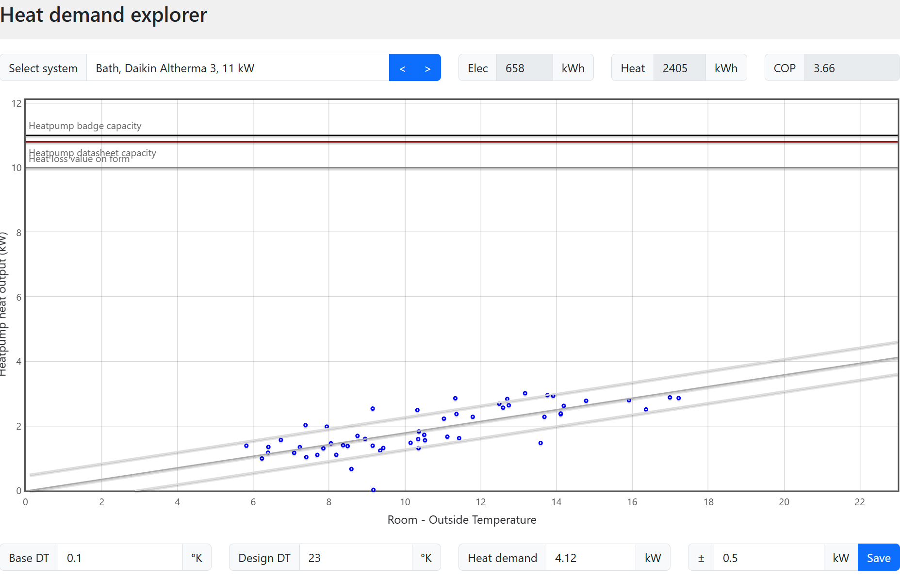

i thought i would mention here that octopus over sized my heat pump by nearly 50%, 9 kw version originally fitted but was still hitting cops between 3-3.5 i convinced octopus that the heat pump kept cycling and was over heating my home , so they changed it for a 6 kw version and my cops have now been as high as 6 but are currently between 4 and 5.8 , i do get live data direct from the heat pump into home assistant which has shown the current heat pump only using 300watts and today at 2 degrees C up to 500 watts , the old 9 kw heat pump would only modulate down to 800 watts but the circulation pump also seemed far to fast/big, good luck in getting octopus to update your pumps ,
Thought I would share my situation.
Octopus installed the 11kW in October.
I have had an Octopus engineer visit just before Christmas who agreed it looked oversized but could only suggest a re-survey. She called the surveyor while she was here and they went through the heat loss and couldn’t find anything anything obviously wrong. She also set the curve back to the default Octopus curve and increased the Madoka modulation to 10 as that was what Daikin were recommending Octopus do on all installs. Mind you setting the 10 modulation is just dropping the curve back down to below what I had moved to anyway. Her argument was that Octopus might be easier to convince if using their settings.

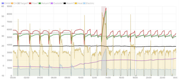

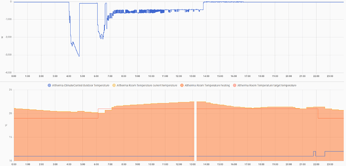

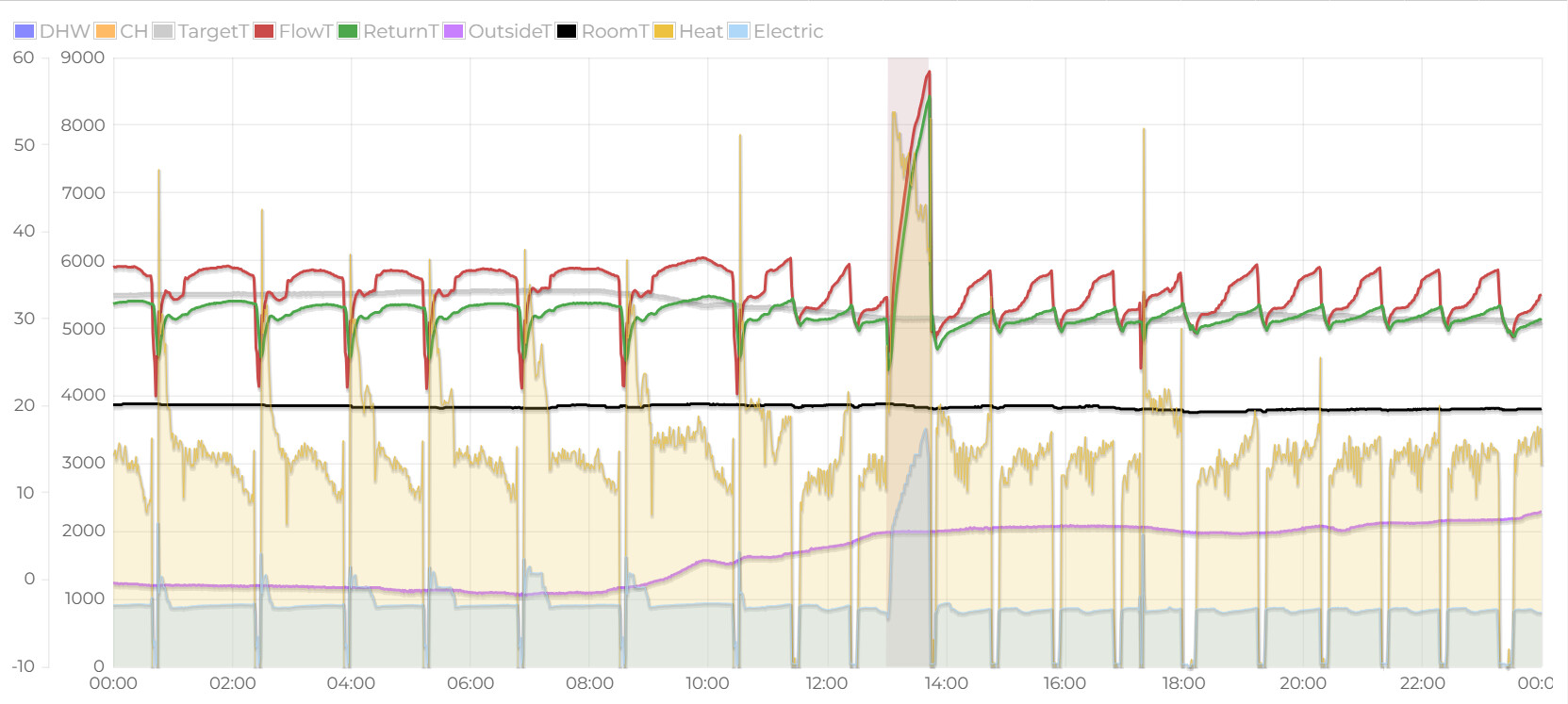

Typically what I see is the Madoka drop the curve by one step size, then another step size shortly after before then exceeding the overshoot and the room temp getting to 1.5C over the thermostat setting and shutting off. The cycle will then repeat once the room temp drops to 0.5C below the thermostat setting. Actually setting the Madoka modulation to 10 helps highlight the issue as you can see the Daikin try and ultimately fail to control the heat output.
I have a re-survey booked in the new year which will be survey #3. Survey #1 wanted a 16kW for 10kW heat loss, survey #2 dropped that to an 11kW for 10kW heat loss, which is what got fitted.

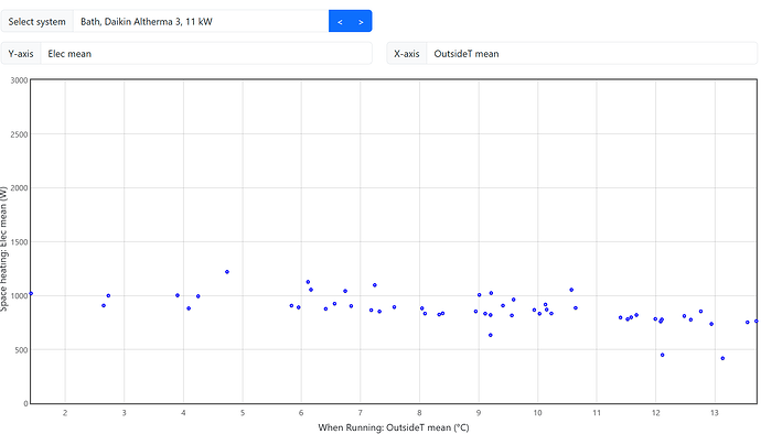

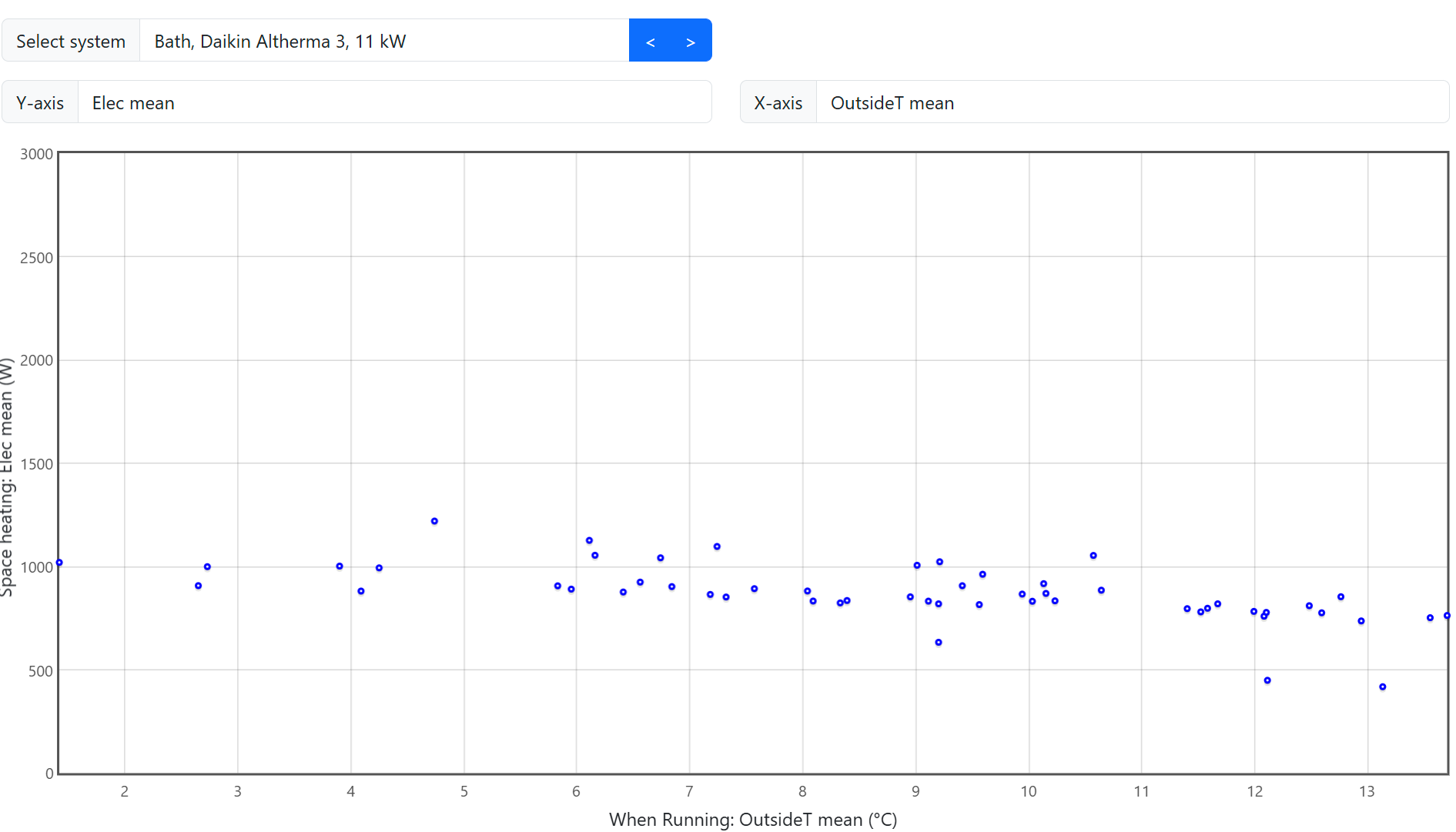

Its pretty much sat at minimum electrical input power, most of the time, down to about 6C but even below freezing it rarely gets over 1000W of electrical input.
So rather than modulate the electrical input/heat output up and down its just varying the duty cycle in response to the outside temperature.
The heat demand tool looks like this
More details here
Emoncms - My Heat Pump
Hoping we can find something wrong in survey #3 as this is far from ideal but am worried that with two surveys already, with different Octopus surveyors both came back with 10kW heat loss.
