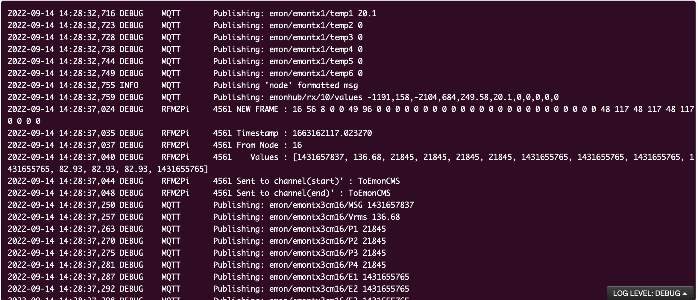

I’m now confused. Can you grab a screenshot of the emonhub log, showing the input from Node 15. It should look a bit like this:
2022-09-14 00:12:09,786 DEBUG RFM2Pi 819244 NEW FRAME : OK 5 214 0 233 0 191 1 72 93 0 0 0 0 0 0 0 0 0 0 0 0 60 203 25 0 0 0 0 0 249 186 25 0 162 73 27 0 (-0)
The bit that will tell you it’s from Node 15 is the first thing after “OK”, In this example, it’s from the emonPi itself, Node 5. You should see 15 there. If you can’t see it, it shows that the input is not coming in by radio, and I’m lost, because I don’t know enough about the ESP8266 and its software to know why it’s not showing what the sketch showed when I tested it. Running it again a few moments ago, I got this:
Only two c.t’s were plugged in, which explains why there’s nothing from CT3 & CT4, no temperature sensors were connected and no pulses had been counted. But the numbers aren’t stupid, as yours are.

Going up one post, the emonHub screenshot shows that the data is coming in by radio. Do you have two nodes called Node 16 on your system? Or in your emonhub.conf file?
I really needed the line above the top one in your post - frustratingly, I can just see the last bit 0 0 0 0. I’ll try to work backwards from that to work out what’s going on, but it will take some time.
The data is currently coming by radio. Thought I would get it to work that way first! Only 1 node 16. Directory structure now correct and no errors shown when uploaded. still rubbish data though. must be something I have done. There is another emontx3.2 doing discrete monitoring working fine.

That took an embarrassingly long time to realise what was happening. The data is being sent without “whitening”. Whitening is when we XOR each data byte with 0x55 so as to not have a long string of zeros, which can cause the receiver to lose sync and fail to decode the message. But you’re decoding the message with whitening on, so a two-byte integer with a value of zero is being turned into 0x5555, or 21875 decimal.
Does your entry in emonhub.conf for Node 16 have the line
whitening = 1 (You said it was the same as in the sketch - which does NOT have that line.)
If so, delete it. If not, I’m not sure what’s going on - I thought the default was ‘off’, or whitening = 0.
