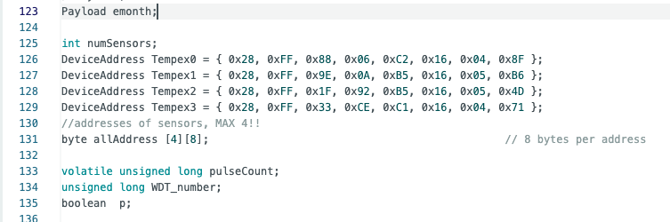

I use a emonthv2 and I would to have 4 ds18b20 sensor.
I read night and day, many and many thread and I never found how to put the address of ds18b20 in my sketch. I use the sketch emonTH_DHT22_DS18B20_RFM69CW_Pulse.ino.
Please, can you tell me how I must write the address of ds18b20 in my sketch?
Thanks you so much for your answer.
Laurent

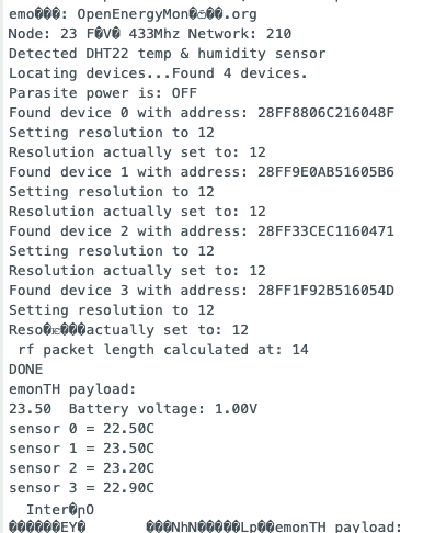

Thanks for your answer.
I try the sketch but no way.
I saw this :
Sans titre
and no data in Emonhub.
when I use the next sketch, data appear directly in Emonhub.
I put sensor address like this in sketch :
No difference.
I don’t understand.

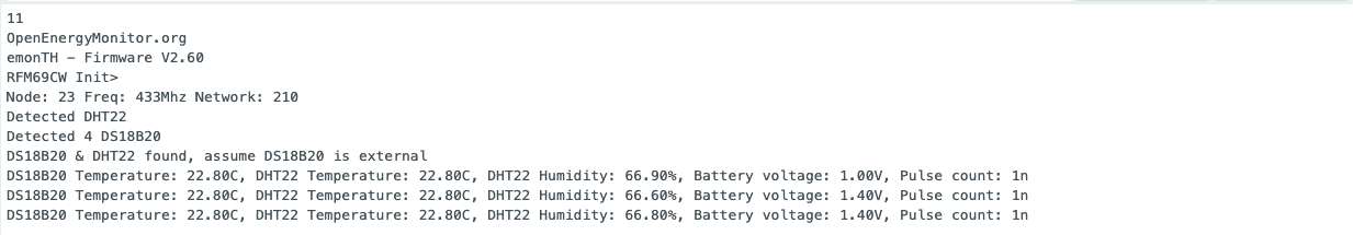

I use this sketch :
I read all you send in last post.
I try to understand all but my English is poor but I try.
How can I know what his the exact Node definition in emonhub.conf which matches exactly the format of the data sent by the emonTH.

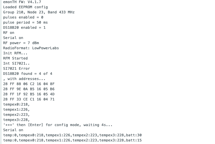

I tried this sketch (emonth2 v4.1.7) and I have this ouput in serial port (I think it’s serial output) :
I define the node in emonhub. conf like it’s wrote in emonth2-2.ino but nothing in log of emonhub.
Whay do you think about that?
Thanks.
It should just be a case of changing #define EXTERNAL_TEMP_SENSORS 1 to however many sensors you want.
You’ll also need to change the emonhub node decoder, at the top of the sketch there’s an example for 4x temp sensors:
It works almost well now.
In Emonhub.conf, I deleted the “s” in datacodes.
DHT22 sensor doesn’t work and the LED stay ON.
Any idea?
Thank you so much.
