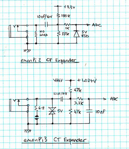

With regards to the CT expander board, wonāt the emonPi3 expander schematic be different to the emonPi2 expander? See below / per input ā¦

- Yes, the inputs are slightly different but compatible. The most important thing is the bias point at 1/2 Vref. In the Pi3 this is derived directly from the reference, whereas in Pi2 it comes from the noisier/less stable 3V3 line. If we want to change this, it would have to be a full respin of the CT expander board and a small modification to the Pi3 board, which is an OEM shop decision depending on their stock levels and future plans; @TrystanLea, @glyn.hudson or @Gwil might be able to chip in. Side note, I love your schematics - I assume theyāre hand drawn? Unfortunately my hand drawn schematics are much more of the Bob Pease varietyā¦

- The anti-alias filters on the emonPi3 inputs have a delay of ~0.6 degrees at 50Hz, so if the emonPi2 expander is used, the phase calibration/correction constants for inputs 7-12 may need to be slightly different to those for inputs 1-6?
