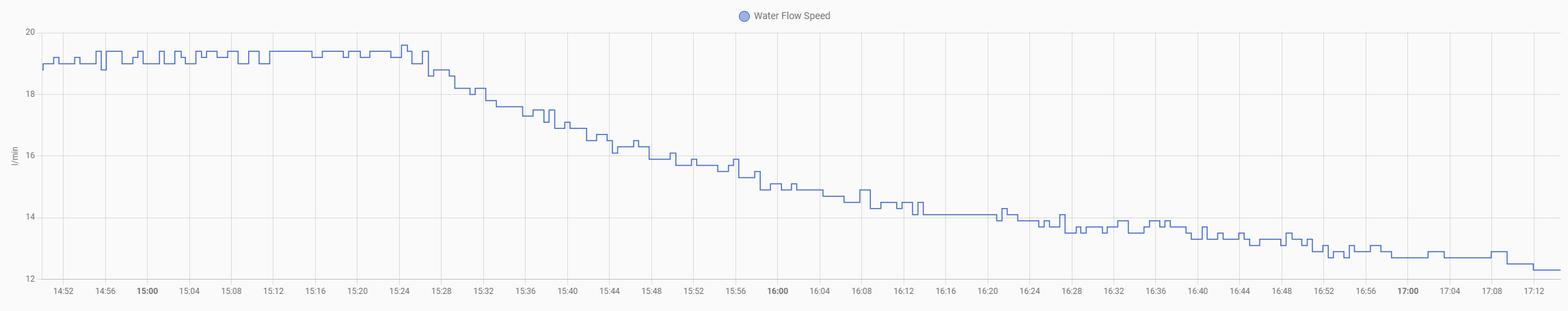

Did you find the issue with flow not updating ? On my gen. 7 Samsung HP seems the flow is updated frequently upon every change so probably a bug in a firmware ?

No, the flow rate has always returned correctly via modbus.

Flow rate - yes I know it returns correct value, but you’ve said it updated very slowly so COP calculation could not be calculated properly. On my pump it updates in real time som maybe numbers will be better ?
