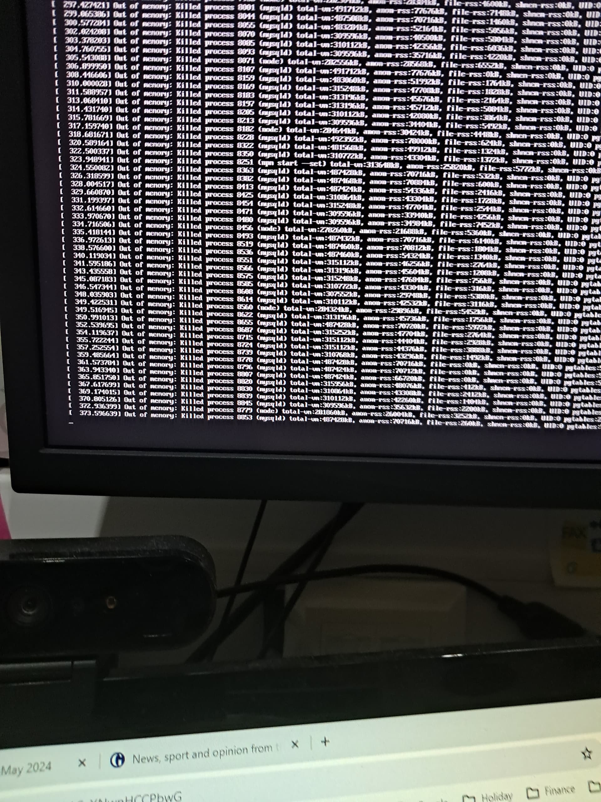

I restarted the Pi and noticed these out of memory items appearing on the consol they stopped when I stopped the addon

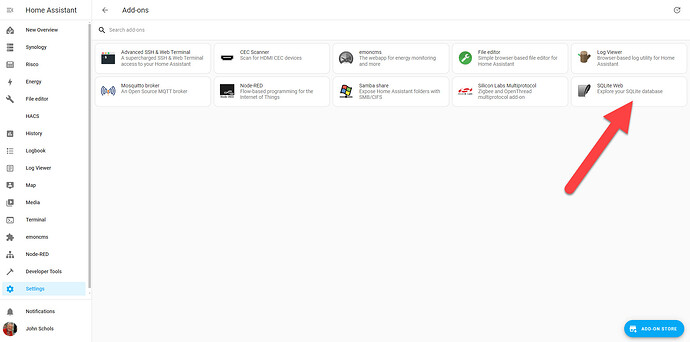

No I do not have MariaDB running. My machine is a Raspberry Pi4 (rpi4-64)
If I load MariaDB will that interfere with the SQLite Web
No it should not not interfere

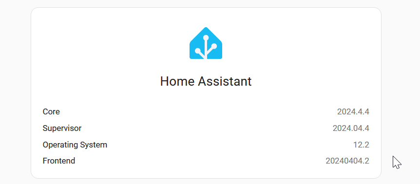

The only difference with my setup and yours is HA version. My setup is the following :
I’ve just tested on another arm64 machine (jetson nano), made a fresh pull of the alexjunk/emoncms:alpine3.19_emoncms11.5.0_1 image (the one you are using in the addon), launched a container and it is working, but block size is 512 not 4096
maybe try to uninstall and reinstall emoncms addon…
@JohnSchols : any progress on that ? Could you manage to make it work ?
working fine on my side with
  • Core 2024.5.3
  • Supervisor 2024.05.1
  • Operating System 12.2
  • Frontend 20240501.1

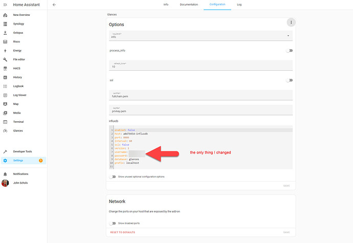

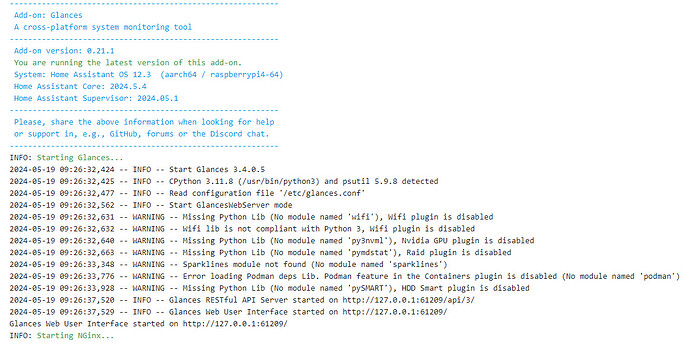

Brian or anyone else, can you help please. I’ve loaded Glances, set a user name and password in the configuration, restarted HA, but when i start Glances I’m getting a 502: Bad gateway error code.
Is there anything else I need to change in the configuration?
@JohnSchols : From my little experience with HA, Glances normally starts up without having to touch anything in the configuration. Did you face any troubles while installing HA ? I assume you followed one of these methods : Raspberry Pi - Home Assistant or Raspberry Pi - Home Assistant
