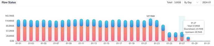

after changing the interval to 30 seconds and switching to HTTP, I am still seeing high usage per day. Over the last 24 hours, it was 98MB down and 2.8MB Up. The average packet size is:
Down - 172.4 bytes
Up - 148.5 bytes
The difference is in the number of packets. 568,446 for down and 18,880 for up (a ratio of 30:1).
In 24 hours, I would expect to send 2,880 packets (24hrs x 60 min x 2 (my 30-second upload interval)) on the upload.
I just changed the interval to 3600 (hourly) to see how much of an impact this has.

This definitely solved the problem. I tried another method of monitoring the data (it looks like my previous method was picking up some other overhead data). As you can see from the chart below (from my wireless router - which has a couple of other non-emon devices attached), changing from HTTPS to HTTP and adjusting the interval from 10 seconds to 30 seconds has made a dramatic improvement).
