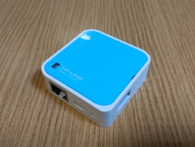

OpenWRT was never a device as such. It was a linux operating system that you could run on several embedded hardware platforms. I ran it on a cheap TL link router. The advantage is that the TL link device had a serial port input, a WiFi adapter and a LAN port. So everything I needed to simply build a bridge between a serial port and the LAN. You don’t need to do any of that now. There are several off the shelf serial to LAN devices available.

I was just looking at that and trying to figure out just how @bruce_miranda used it - it looks like a wireless access point to me - Ethernet ↔ WiFi, which I think isn’t how we use the PiZeroW, or the plain RPi or ESP8266/
Effectively, OpenWRT is a mini Linux OS so you can run a script on it to read the Serial Port and do what ever else you want.
Very clever idea as often you could make use of the AP in that remote location as well.
Is there a serial input available to connect the emonTx? Not as far as I can see.
(I’m looking specifically at the TP-Link “nano router”, not OpenWRT in general.)
I think you will find it has an USB port.

https://www.rs-online.com/designspark/hacking-the-tp-link-tl-wr703n
Trust me it has a serial port, but you need to solder 3 wires to gain access to it. Very easy to do. The beauty is that you then have access to a small network connected Linux box that you can do so much with.
If you have a PC close by to your emontx then just plug the Serial Port into a USB UART and you should be able to read the serial port data directly.
That device can have OpenWRT loaded on it too. And I will bet it has a Serial port on board the PCB too, which is what the current USB is connected to.
