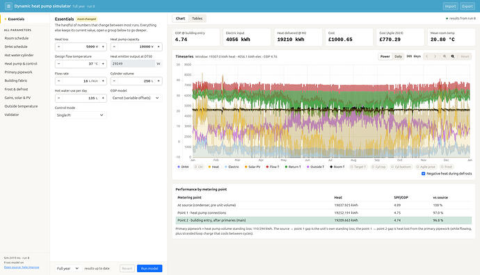

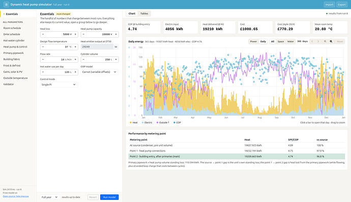

That’s a good schedule comparison, did you get a bit of undershoot on the target temp, Im getting about 4000 degree hours below set point? But it’s still doing well hitting ~20.2C on the coldest days:
Interestingly if I adjust Kp and Ki to reduce degree hours below set point to ~2200, I no longer get a saving and now the intermittent mode uses 3.6% more electric!
Alternatively it looks like running 20.2C continuous (the max temp actually reached by the first intermittent example) saves about the same amount as the intermittent schedule on a fixed tariff..
Managed to get an 8% saving with your morning and evening schedule (peak temps of 20C in the schedule) with setback increased to 17C to help meet the peak time setpoint and Ki adjusted up a little.
Moving the start time of the evening schedule from 4pm earlier to 1pm increased the saving - presumably as the heat up happens at warmer midday temperatures. Starting the morning schedule at 5am rather than 6am has the opposite effect (decreases the saving)..
Back to 15% saving with 17C setback and 20C on period 1pm-10pm:
  • 15% saving with Vaillant 5kW interpolated cop model (8.5 kW max output, modulation down to 30%)
  • 12% saving with variable offset carnot cop model (5.0 kW max output and modulation down to 40%)

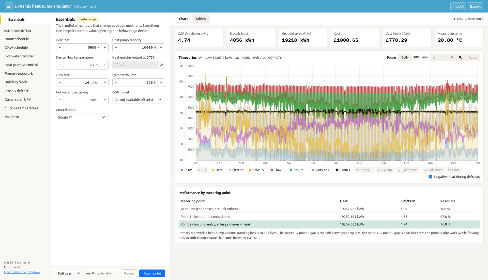

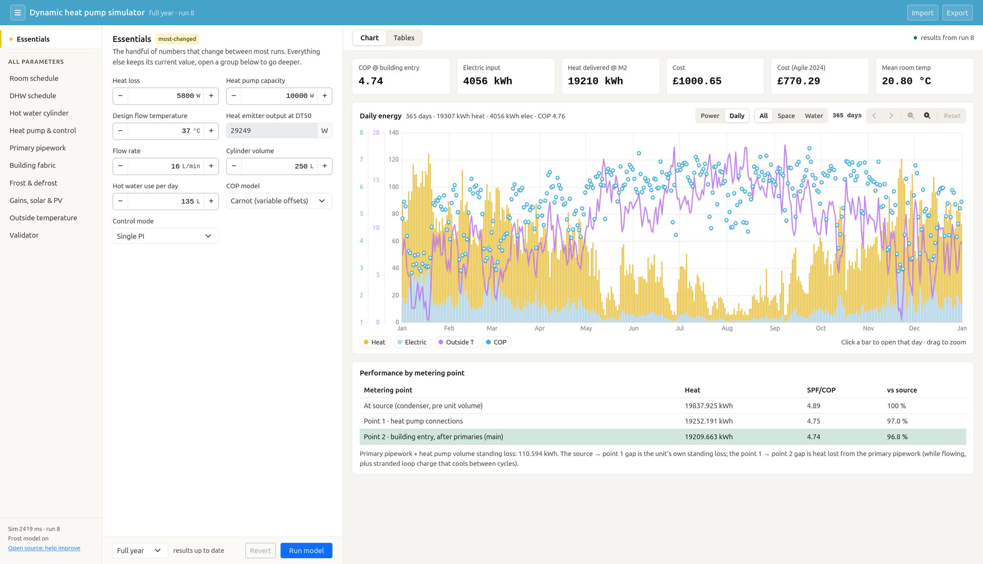

Just playing around with the responsiveness of the simulation PI control algorithm, and actually contrary to what I initially wrote in my reply to your post above @Dan_Grey it actually has less impact than I thought. E.g if the control algorithm does hit the target temperature setpoints, how fast it does so results in savings variations in the ±2% range.
I didn’t list the full conditions to reproduce the “Load compensation, gradual heat up from 17C overnight starting 10am, 20C by 5-6pm” example. I now with slightly different parameters get slightly lower cost difference between running continuous and intermittent with the agile tariff.
  • 3.4 kW heat loss
  • 7.4 kW of DT50 radiators
  • 250W internal gains
  • 30% minimum modulation on the Vaillant 5kW (max output 8.5 kW)
Then an interesting result is that if I increase the radiator capacity from 7.4 kW to 15 kW corresponding to a design flow temperature of 38C. I can now achieve a financial saving of 18% with fixed tariff intermittent heating and even a 2% saving with this intermittent schedule coupled with agile!
