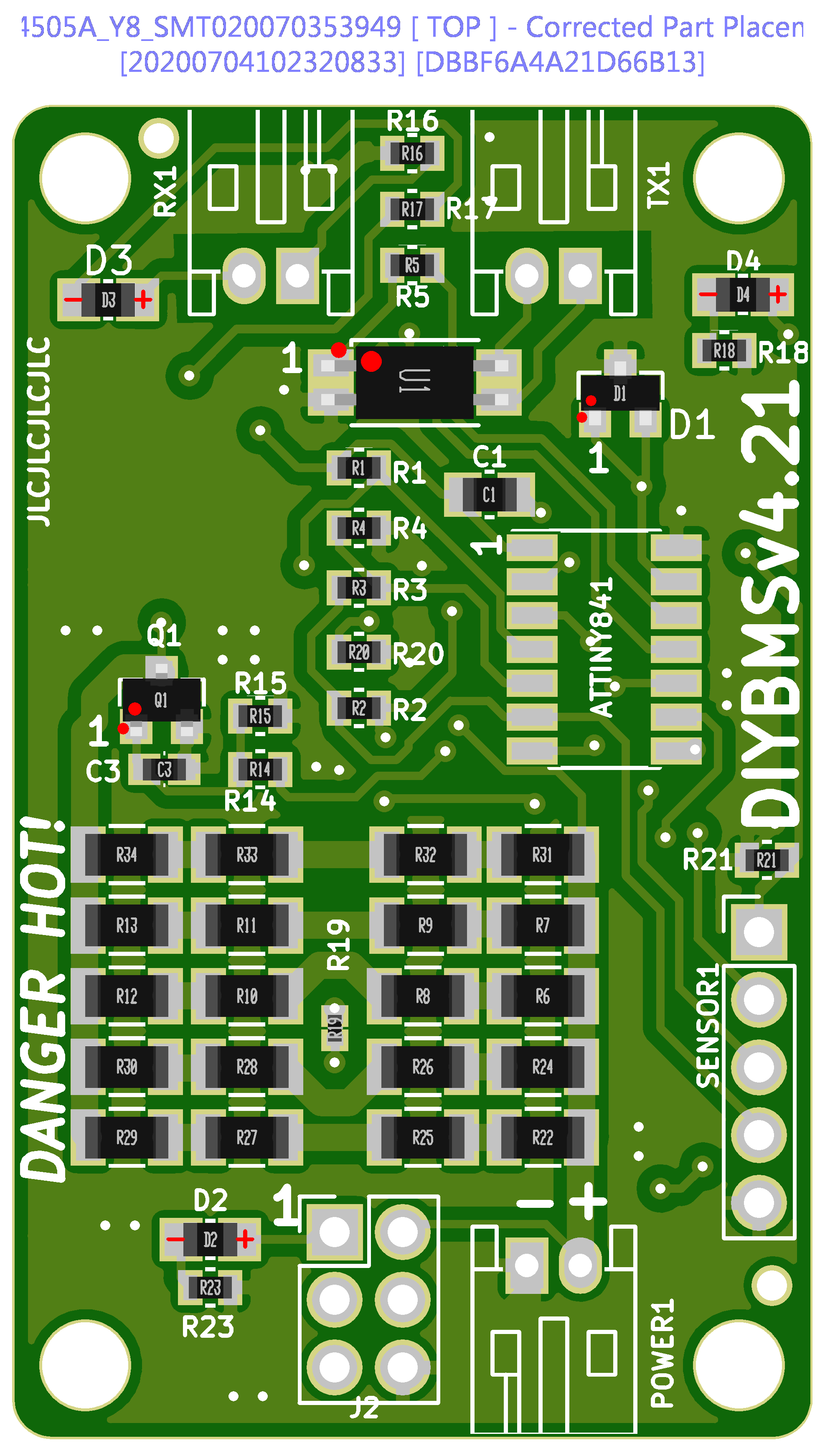

Hello Stuart,
First off a big thanks for the latest video, not only for having it setup to get them pre-built but also for how to do that process with them.
Everything did look to work properly but they did come back with a question about polarity and I responded with use the polarity in the picture. Heres another big thanks, the gerber files and csv files generate an excellent picture so I was comfortable with my response.
Does it make any sense to silkscreen polarity ? Just looking at the png files from github Im inclined to say no (there just doesnt look to be room), but thought it was worth asking.

Anyone have any thoughts on using one of these to power the controller?
I currently have a 3S15P test pack and I decided to wire one of these direct to the pack to power the controller. I now seem to get a lot of communication errors.
Anyone else tried one of these?
There is probably a lot of noise on the power signals. Try putting a large capacitor across the +/- input to the controller.
Thanks Stuart
Any idea what size i should use?
Start with anything you have! Probably 47uF or similar, just make sure the voltage rating is okay (5V+) and ensure you get the polarity correct if its an electrolytic cap. It may be worth also including a low value cap as well - like 100nF.

I may have found the culprit. Dodgy USB lead (aliexpress). I will continue to monitor.
Hello to all! Those who are experiencing problems in the work of DIY BMS. V3, cross charts and reboot esp. Impact of interference. On the esp, pull up the ā€˜RSTā€™ and ā€˜ENā€™ pins to +3.3V with a 2.2kĪ© resistor. On pins 3.3v and ā€˜ENā€™ , hang ceramic capacitors at 0.1mF relative to gnd. For fast real-time balancing, change the last line in the esp code from 20,000 to 500 - 1000
