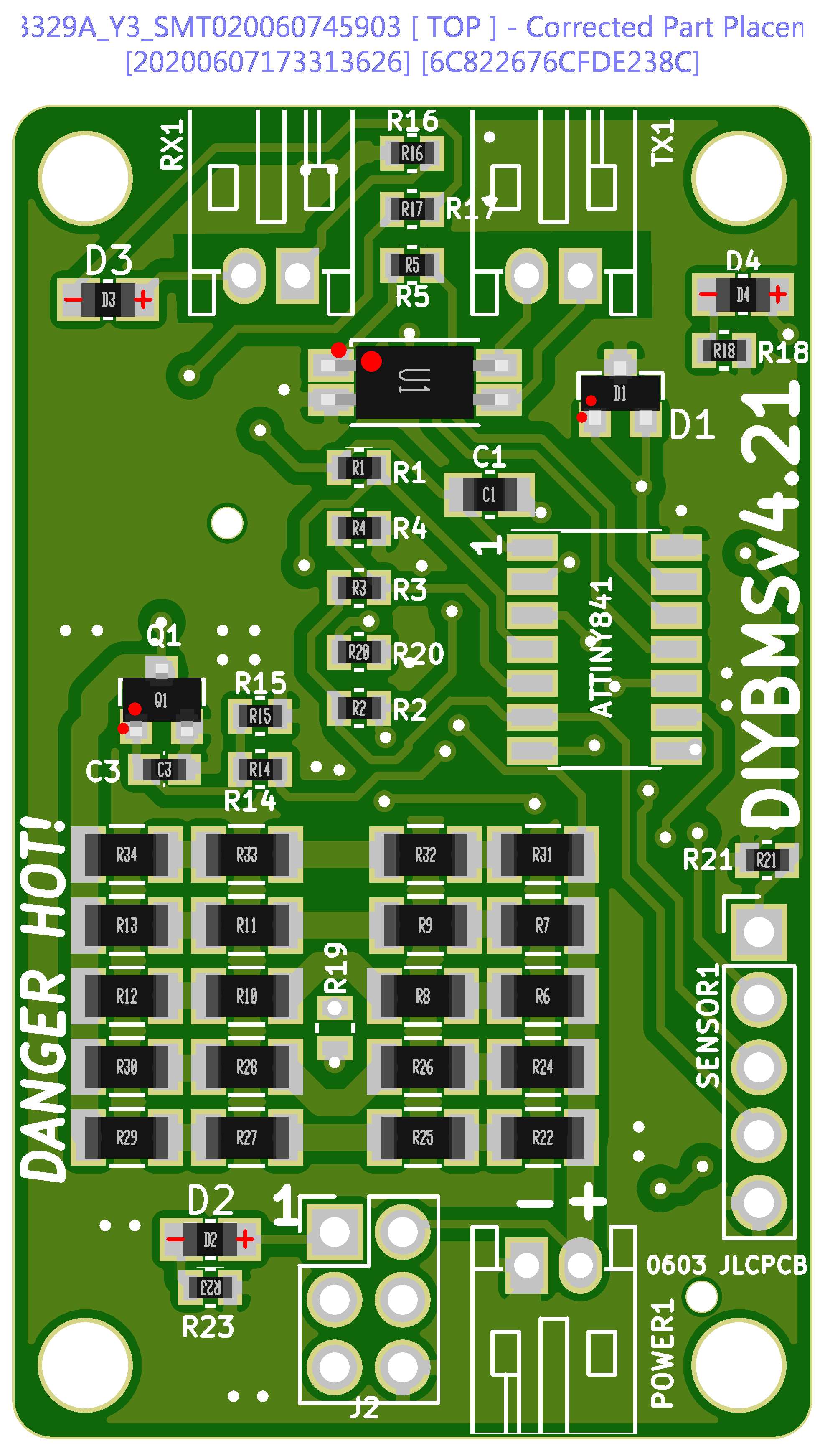

What are the correct fuses to burn for the V4.21 pre-soldered boards?
thanks.

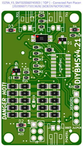

I received the following message after uploading the files to Jlcpcb.com:
Hi Sir,
Well got your order with many thanks~
Sorry to bother you, but there is one thing that we want to confirm with you about your SMT order before proceeding.
As shown below, we are not so sure about the polarity for the components below is correct or not, could you please kindly have a check?
Can we just make it as shown in the picture?
Your early reply will be highly appreciated, thank you so much!
Thanks and best regards.
Can you guys help me out here??
Thanks!!
The pin out of the device you used is completely different to the TL432. Might be worth checking you didn’t mess up any of the pins on the ATTINY (unlikely).
Just use PLATFORMIO to program the boards - use the code from master branch in here…
R19 and the ATTINY are both missing. The orientation of the parts is fine - assuming you used my files from GITHUB ?
I’ve ordered a lot of boards from JLC and never been asked to clarify/confirm the positions, they should be spot on.
I wouldn’t order until R19 comes back into stock - its a TINY component to solder by hand. Smaller than a grain of rice !

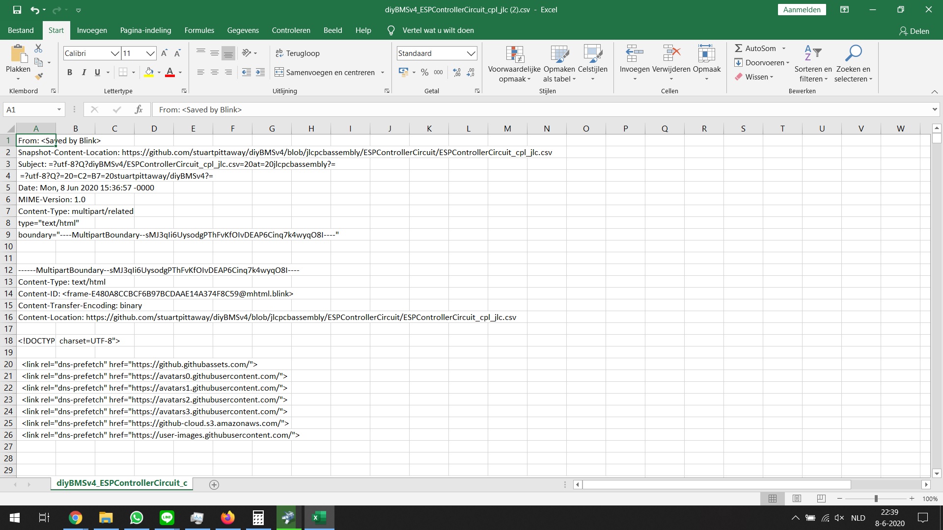

0603 ain’t that much smaller then 0805, and I need to solder all parts on the controller board, yes? the CSV’s can’t be used except for viewing on github.
at download the name is: ā€œdiyBMSv4_ESPControllerCircuit.csv at master Ā· stuartpittaway_diyBMSv4ā€
(CSV’s for the battery boards go OK)
if I open the file looks like:
Did the link get corrupt??

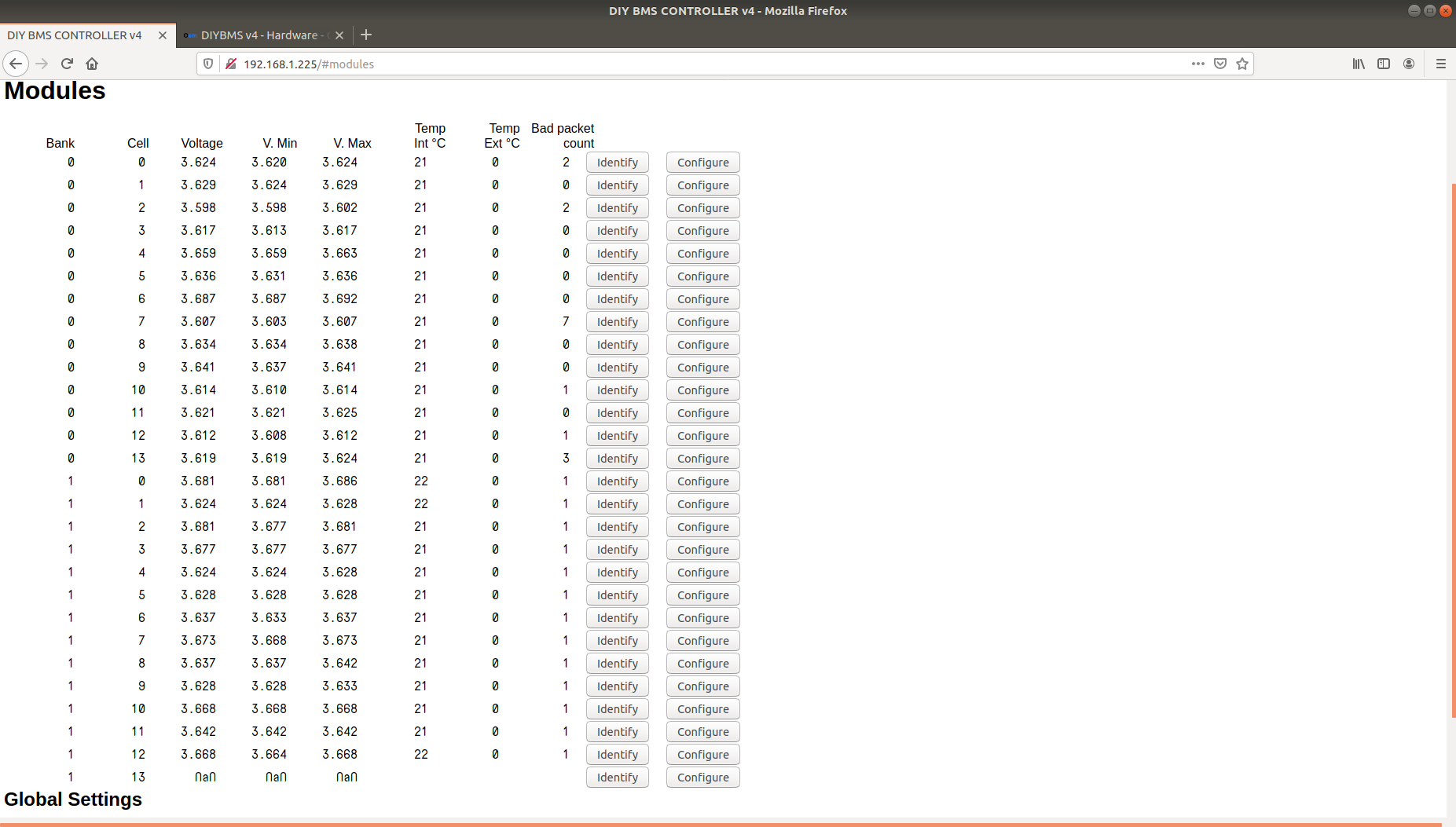

I’ve just finished connecting my second 14s to the controller and assigned each to the second bank (bank 1) and for some reason the last cell on the second bank has invalid voltage (see pic). I’ve substituted a different module for that cell and it also has the same issue. If I assign that module back to the first bank (bank 0) it reads a voltage correctly. I therefore think the issue is in the controller code rather than with the module. I’ll have a dig around and see what I can figure out (unless this is something someone has seen before)?
Does anybody have a recommendation for the external temperature sensors?
The code tells me to use thermistors which are used with the ā€œSteinhart Algorithmā€.
Would these thermistors be a good choice?
No it doesn’t sorry.
Not seen that before @hotear.
Can you capture the JSON message/data that the web browser receives (press F12 to enter developer page). Trying to narrow down is it the web javascript code or the controller?
Additionally may be worth capturing the packets from the modules using the debug serial port on the controller.
