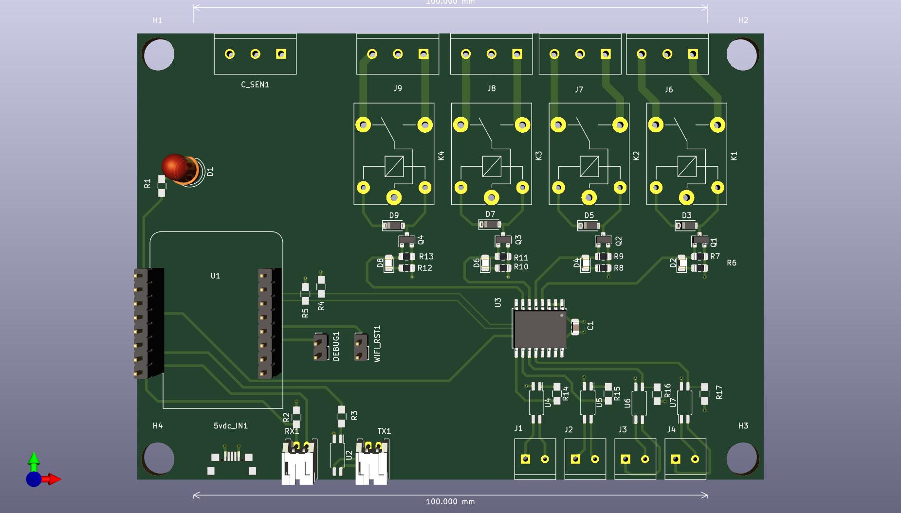

Coming to a theater near you… SON of ESPcontroller (in living Colour)
… ESPcontroller was the scourge of powerwalls. Grown men raged, children hugged their parents legs. Now comes ESPcontroller-extended… everything ESPcontroller was and more.
OK… maybe not the scourge of all powerwalls but I extended Stuarts design to inclulde the external relays, add opto isolated digital I/O, terminals for the ADC channel (custom current shunt coming) and best of all… an enclosure.
I sized the new PCB to fit this enclosure from AliExpress:: 1pc Transparent Plastic Industrial Control Box Panel Enclosure Case Din Rail Project Electronic DIY PCB Shell|Wire Junction Boxes| - AliExpress
This is the new PCB at the 90% layout state. I will include a screw strip for the I2C bus in the final run.
The micro USB is for power only. If you need to update the D1 firmware you must use the usb connector on the D1. (remember to unplug the external power to the ESPcontroller.
The relay screw terminals are a larger devices as it seems some crazy people think 220vac is OK for the homes… 5mm spacing between pins will keep everyone happy and alive. The relay contacts may be rated for 10amp but the connecting copper traces are not. For proper electrical you should be driving contacters rated for your demand with these relays.
I am still working on the pcb dimensions. Getting a Goldilocks fit, not too tight, not too sloppy is necessary to allow for enclosure variations as well as pcb trimming variations.
All through-hole parts: relays, screw terminals and JST connectors are available from LCSC. You can order an assembled board and add the relays and screw terminals later but I do recommend you have all the electronics assembled by JLCPCB. The few extra pennies it cost should not break your budget. Of course you can do a group buy in your area…
More coming in the future.
George

@GeorgeBoudreau
Regarding your new controller board layout:
Looking very very nice
There’s plenty of room on the PCB. Why not add one of the tiny buck DC-DC converter PCB’s, from Aliexpress etc., as a piggyback to the design, and an extra connector. Then the board can be supplied with 12-24V
