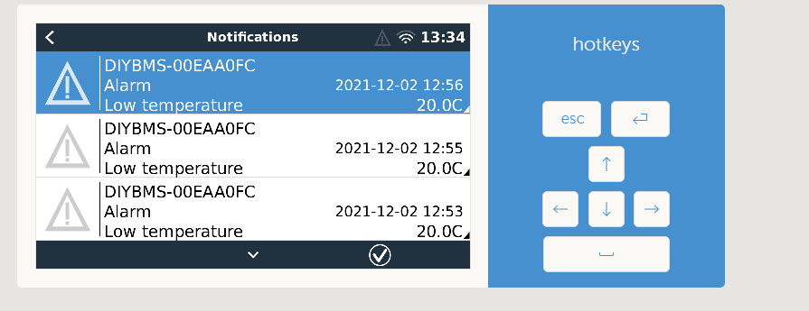

Hi Stuart. Your system is great. Congratulations.

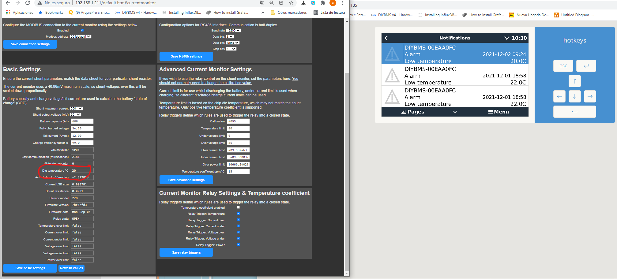

As you know I have a DIYBMS communication with Victron. But as soon as the temperature has started to drop to 20Âș (I live in Malaga Hehehehe), I am having alarms in Victron for low temperature. If I look at the Basic Setings configuration of the Shunt, I see that the set temperature is 20, it can be changed, as I see the dark field, I don’t know if it can be changed). Sorry for asking instead of experimenting, but the system is so fine at the moment and it has taken me quite a while to adjust it that I don’t want to change anything just to experiment. I leave a picture
Untick the temperature setting
Although I suspect it is one of the module rules instead, which one of the rules are green/active?
ok. uncheck Relay Trigger Temperature in current monitor Relay Setting

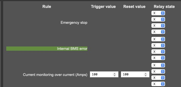

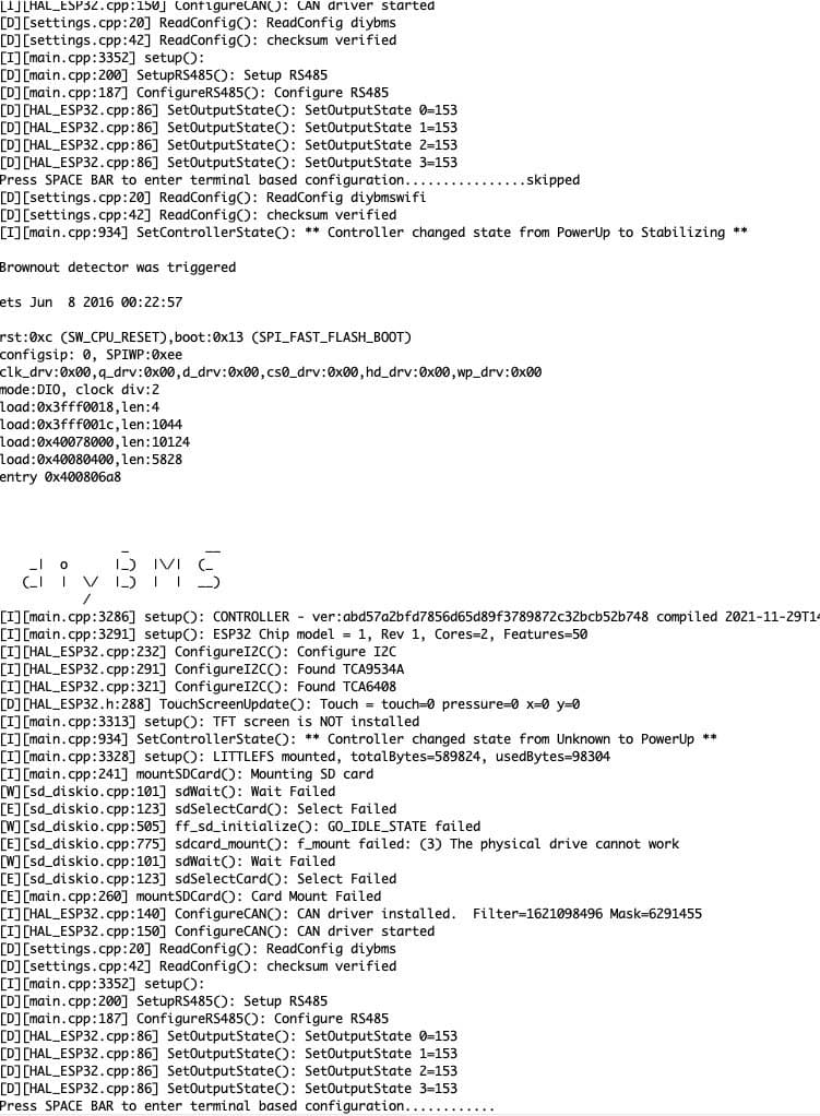

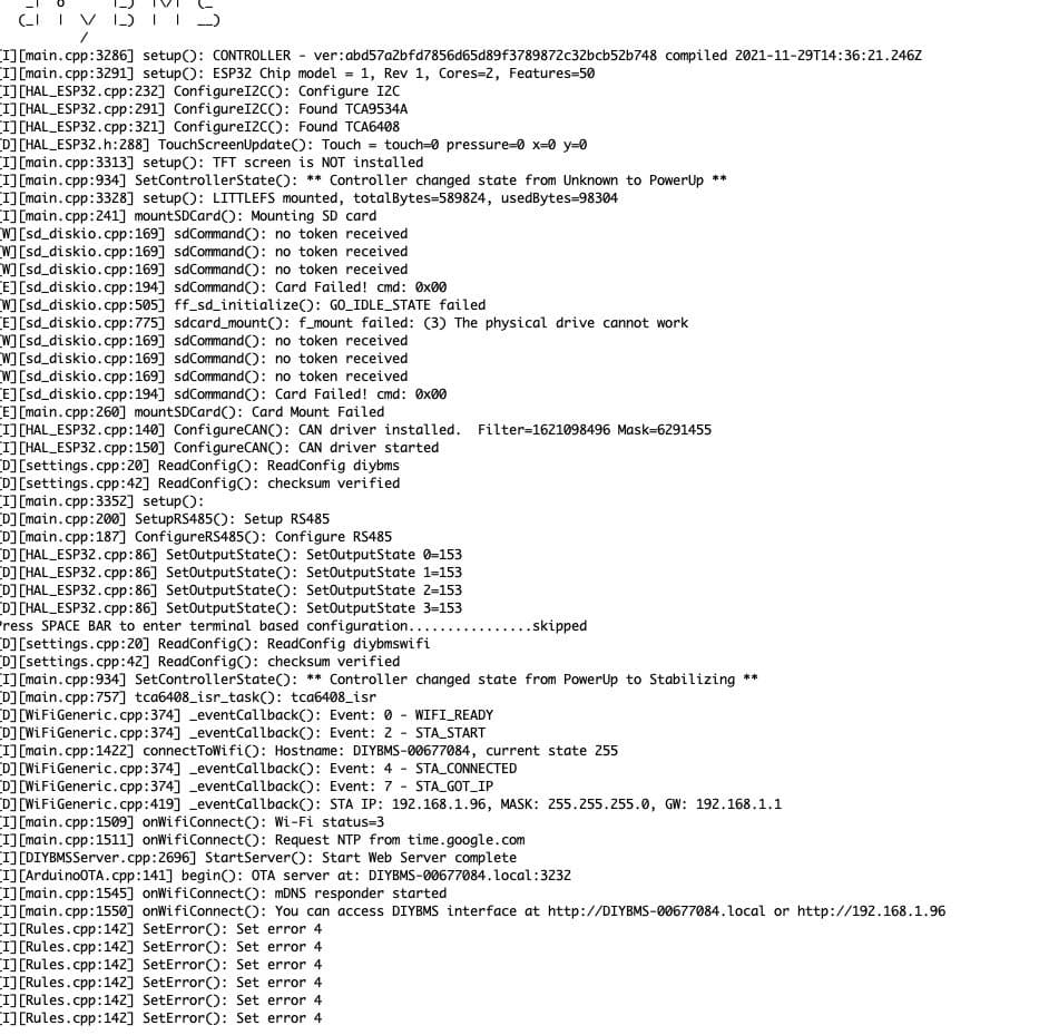

I have a friend who does not like the controller, he connects the modules, (4) and they do the synchronization sequence between them but the controls show him an internal BMS error. I’ll give you a screenshot of the information extracted by serial port
The problem your friend is facing is that he is not providing sufficient current to the controller for it to work properly, it needs a 5v 1A supply on either USB or the external 5V supply connection on the PCB.
He may also have an undersized LDO on the ESP32 Module itself (not the controller PCB). If it is a genuine Espressif DevKit-C then that is unlikely though.

Thanks for the answer, but unfortunately it does not seem like a power problem because it is being fed by a 5v 10A source
Edit:
Sorry my friend I was wrong because when the reading was taken through the serial port it was powered only with the computer’s USB and therefore with less than 2A. I’ll tell you if the problem disappears, Thank you very much.

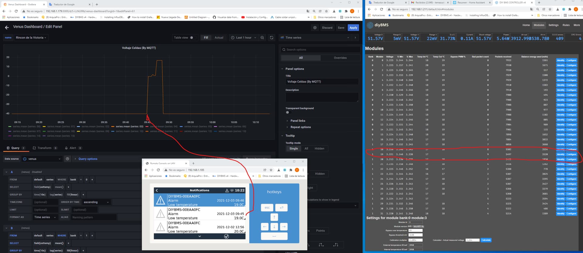

I think I have identified the source of the alarms. in bank 1 there are two modules without external sensor (I have to repair the sensor contacts) in DIYBMS it appears without external temperature data (normal) but nevertheless it can be seen in the data communicated by MQTT that these cells report an external temperature of -40Âș. however, coinciding with the time of the appearance of the alarm. the values reported by mqtt change. they can be coincident with an error in the transmission of packages probably. and this gives a wrong temperature reading and triggers the alarm. How about Stuar? can be the explanation?
I am not in australia but Holland, but i have the controller available :wink: if you pay postage you can have it
Ok, it’s a possibility that’s the root of the problem, however the victron alarm is driven from the rules, so if they are not active it shouldn’t be triggering the victron.
You might consider a higher quality USB cable, the ESP32 will draw up to around 750mA 3v3 which is slightly lower on the 5v input pin. Some PCs also will limit the current on the USB bus to 500mA, others may not.
As Mike mentioned, I’ve also seen clone ESP32 boards with the wrong 3.3V regulator fitted, only providing 500mA so that causes problems.
Often this is a problem when you also have a weak WiFi signal.
