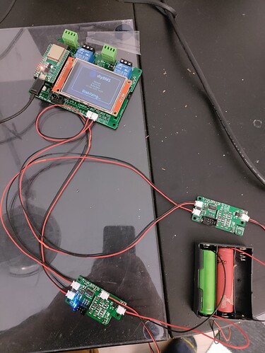

First startup of DIYbms v4.4 and esp32 controller here. I have combed thru this thread and tried many tips but to no avail. Should there maybe be a “First start problems”-sticky in the conversations?
Everything went fine installing but the controller gets stuck on “Stabilizing”-screen and “waiting for modules to respond” on top of the web interface. A green blinks on the controller, slow & random blue blinks on one module and two quick blinks on the other. Seems repeating.
Modules tab says NaN. Settings tab I modified to 2S1P (for my test setup).
I programmed the modules with a cable from the controller without errors (latest firmw). Also upload to esp32 without problems (also latest, used pyFlasher).
Two pictures of my setup if someone spots a problem. I checked some of the diodes etc for misplacement but cant figure it out.
EDIT: I uploaded the “boardtest” with NodeMCU pyFlasher. It beeps but does nothing else.
Help please, I just don’t know where to start troubleshooting.
Looks like a Comms issue.
First step, just connect the tx and Rx of the controller together.
You should see lots of ignored errors in the web page.
It looks like your TX is connected to TX.
Flip the Module upside down to see the correct TX/RX ports.
The front of board says RX above the TX connector.
Yep, the Ignored counter keeps going up.
Double checked TX2RX-wiring. Not crossed.
I made some progress: I tested the modules one by one. The module with the corner broken off for extra length doesn’t work. the “untampered” one does give proper readings.
So one bad apple soils the whole thing?

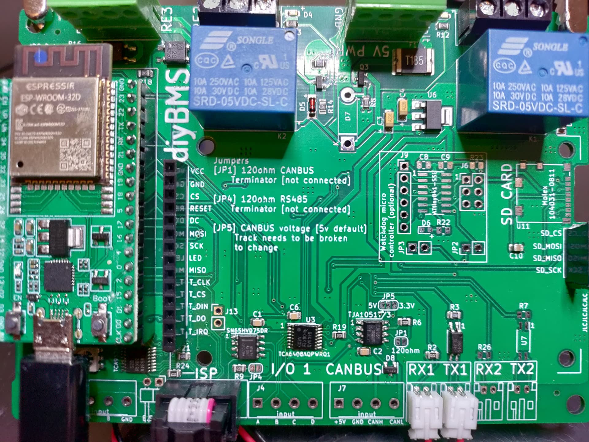

I have a problem with availability of few chips for eps32 controller.
So my question is, can I replace those with IC in brackets?
SN65HVD75DR (SN65HVD1782)
TCA6408APWR (not found) :confused:
TCA9534A (not found) :confused:
TJA1057GT/3 (TJA1050/c)
Both chips are 3.3V compatible and seems like a good replacement to me.
M´I right that those TCA chips aren’t essential for controller to work? So if I bypass them in software, will the controller work properly? (with some caveats, ofc) Or does anybody have a reliable seller on AliExpress for those? Can’t find it locally… (available in more than 30 weeks :roll_eyes: :flushed:)
Thanks for any help
Zajoch
Just check the traces where they snapped off (on the main pcb/module) just to check they have not connected together.
At first I have also thought that was a problem, so I cleaned the “snap-off” place with a file, checked the traces, but the readings from those sensors were still chaotic. I have checked the resistance then (directly on the thermistor) - it was a complete mess. But on newly built sensors, which were not snapped off but cut off, everything was fine. So I assume by snapping them off with pliers (as I have done at the beginning) there is a big chance to damage the thermistor mechanically.
PS: any ideas about communication issue?
This is not a direct swap unfortunately. The original part has a split voltage configuration where the IO side is 3v3 and CAN side is 5v (default). If you do not plan on using the CAN interface you can safely omit this component until you are able to source them.
Similar for this one, if you are not using the RS485 interface you can omit it. The RS485 interface is used for the Shunt so you may need it for that.
evening all,
along the compatibility to PDIP chips, may someone confirm:
TCA9534A https://www.ti.com/lit/ds/symlink/tca9534a.pdf
is compatible with
PCF8574 https://www.ti.com/lit/ds/symlink/pcf8574.pdf
checked the specs, look identical to most seemingly important bits - to my understanding it wont suffer from what @atanisoft explains above as it’s 3V3 both for the I2C and output sides.
Slightly worried (OK, two euro worried tbh…) that the former has a Fast Mode I2C at 400kHz which the DIP version is missing. Wonder if @stuart design employs this fast mode or I would be OK without.
Struggling to find PDIP compatible to TCA6408A though. This does suffer the 3V3 IO and 5V control issue though.
cheers
V.

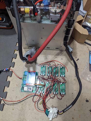

Ok so getting there much closer now and have test setup running on 1 of my banks. The main issue i have is that the leads coming out of the battery module are all the shared wire for balancing so only 9 wires for 8s pack.
I am seeing the voltages wildly swing as hinted that they would when the cell next is being balanced. Is there any way to reduce this without having to pull my modules apart as it will be a total pain to break the modules down to then rebuild back with the extra wire and the existing connectors that are in place dont have the spare pins.
This is the module made up of 48 Headway 38120 cells in 4p 8s all in a nice single contained module. On the wiring loom there are 3 Temp sensors, fan controls and an existing shunt for monitoring.

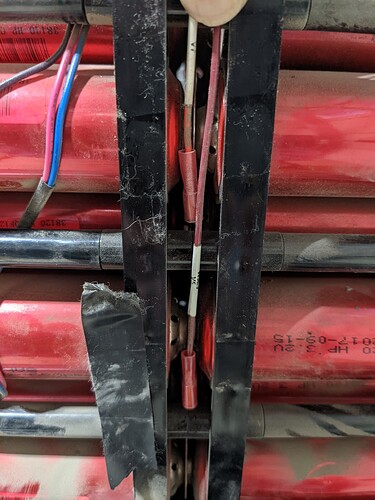

So follow up with my question about needing the 2 wires per cell. Would having 2 wires going in to a single crimped connector be ok? So in this case i have a single flag connector for the BMS connection could i just replace it and put the 2nd wire in there for each of the connections?
This is where the balance leads go in to the center of the packs and they are attached by the flag connectors.
The problem of common wires has been widely described, the increase in resistance in one of them due to the discharge of a module, modifies the reliability of the reading of the next module, initiating a reaction in cascade.
Today the only possible solution is that the wires that go from module to battery do not share cables.
I’m not sure but this problem in Batrium I think they solve it with a different approach to sampling, but it gives me that the creator Stuart, is focused on other more powerful developments and with more functionalities than to consider changing the firm so that it can work with thread shared.
My recommendation, he adds the threads you need so you don’t have to share them.
That is not quite true. The resistance might change by a tiny amount due to the temperature rising due to the additional current (the heating is due to I²R losses in the wire), but the main reason is the increase/change in voltage drop due to the additional current.
