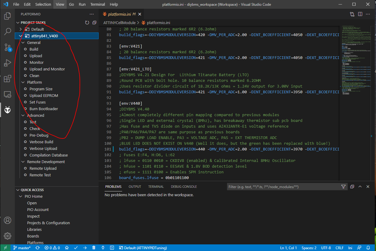

Can anybody help me? I’m very new to platformio…
I’m trying to compile and upload the firmware for the v440 modules. I have followed the steps of Stuart (if I have understood everything correctly… ) but I cannot find the option for the v440 modules, only attiny841_V400.
My Screen:
Stuart:
Well my thermistor resistors are a bit different that original and I need to recompile…
Thanks!.
Edit the platformio.ini file, and remove any of the boards you don’t want.

Solved!
CapturaSI
Just select the appropiate environment on the bottom line…

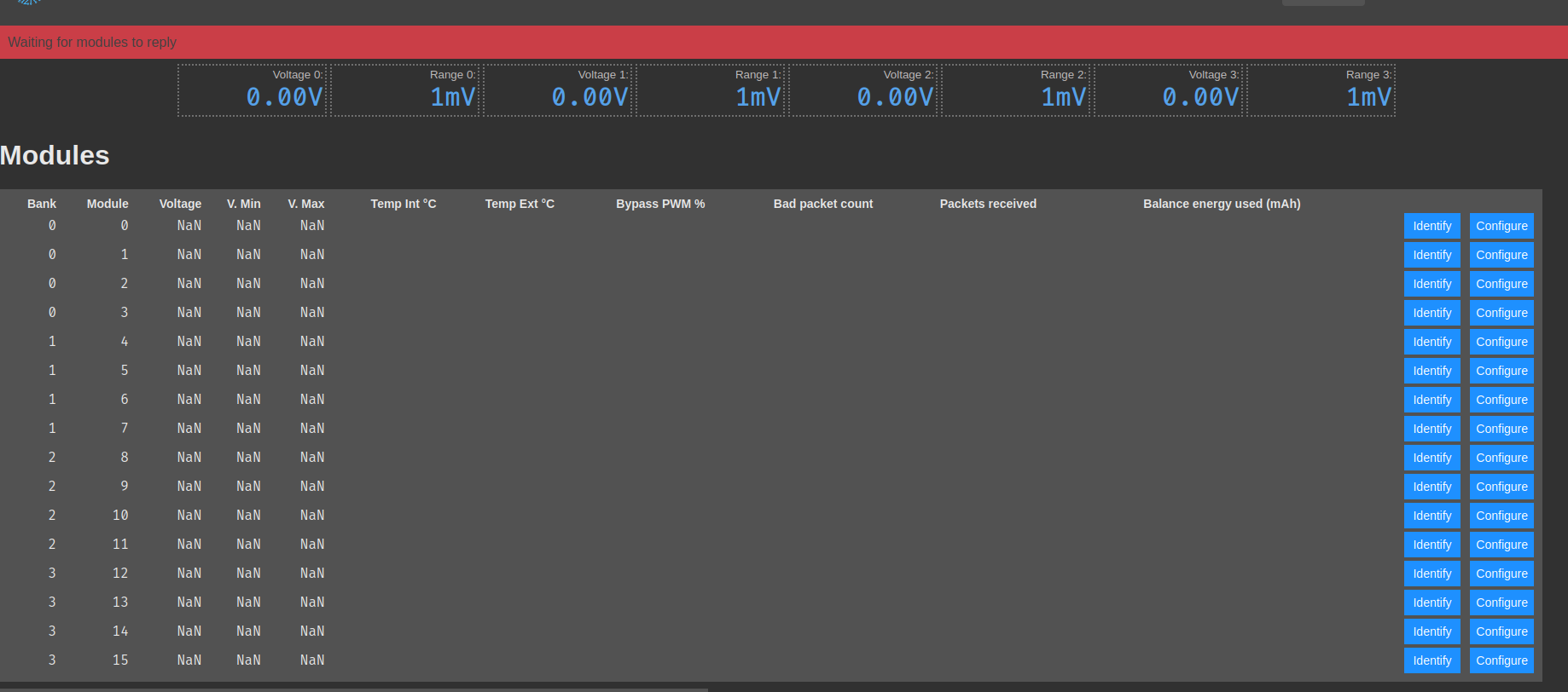

What does ‘Stabilizing…’ mean on the new controller?
The controller is waiting for ALL the modules to reply.
What would be wrong on the new controller to have it permanently stay on ‘Stabilizing…’? I have my old controller connected to my setup and it works fine. The new controller shows all modules in the module list but no data, and no info on the main screen.
The only thing I have not installed on the new controller is D7.
Can you upload some screenshots?
