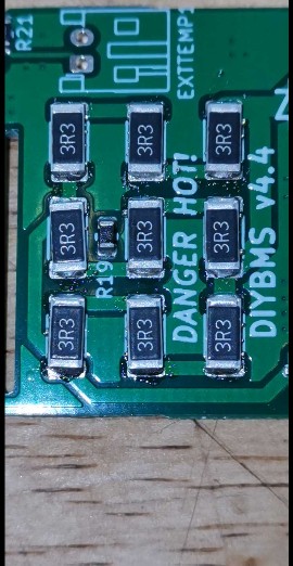

I’ve done on 30 X 4.21 boards the R19, (thermistor 0402 size)
That was difficult.
Biggest work is to make the solder paste dabs.
Then place the components.
Dumpload resistors, 9 of them.
The attiny and challenging, D1.
Not as small as the R19, but still.
Attiny is easy to keep in place, and after the fist leg, a little bit moving hand, isn’t a real problem.
The resistors probably will go easy also, D1… Not.
If I can manage without touching after placing the parts, especially D1, that’s a huge plus.
Soldering the R19 was hard.
When you think it sticks to the board, it sticks to the soldering iron (pointy tip)
Or to the tweezers…
Later I used needle, awg30, that went little better.
Still, often got stuck to that one…

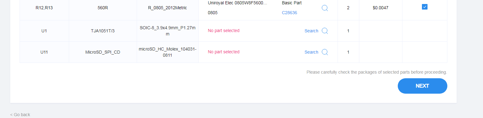

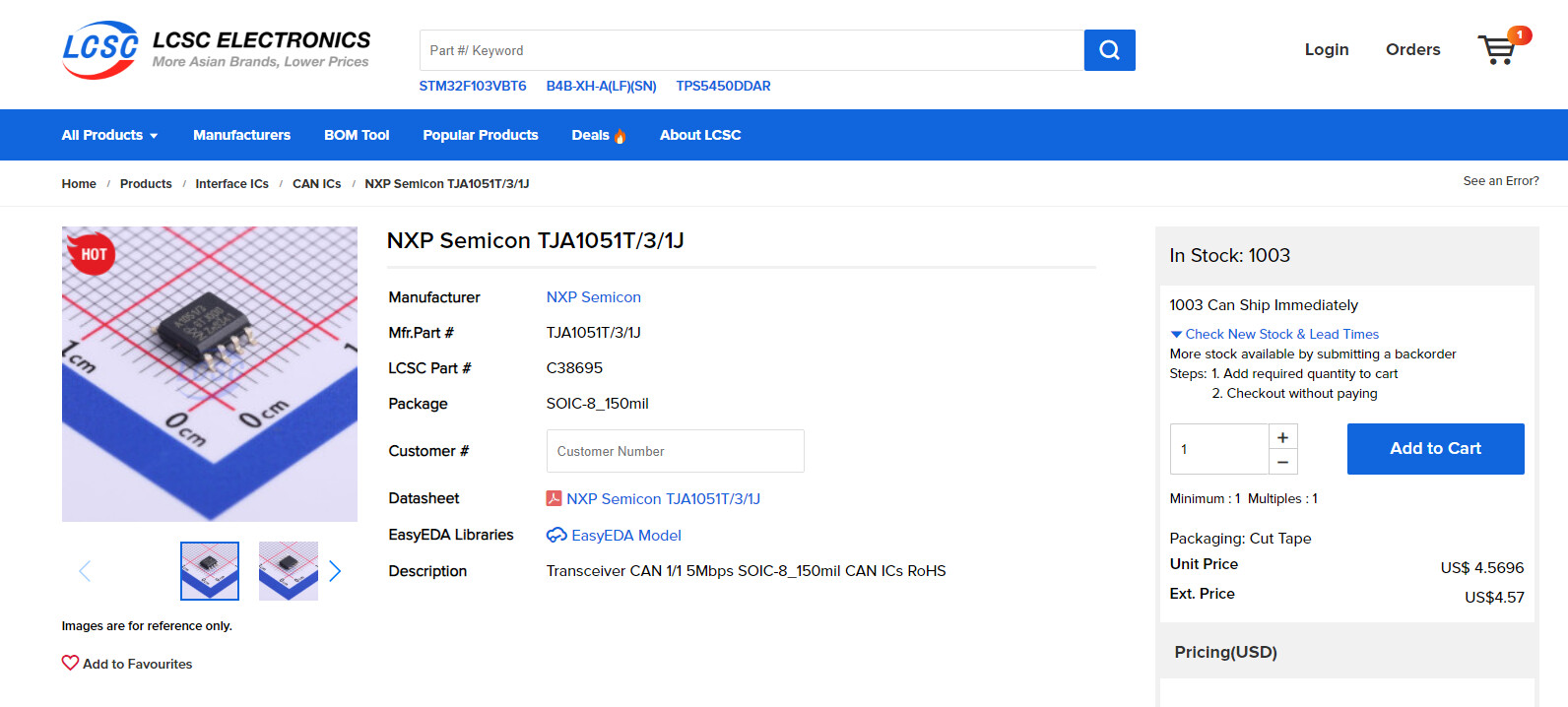

I was trying to order some control boards for the tutorial in Spanish for the new version, but I find that the U1 appears as part not selected. is correct, should this component no longer be put in? there may be some error in the bom or in the cpl file
The strange thing is that if it is detailed now that I look at it both in the bom and in the clp and also if I look for the C38695 component in LCSC although expensive, if it appears, what may be happening
