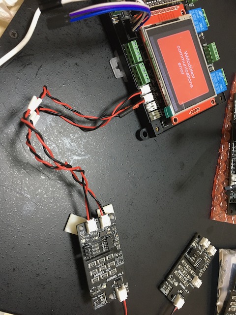

@Vince Lets start with checking a few things.
  • Check the wire from pin 1 goes to pin 1 on the opposite connector on the cable.
  • connect only 1 module to the controller cables go from Controller TX to Module RX and from Module TX to controller RX
Let us know what the result of these check is.
Yes, I think pin correspondence is right. Red to red, black to black on the JST cables.
Only one module is connected and TX1 on the controller connects to Rx on the module. And RX1 to Tx.
By the way, blue LED on the module (I think it is the only one on 4.4 module), blinks twice every few seconds.
Does the LED on the controller also blink? And go in the web interface to Settings, make sure “Number of series cells (eg. 8S)” is set to 1
Yes, the LED on the controller blinks green.
It is set to 1S 1P.
On the terminal, this error keeps on repeating constantly. I don’t not what it means, but looks like an error on the rule settings:
[I][Rules.cpp:133] SetError(): Set error 1
[I][Rules.cpp:133] SetError(): Set error 4
could you make a biger picture of the diode orientation uper the power connector of the module there is a stripe on the diode this stripe should show to the + side of the connector
Communication should work in depended from rules. compiled firmware zip file is a board test, if you load that to the ESP32 and connect RX and TX on the controller you can check if it is the controller or module not working.
I don’t know if it is visible on the picture, but the stipe is on the positive side on the modules I’m testing. I checked it.
Do you know if test code can be flashed with NodeMCU now. From the SD card it doesn’t seem to run.
But it is running the normal code now, showing information on the screen, reading the files on the SD, flashing the LED, running the AVR program apparently with success.
By the way, I have the wrong TCA6408AQPWRQ1 chip that Stuart recently reported. But looks like some others also have it and are not having problems with the communication.
As additional information, I have 2 controllers one flashed with March released firmware, and the other with the April one.
The test code can test the communication circuit of your controller board.

I’m affraid test code doesn’t work. Just the red LED on the ESP flashing. And this output on the serial port:
rst:0x10 (RTCWDT_RTC_RESET),boot:0x13 (SPI_FAST_FLASH_BOOT)
flash read err, 1000
ets_main.c 371
