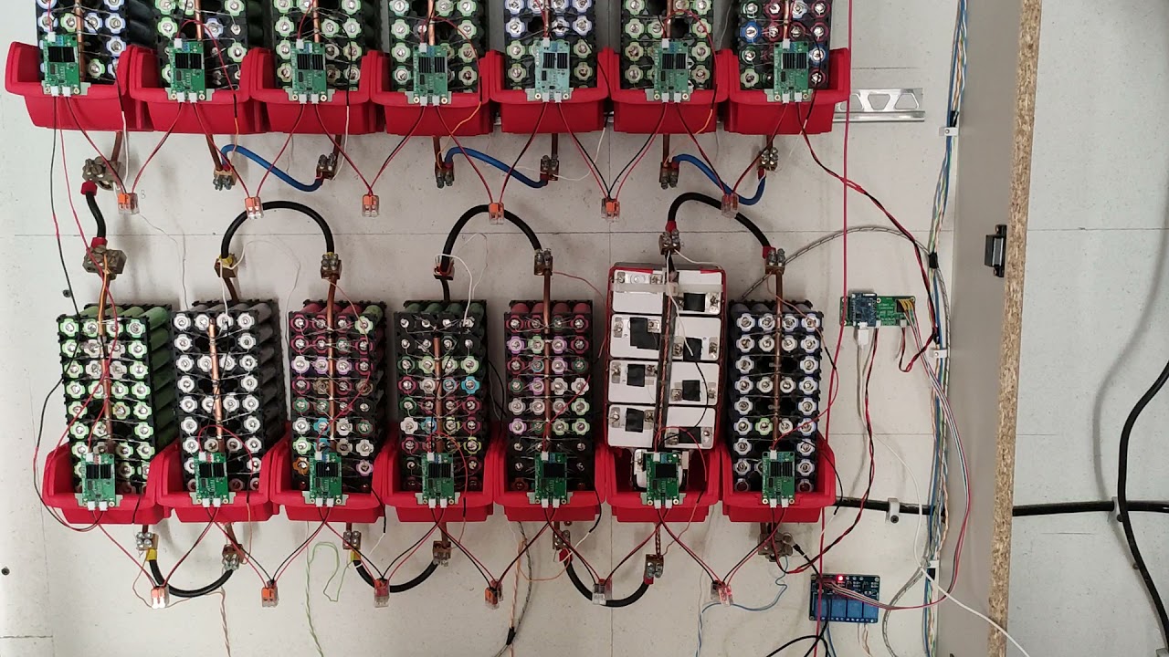

Hi, can someone explain to me why the relay switches again with each pass? This was not the case with the old version. The relay is set to Std, but no matter what I set, it always does the same.
Can you show me the rules page please. Which rule is triggering to do this?
I recorded the video where the Cell over Voltage was over 4030 mV.
I have the same problem with the new controller.
Thatā€™s why I took my old controller.
The modules are updated to the newest version, and so is the controller.
Somehow I have problems with the new version and the relays ā€¦
The reset value should be lower than trigger value on the first rule, the second one is ok.
oh thanks Pablo_montanez, I think Iā€™ve been working too hard these few days. :frowning: I only entered the value 4030 mV to see whether the relay switches and I completely forgot to change the other value. Iā€™m sorry.

Yes, that was the mistake. I donā€™t know why I didnā€™t notice.
Incidentally, all addresses at Grafana have now changed. For the volt display it was 1_1 before the update, now it is 0_1.
