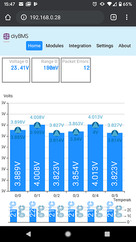

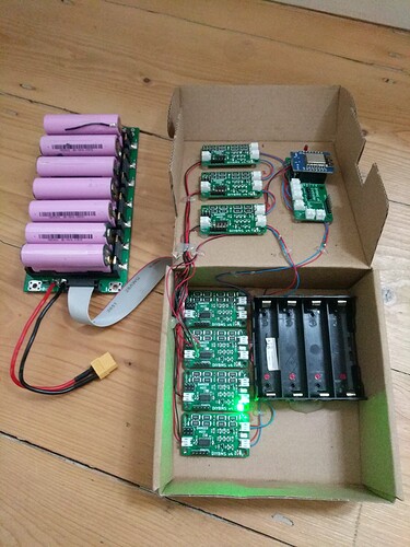

I have my 2p7s pack ready and I was monitoring the cells for the last 2 days with only the load from the Wemos. Today I said to try a load on the pack to see how is behaving and after few seconds one of the cells disappeared from DIYBMS. The strange thing is that all 7 green status led’s are blinking like before but I get only 6 reading bars in DIYBMS software.
I did reset de Wemos and disconnect and reconnect the balancing cable and is still the same. Any ideas what’s not working properly here?
Update: I test the modules by putting the finger on the thermistors and the module that is not showing up in the software is number 7, I took the battery out I get a communication error of course and I put it back everything is blinking properly but the software is not showing the cell no. 7.
Second update: I powered the Wemos from a power bank and I get a error now, I think a kill module no. 7. How I was powering the Wemos during the test was from the most positive and most negative of the pack, around 28V through a 5V recom regulator that can have a max of 32V input.
Final update: I took out module 7 and is dead, the green led is always on, this is not normal because after I first flash the modules and connect a battery the led is flashing once and that’s all. I think the 841 is dead.
Final conclusion - use a different power source for the Wemos.

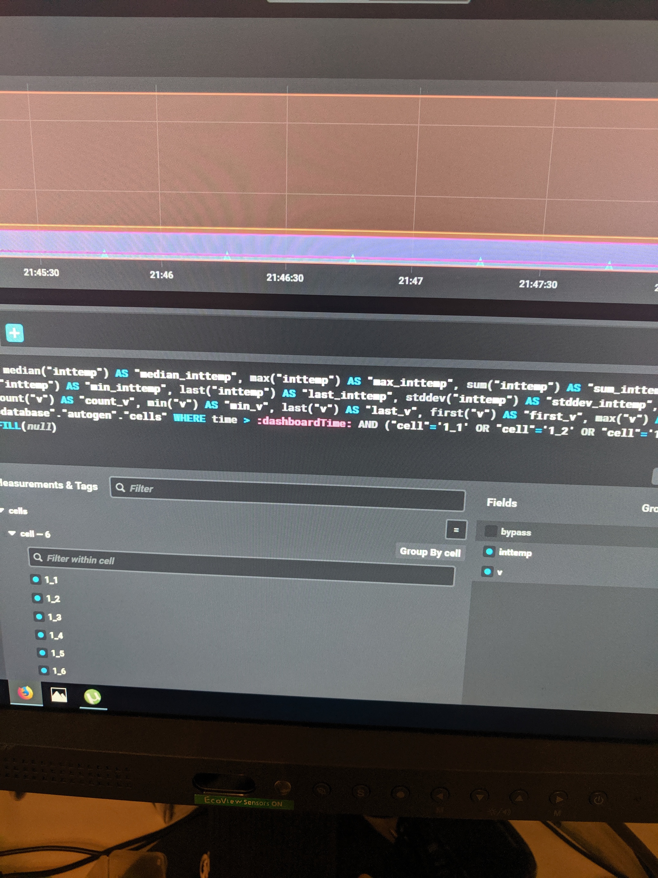

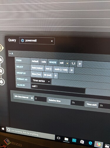

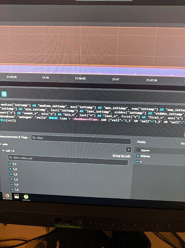

I finally got my Raspberry running home assistant and I install InfluxDB and Grafana.
First I create in InfluxDB a database “DIYBMS” and a “user” with password “test” and I give it all permissions.
Aftert that in DIYBMS in the integration tab I enable influx database: host server: 192.168.0.33 (ip of home assistant) / port: 8086 / database name: DIYBMS / username : user and password : test
In the Grafana I create my InfluxDB database “powerwall” with url://192.168.0.33:8086 / aceess :ver (default) - InfluxDB Details / Database: DIYBMS / user: user / password: test / HTTP method: get. Save and test was successful.
I crate a visualization but I don’t get any data in.
What I did wrong?
This is from InfluxDB, I have only 6 cells left because yesterday I kill one module and I’m getting something and the second image is from Grafana.
