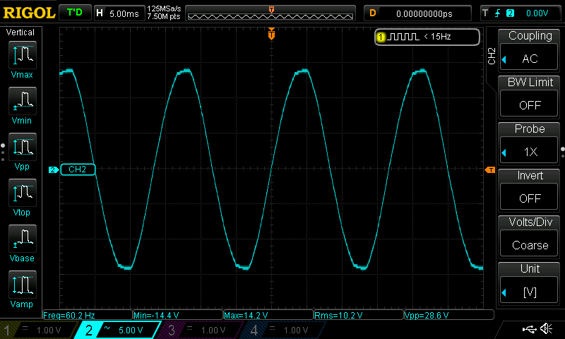

So my AC-AC adapter arrived. I’m not getting the values I’m expecting so I’m goofing something up. I’m going to share a whole bunch of information and if you spot anything wrong, feel free to tell me I’m an idiot so I can fix it :smiley:
Here’s the AC-AC adapter datasheet. I’ve extracted the specs I think are needed:
https://www.jameco.com/Jameco/Products/ProdDS/112336.pdf
I measured it with my scope:
With 117.4V input, it outputs 10.2 V RMS whether unloaded or connected to my measuring circuit. My measuring circuit looks like this:
link to circuit: http://tinyurl.com/yufs6emu

AC-AC Adapter:
Rt = 120 ÷ 10.2 = 11.76470588235294
voltage calibration constant = Rt × RD
10.98996990972919 x 11.76470588235294 = 129.2937636438728
Using 129.2937 for VCAL and 1.7 for PHASECAL I’m calling calcVI to measure 60 crossings with a 2000ms timeout.

Those are the numbers you should have used in
but this always assumes your multimeter is 100% accurate. Agreeing with your Killawatt on one range doesn’t necessarily mean it’s right on every range - this goes for the resistance ranges too. But this (2.4%) doesn’t explain the 15% difference in the calculated Vcal values.
Is 997 Ω the value you measured for this one resistor? If so, it’s not the number to put in
because it has 2 × 10 kΩ in parallel with it (YES! - the 3.3 V supply is a short circuit to a.c.), so the value is nearer 831 Ω if you ignore the 10 µF, which makes quite a difference. And when you don’t, the 10 µF is 318 Ω at 50 Hz, 265 Ω at 60 Hz, so you have two steps of division there, the 10 kΩ and the 997 Ω, loaded by the 265 Ω of the capacitor and the 5 kΩ of the two 10 kΩ in parallel
Time to do the maths again. :laughing:
At the end of the day, if the power agrees with your supplier’s meter then as I’ve written before, it’s correct even though it might not be (because they never admit their meter is wrong unless it’s badly wrong).
It should never exceed 1.0 But the same voltage is not used for the two calculations, and the phasecal algorithm slightly distorts the voltage value, hence you can get a p.f. greater than 1.0 If you have loads none of which have a poor power factor, you’ll probably never notice the difference. If however you have a very low power factor load on its own, then you should adjust for the highest p.f. even though it is greater than 1. (If you really know what you’re doing, adjust for zero p.f. with only a capacitor as the load - but DON’T try it unless you are absolutely certain it will be safe, it’s inherently dangerous unless the capacitor is the right sort with the right voltage and current ratings.)
