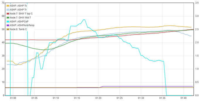

You could maybe use an EmonTH with one or two ds18b20 probes on it??
To not get up to 48°C in 1hr 20min seems suspicious - like the 3 way valve is passing and some of the heat is being delivered into the heating
Or is it hitting the 90min limit in the controller?
The Carnot COP for when its heating from 25-50c is about 43% . that is only a little bit low. (Mine is around 46%). Heat output 5.5-6kW.

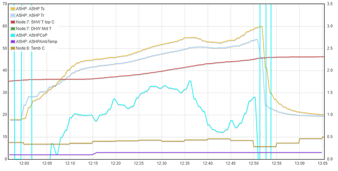

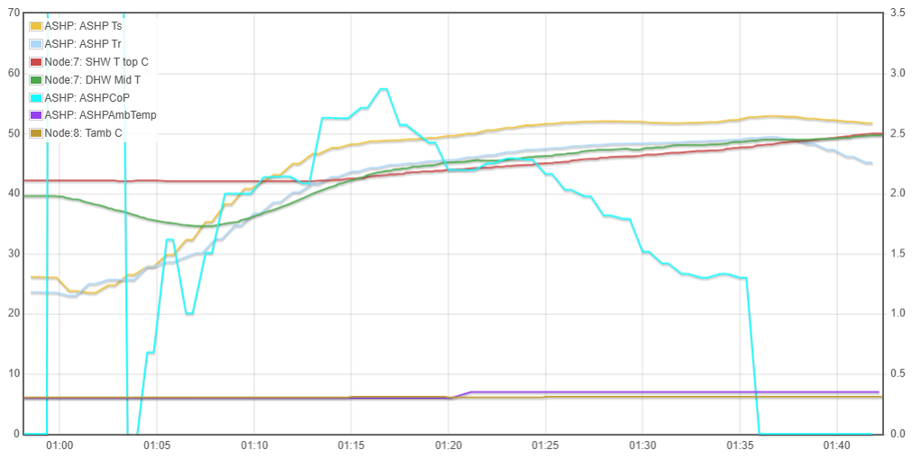

@ajdunlop I occasionally have the same problem as you, but not quite so dramatically. A week back I decided to move the temperature sensor to a different pocket on the tank; it didn’t make any difference, but then I realised that the installer had not pushed it all the way in originally and had then put a cable tie on which meant that I couldn’t push it all the way in either. I’ve now rectified that and I’ve added some heat sink compound to the sensor. The result has been dramatic in the change in reading and the speed with which the sensor now picks up the rise in tank temperature. I’ve done the same with my other tank sensors. You can see that I got an instant increase in measured temperature of nearly 10C and that the ‘mid T’ (which is actually located about 2/3 of the way up the coil) now sits with the top C. The ASHPTDHWTemp probe is in the same pocket as the top T sensor, but I only read that from the API every 15 mins.

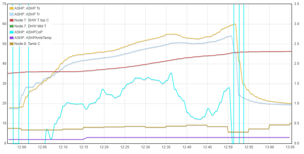

This image is from before I fixed the temperature sensors and you can see the CoP drops below 1 , 40 minutes in. Overall the temperature rise here is about 10C over an hour.
This image is from the new sensor arrangement. It’s a slightly lower temperature rise of about 8C, but it does it in about 30mins. The CoP is much higher (slightly higher ambient) and there is no collapse below 1.
Now I’m going to disappoint you by saying I have seen it do the weird stuff since, but only once so far and that was a 3C night run. You noted that it does it more in ECO mode, so if the problem is that the ASHP DHW sensor isn’t getting an accurate reading, that could be a problem (more in ECO than NORM) because it’s possible that the ASHP isn’t ramping the flow temperature fast enough - i.e. the tank temperature is getting to the point where it’s possible that the bottom part of the coil is putting heat into the tank and the the top part is taking it out again!
I don’t think it’s going to solve the problem completely, but just making sure those sensors are pushed fully into the pockets and ideally putting some heat sink compound on them might help (if you’ve not already done that).

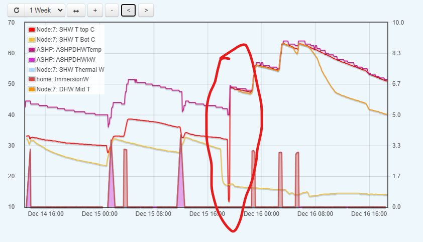

@Rachel after your post I put some paste on the lower sensor that is used by the Ecodan when heating up. However I have since had another bad DHW warm up.
I did also put paste on the flow and return sensors connected to the FTC. This looked like it does make a difference to how quickly these sensors change with changing temperature and much more closely match the in pocket sensors of my EmonHP. This has allowed me to remove the adjustments I had applied in the FTC settings.
I think this might help the performance generally but the dips are still happening when the outdoor temperature increases and the heat pump is trying to reduce down the flow temperature. It looks like the dips are more likely something to do with the control of the expansion valve or the refrigerant temperature sensors.
I really think installers should really always be installing the flow and return sensors in pockets or there could be all sorts of performance issues caused by saving a few minutes and pounds.

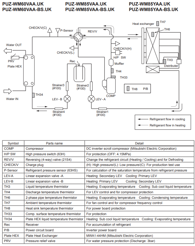

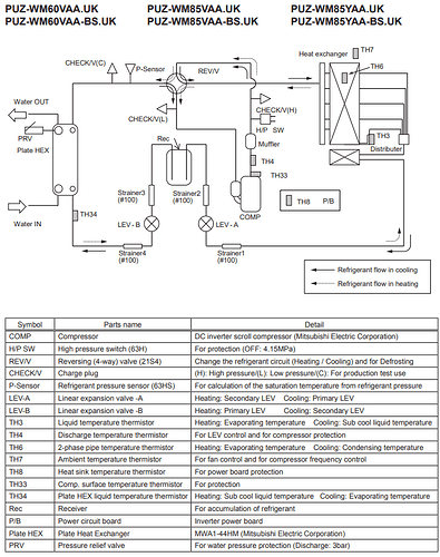

The CN105 work done by @gekkekoe and @F1p now means that it is possible to read and log out to Home Assistant or elsewhere the values that can be accessed from the ‘Running Information’ on the FTC.
This includes Fan Speed, LEV A pulses, readings from TH4 (discharge temperature), TH3 (Refrigerant Liquid Temperature), TH6 (2-phase Temperature, TH8 (Heatsink temperature) and TH32 (Supercool Temperature).
I don’t know if this will be helpful for looking at some of the strange behaviours we are seeing with our units.
The resolution is fairly low but I believe can be increased but I’m not sure what the limitation on this is.
It’s possible to get LEV A,B & C if required - initially i was awaiting feedback as to what parameters are of most interest/use and at what resolution.
Then the refresh rates can be optimised to match
Keep in mind that polling a service code cost around 5s. It’s quite expensive. Subcool and superheat can be calculated, so I did not retrieve them.

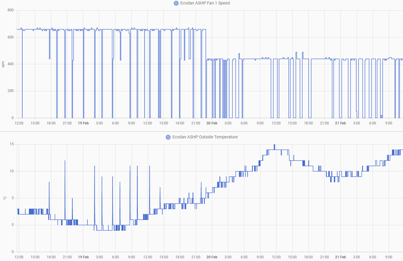

I’m in the level 1 Quiet Mode on my Ecodan R32 8.5kW with FTC6 and it looks like the fan speed drops from about 660 rpm to 440 rpm at 6°C:
This seems like a very arbitrary way to control the fan, surely this could be more fine tuned to the refiguration cycle as I assume depending on the unit location, how iced up the evaporator is etc different fan speeds would provide better performance?
Also from a noise point of view 660 rpm is much noisier so I’d have thought gradually increasing the speed would be better.
At some point when we are back under 6°C I’ll try switching between between the Quiet Mode levels to see if the max fan speed is varied.

@johncantor what do you think are the most useful things to measure?
@F1p I’m finding the resolution a bit low apart from on TH3 where you’ve increased it. How many other sensors could be read at that resolution before it would start to be an issue?

I’m no expert but the ones that I think are most important are TH3, TH4, TH6, TH34 and LEV A and maybe B.
I don’t know where LEV C is I assume my model doesn’t have it.
Not sure other sensors like TH8 or TH33 matter unless there are particular issues of components overheating.
Fan speed is interesting but doesn’t very a whole lot so this could remain low frequency.
