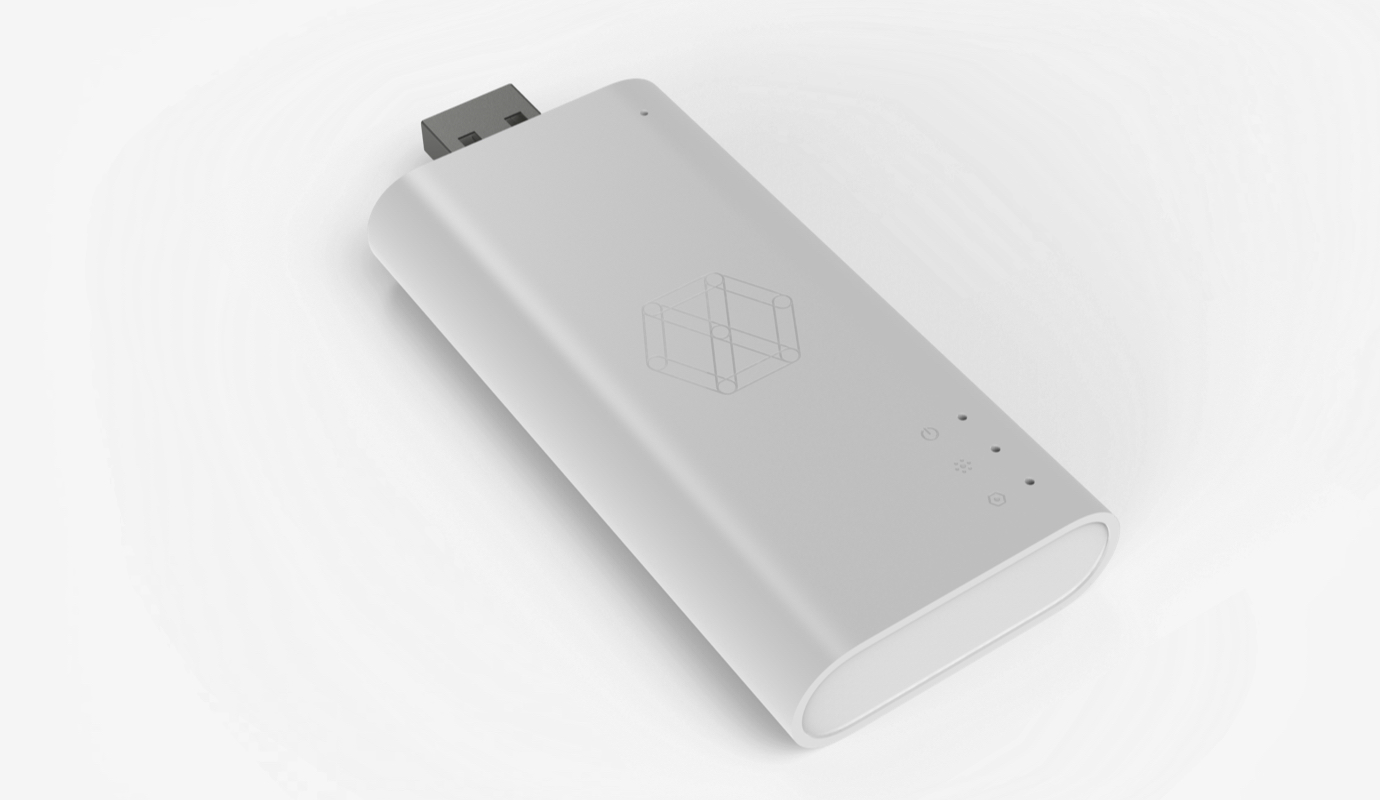

I’ve installed a device to capture SMETS1 smart meter data every few secs
https://www.hildebrand.co.uk/our-products/glow-stick-wifi-cad/ 12
It’s USB powered so I just stuck it into a Raspberry Pi (just for the power/no data flows) – very convenient.
The Hildebrand BRIGHT mobile App provides comprehensive smart meter data updating about every 6 secs.
