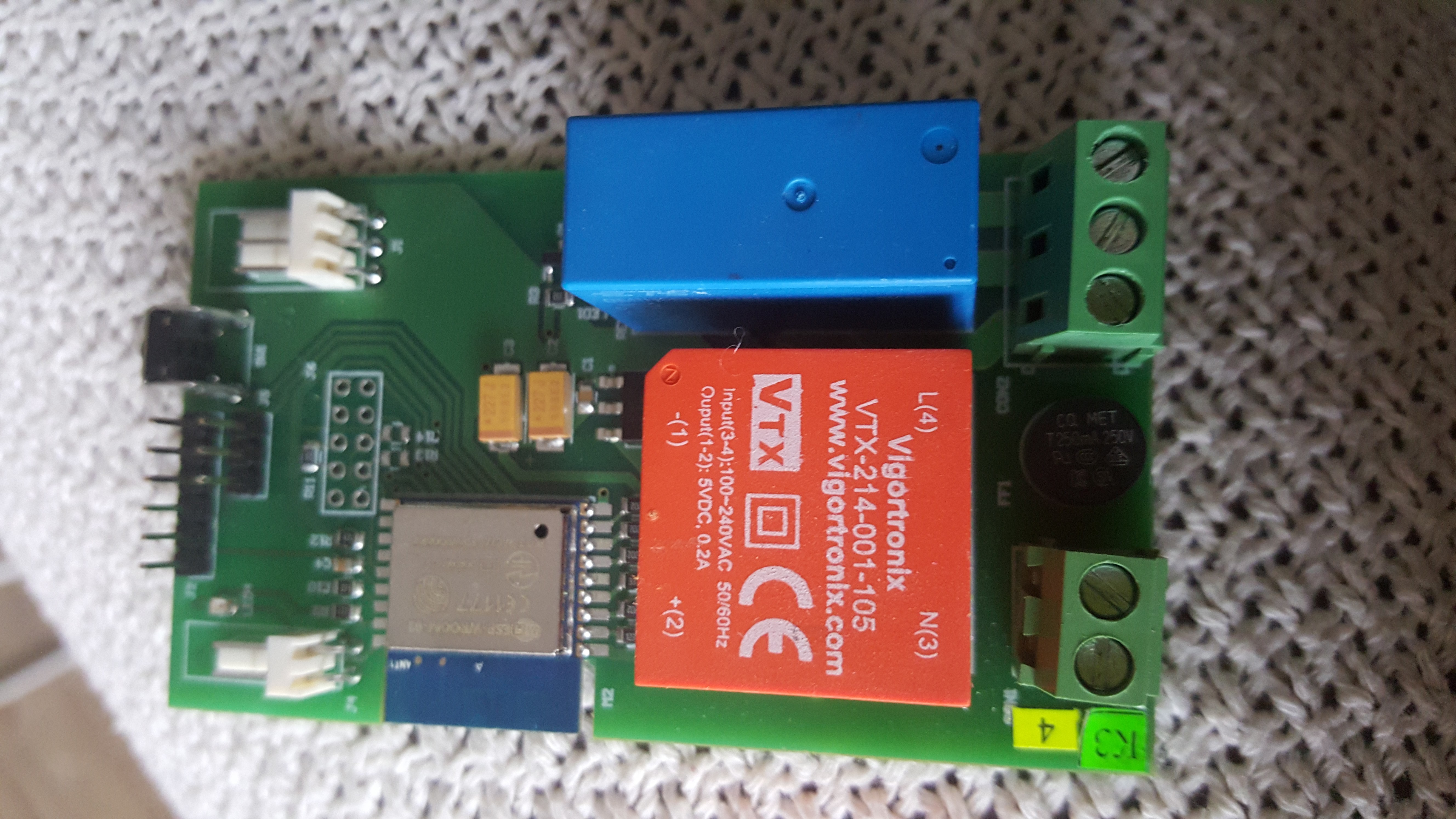

I have installed 3 wifi relay devices in a installation.
Everyone works fine for 2 or 3 switches, but then they stop to work.
Led light still working, and wifi menu and it is not burn.
Supply voltage is 250V (three phases installation), and I disconnected them and reconnected in a 230V but they don’t work.
I can hear relay opening and closing but really really quiet (“click”)
I don’t know how to solve it, if I change the relay or not, and why happend that.
The relays lines are for lighting and no more than 10A, so I discarted over amperaje.
Any help?

**Author:** ![bernamorillo](https://community.openenergymonitor.org/letter_avatar_proxy/v4/letter/b/0ea827/32.png) [@bernamorillo](https://community.openenergymonitor.org/u/bernamorillo)\
**Post date:** [1 August 2016 16:29 UTC](https://community.openenergymonitor.org/t/wifi-relay-three-phase-power-supply-problem/1153/7 "2016-08-01T16:29:21Z")
Very close pictures of one of the wifi relays boards. In my opinion are totally perfect.
 ![](https://community.openenergymonitor.org/uploads/default/original/2X/2/2d74a8221ac09958b62b9f4da442c5c14457f177.jpg)
**Post date:** [1 August 2016 16:30 UTC](https://community.openenergymonitor.org/t/wifi-relay-three-phase-power-supply-problem/1153/8 "2016-08-01T16:30:04Z")
![](https://community.openenergymonitor.org/uploads/default/original/2X/1/1ed544bcaf9ac45a450bd25ca012d43f5d08394e.jpg)
**Post date:** [1 August 2016 19:23 UTC](https://community.openenergymonitor.org/t/wifi-relay-three-phase-power-supply-problem/1153/13 "2016-08-01T19:23:30Z")
Finally the problem is related to power supply.
With FTDI 5V supply they work perfectly. Maybe one of them have one second delay, but it is reasonable
Finally i will solve my problem including a external power supply of 5V in order to avoid over voltage and wiring at 5V, I prefer that in fact.
I recommend Martin to develop one relay with only 5V supply, it is easier to solve and probably it will be cheaper and thinner.
Thanks for all
I will send more info with the final solution and tests.
