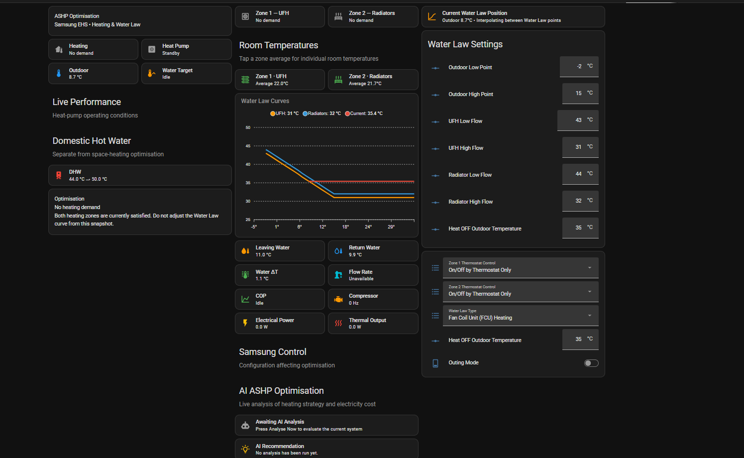

Hi all, just wanted to revisit this and also thank @pantherale0 and @SarahH for their advice and input. I have a samsung joule gen 5 system with a 9kw machine. I am a big fan of home assistant and for years i envied everyone else with newer set ups and proper home assistant integration but i found it all a bit daunting. Turns out nowadays given a lot of work by various people @pantherale0 included its pretty easy.
Hardware i bought was an atom m5 stack - Amazon.ie
and paired it with this RS485 convertor which i had to order from ali as i couldnt source locally https://www.aliexpress.com/item/1005003297531645.html?spm=a2g0o.order_list.order_list_main.10.315218026pOLlb
The worst part was waiting on that to deliver. Then all i needed was some cat 6 cable which i stripped and took the strands out from and connected the device to the V1 and V2 and F1 and F2 screws on my control board (which for my unit is in my hotpress with the cylinder rather than on the ASHP itself). The atom connects to my network wirelessly and once i flashed it with this yaml i was good to go.

Then i loaded this integration GitHub - pantherale0/ha-samsungehs · GitHub created by @pantherale0 and i could see lots of data about my system immediately.
For my device i was missing some of the parameters of interest to (water law for rads for example and a few other bits) but with the help of chatgpt i was able to add them in via messing with a few files from the integration.
Dash needs work but currently looking at this to set up optimisation with an AI helper that i need to code in!
One thing i have noticed and i am not sure if its a limitation of my system or if its a change i need to make to the integration but i do not get any data re flow rate, power consumed or thermal output which will make COP tricky! if anyone knows any more on this let me know!

I will have another look at the message IDs, might be that it is missing some for gen 5 or it needs to be actively polled.
thanks a lot, if i figure it out in the meantime i will post back
