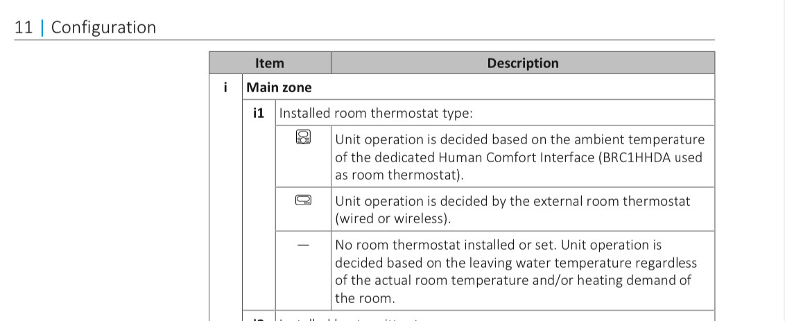

Daikins can (generally but don’t know about yours specifically) run in pure weather compensation mode (called leaving water temperature on Daikin controller FYI)
What is the wall stat? Hopefully it’s the Daikin Modoka 🤞🏻 as 3rd party stats are known to be problematic.

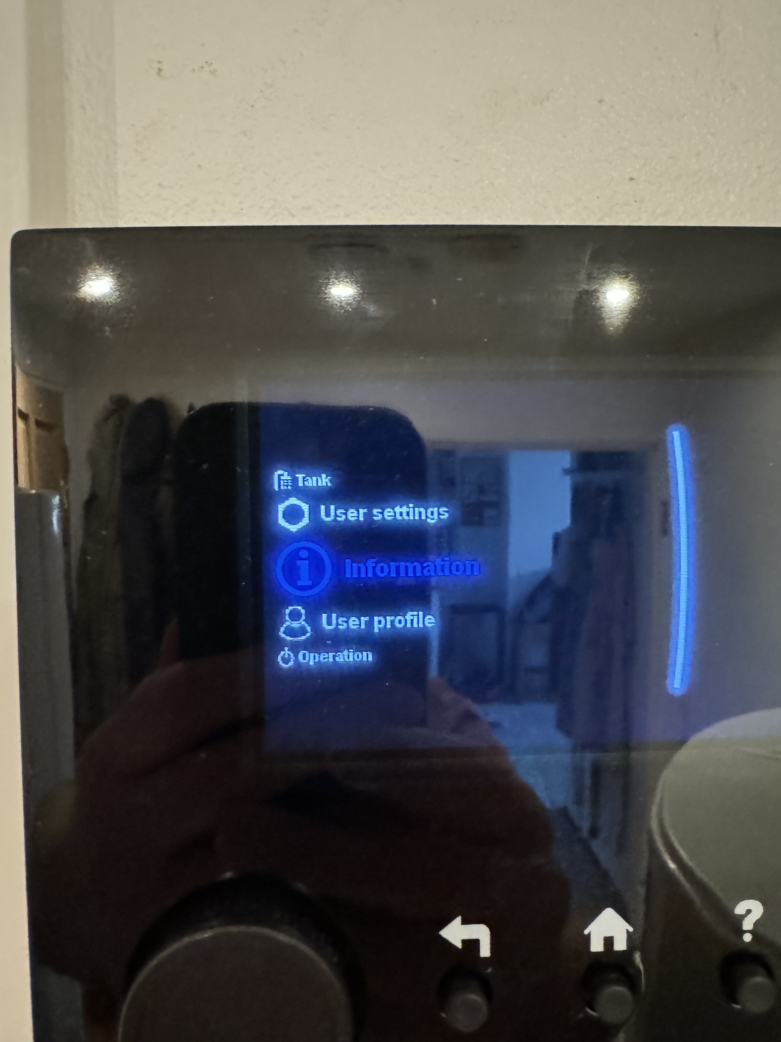

Can you go into the menu and let us know the input (electrical) and produced (heat) energy values for hot water and space heating separately?
See here for example. Assume you have the same controller fitted somewhere?
 ![IMG_7819](https://community.openenergymonitor.org/uploads/default/original/3X/0/8/08fc93d5d55d4acfa380de272d7afa512c33b32a.jpeg)
 ![IMG_7790](https://community.openenergymonitor.org/uploads/default/original/3X/6/8/6875587f71fa013a482c2b6bee17b44eab714add.jpeg)
TRVs should be used to control solar gain for example on that point - so needs to be an exception to the first line at top of this post.

![IMG_7858](https://community.openenergymonitor.org/uploads/default/original/3X/3/c/3cd436a1ccd392a78b62c5038ac0382012fdcf09.jpeg)
Not at home, but under Installer profile (5678) select Main zone—\>Control
Select leaving Water.
I’m not in front of the controller, so that’s from memory

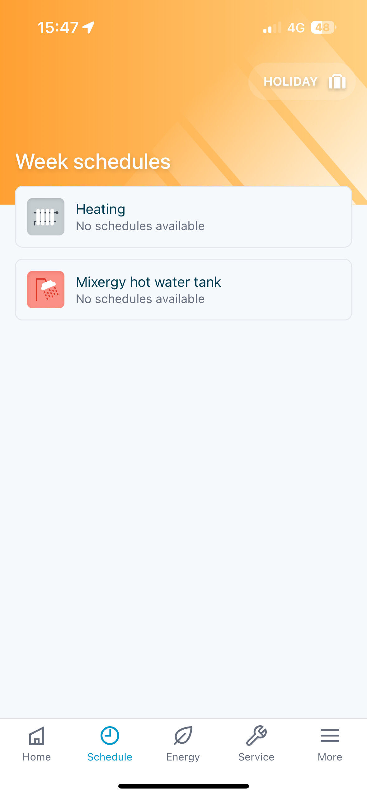

You can tell from the mobile app when in pure weather compensation (leaving water control) as there is now a manual flow temperature offset adjustment, and heating schedule ability is lost in the app (can only do schedules on the Daikin controller - and is flow temperature offset from the curve)
 ![IMG_7865](https://community.openenergymonitor.org/uploads/default/original/3X/4/4/44a86bf3a5de17bf65b587c60147c86b67a75649.jpeg)
 ![IMG_7866](https://community.openenergymonitor.org/uploads/default/original/3X/6/d/6d76ca7e5b359ba7e42c0ed017b249081fcc8b51.jpeg)

**Author:** ![Hammerd2](https://community.openenergymonitor.org/letter_avatar_proxy/v4/letter/h/e9c0ed/32.png) [@Hammerd2](https://community.openenergymonitor.org/u/Hammerd2)\
**Post date:** [11 November 2023 16:16 UTC](https://community.openenergymonitor.org/t/wd-curve-scheduling-daikin-altherma/24744/12 "2023-11-11T16:16:31Z")
Yes I have this now on the app.
In the schedule then it offers the offset at various times so it’s +/- 10c from the temp on the slope right? So if I want it cooler overnight set 22:00-02:30 at, eg, -5, then +5 for getting warmer for waking up.
Is that about right?
**Author:** ![Stephen\_Crown](https://community.openenergymonitor.org/user_avatar/community.openenergymonitor.org/stephen_crown/32/26680_2.png) [@Stephen\_Crown](https://community.openenergymonitor.org/u/Stephen_Crown)\
**Post date:** [11 November 2023 16:41 UTC](https://community.openenergymonitor.org/t/wd-curve-scheduling-daikin-altherma/24744/13 "2023-11-11T16:41:57Z")
Spot on 👌🏻

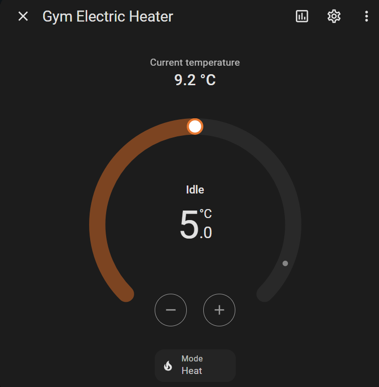

I could stay on LWT, but I could use Home Assistant and a generic thermostat with my own external temp sensors taking an average downstairs temp rather than one single point in the house (inc the madoka, ESP’s etc), it’s on/off but can set my own hysteresis to help with overheating at milder temps.
2nd question what strategies do you employ?
eg in my Gym '‘Generic Thermostat’, but with an electric heater -
 ![image](https://community.openenergymonitor.org/uploads/default/original/3X/9/f/9fc8b2ed11a5131399cd04e963ae4702db6d06b0.png)

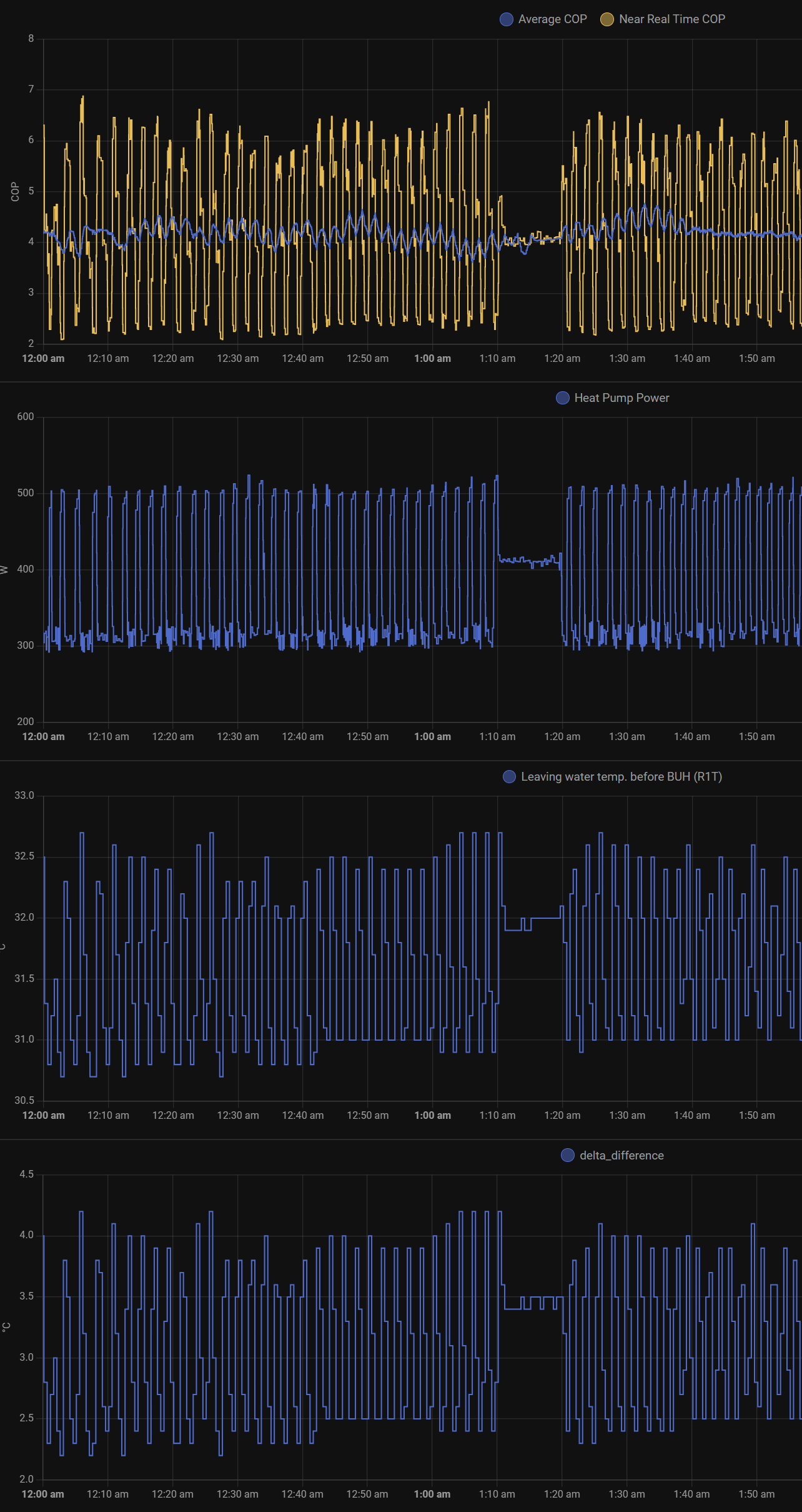

Yesterday i just turned off the HP as the house was 23+; took a different approach to overheating; I have now started to reduce the output of the radiators by balancing to the LWT of the emitter rather than a specific DT and a room comfort level, the COP has taken a little hit…, the house is still a bit hot, but i think it may take a few days to dial in (loose some heat from the internal 200 year old stone walls) and we are now in a colder period, any advice would be appreciated. thankfully i have the 8kW unit so it can modulate down.
One annoyance is the power flutters that adds variance to the COP calculations, i take a five min average to see the wood through the trees – power varies 300w – 500W the result DT2.5 – 4, LWT 31-32, I am not sure how to smooth this out with configuration or emitter tuning.
One hack i am implementing, I go around with a drywipe pen and write on the DT and leaving water temp on each rad so i have a reference.
One challenge i have is the upstairs radiators are oversized!
 ![image](https://community.openenergymonitor.org/uploads/default/original/3X/f/f/ff5377d866eb8ba8731f9e96bd22f67aabebf1b9.png)

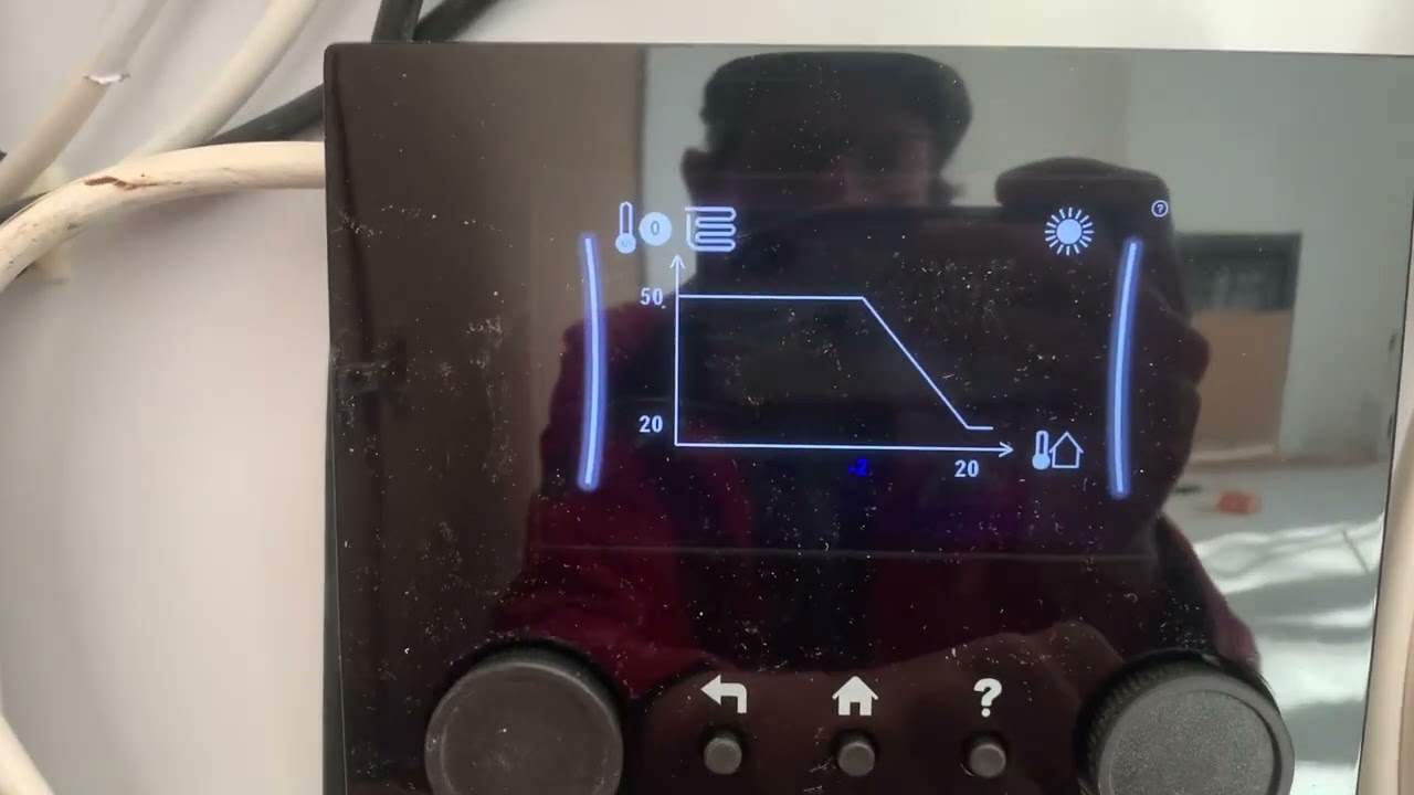

\*\* UPDATE \*\*
I have smoothed out the HP - I needed to balance a bathroom radiator/towel heater, ie ‘all’ rads
 ![image](https://community.openenergymonitor.org/uploads/default/original/3X/c/f/cff1732c75d0a27528f3e05d661164a167fbc406.png)
\*\*UPDATE 2 \*\*
no its back after a DHW cycle ☹
 ![Screenshot 2024-12-04 090459](https://community.openenergymonitor.org/uploads/default/original/3X/d/7/d77f57e9b143f25ee3962589dfa1775c221e9de1.png)
