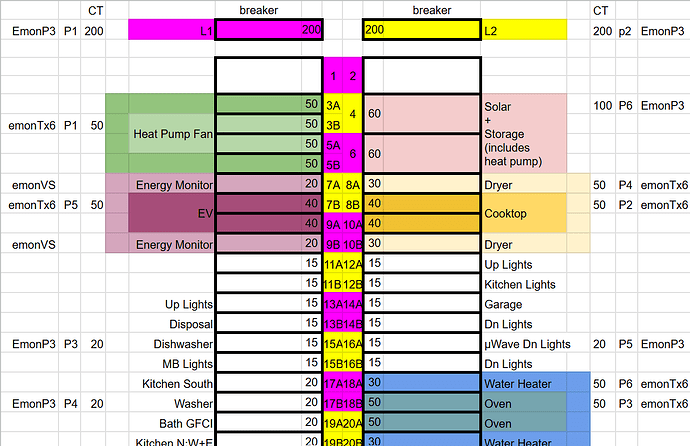

The question here is, why is the sign wrong on power and energy?
In my new installation (7 Aug 26), it would be good if my water heater generated electric energy, but I am too addicted to reality to think that this is happening, despite living in California (read split phase).

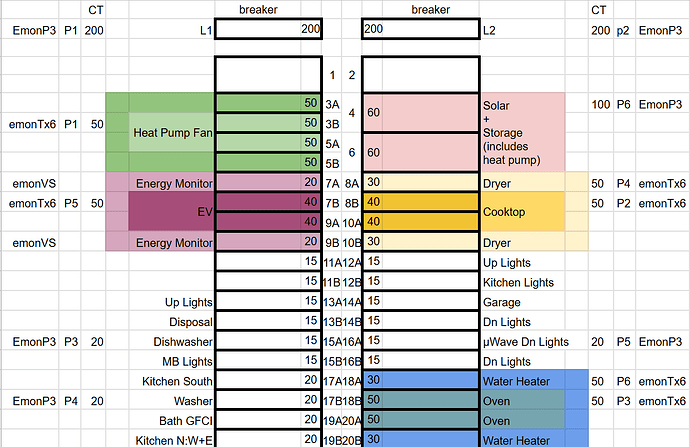

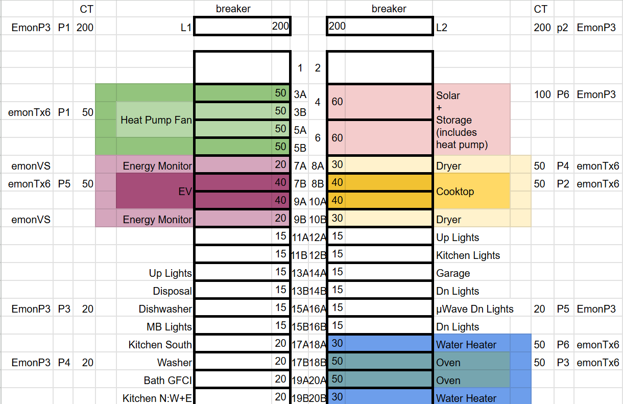

How the panel is wired:
The two 200A CTs are in the same direction with the wire side going towards the breakers and away from the grid. All other CTs are with the K side nearer the breaker and the L side at the load. Double and triple checked.
I put the water heater CT on the same wire as the oven ct. On the Setup–>Inputs page I see the P3 Oven with 1690 and the P6 Water Heater with -1355. I swap the CTs on the emonTx6 and the result is ~the same. That is, the problem seems to be with P6 of the emonTx6.
emonTx6-P2 Cooktop, and emonTx6-P4 Dryer, see the same behaviour,
P2, P4, P6 but not P1, P3, P5
Why is your emonVS shown connected to Leg 1 twice, on circuits 5 & 8? Surely, the “L2” input of the emonVS should be measuring Leg 2 of your supply? Or is this a typo, and you forgot to change one of those lines on the spreadsheet?
See Use in North America — OpenEnergyMonitor 0.0.1 documentation. Note the emonVs L2 input (V2) is connected to L2, not L1 as your spreadsheet says.
This points to an error with how the pairing of each current channel to link it to the correct voltage channel is set up for split-phase systems. Can you check this? The emonVS gets its operating power from L1, so if you pull the fuse or trip the L2 breaker feeding it, all the powers for circuits on L2, and only those, should go to zero. You have no 240 V circuits?
The pairing is done in the emonTx6 itself. You can check this by going to emonCMS Admin → Serial Config and connect to the emonTx6. Confusingly, this page seems to imply, with the choices available for V Chan 1 and V Chan 2, that every load is connected Line – Line (in your case, 240 V), and doesn’t make it clear what you have to do with a load connected Line – Neutral. In fact, you must put the same number in both boxes - 1 for a load connected to Leg 1, and 2 for a load connected to Leg 2. Having experimented, I think what you have here might be wrong.
If not, check for the silly mistake - make sure you have not slipped a minus sign into the calibration constants somewhere.
I don’t know what this means and can’t check it, because all I have for this item is the data sheet, and this gives no phasing information. But if the two incoming powers are positive when you are consuming, they are correct.

200A CTs My panel is not CT friendly for monitoring the grid. I put them in they way the fit and apparently, the wrong direction. I’ll sort this out once I get the pairing sorted.

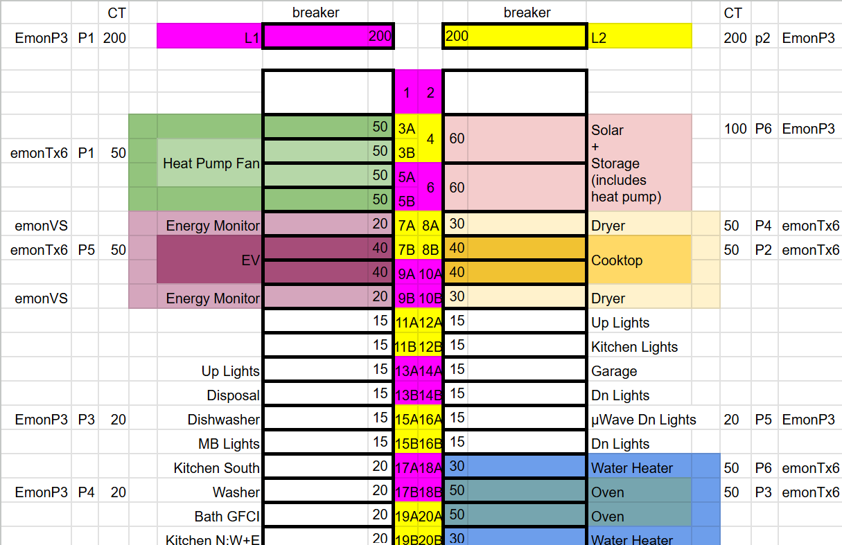

Notes an North American panels
(bottom line: the emonVS is correctly connected)
North American panels are complex because of the split phase. Here I have highlighted how the phases connect to the breakers. The phase connections go down the center and are interleaved. The emonVS is connected to the outside two-pole (one pole trips, the other also trips) of a quad breaker (the EV connects to the inner two-pole) One leg of the emonVS is connected to L2 at point 7A and the other to L1 at 9B.
The grid comes in at L1 (pink) and L2 (yellow). Breakers connect to a phase buss bar. Load connects to breaker
Sort of like navigating Heathrow.
There are two ways to fix this without touching the c.t’s: swap the wires at the plug end (it’s quite safe to do this without removing the power, just unplug them, and it won’t hurt if the wires are shorted while you do it), or if there is no connection to L3 of your emonVs (and this was never intended in the original design :wink:), put the number 3 for V Chan 1 for both incomers, leaving V Chan 2 at 1 for the one on Leg 1 and 2 for the one on Leg 2.

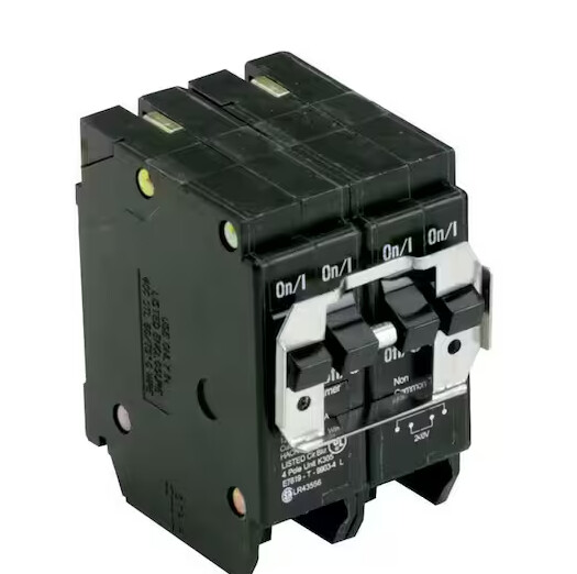

That’s not how I understood it, and not how I read your table. Maybe a proper single line diagram would have been better?
I have to say I’ve never come across a linked breaker quite like that one. Yes, for 3-phase operation we have 4-pole, or rather 3-pole & neutral, with all 4 poles linked but with overcurrent only on the 3 line connections.

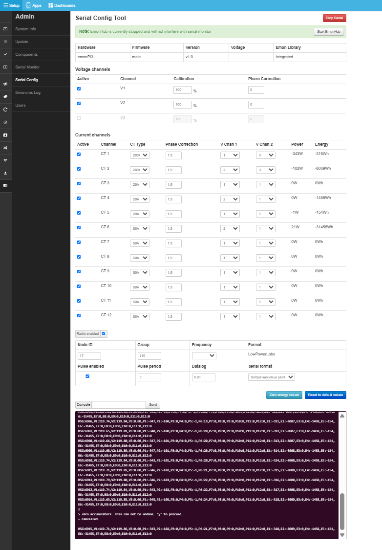

This is what I see now.
I’m a bit confused. There are has 12 ct’s The Hardware is emonPi3. I don’t know how to display the emonTx6. How is this done?
I made the effort to flip the L1 and L2 CTs to avoid confusion.

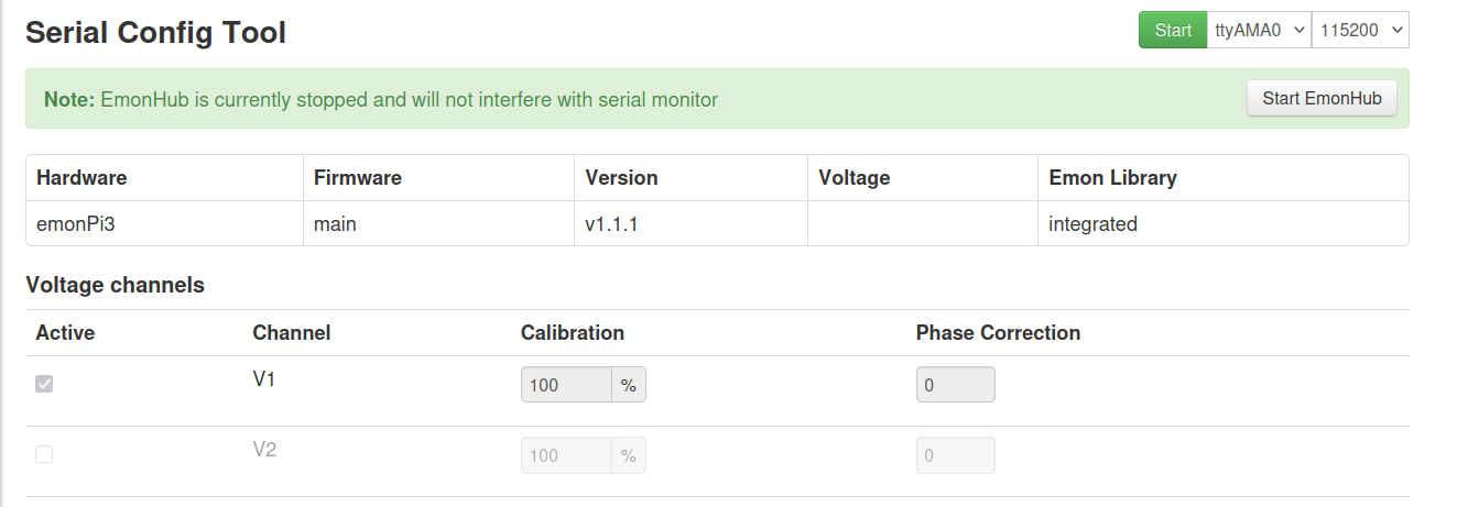

I try to make changes via the Serial Config: Admin–>Serial Config–>Stop EmonHub–>set to ttyAMA0–>Start I make a change, eg CT 1/V Chan 1 set to 3, save changes, stop (serial), Start EmonHub. But when I go back to Serial Config, the is no change. What did I miss?
This doesn’t show what I originally saw when I started up so I downloaded the emonPi3 image, copied it to a 32GB SD and it looked like it started OK, but I couldn’t connect to the WiFi because the password was wrong. I looked at the page emonSD DownloadCredentials for passwords, but none worked. It seems that the password must be 8 characters. Is the password what is shown briefly when the emonPi3 first boots?

I re-imaged the SD card. The Serial Config page looks like it did before I re-imaged it. Am I right to assume that the data is stored in NVRAM?
I am able to change parameters and they seem to stay fixed.
When I change CT1 to V Chan 1 to 1 and V Chan 2 to 1, the power goes to 0W. The same results for CT2 setting to channel 2. Wait! CT1 power has gone to 1905! I measured the current at CT1 and CT2 and it is about 18A which is what would be expected, ~120*18=2160.
I tried 1 & 3 and 2 & 3 which also yielded 0W. What if the V3 in the emonVS were connected to the neutral? Would that achieve the desired results for this configuration?
When I click the Active box on V1 and V2, they stay clicked but the console reports No changes to save. A subsequent start-stop cycle unchecks the boxes.

I’m not sure I understand what emonCMS is doing in the background. The inherent assumption, which reflects the physical connections inside the emonVs, is the voltage is measured Line – Neutral. If a load is connected Line – Line, you need the voltage at both ends so you can subtract one from the other to get the voltage across the load. If @awjlogan has copied emonLibCM & emonLibDB in how it calculates power in his software, then needs only one voltage – of the Line the c.t. is drawing current from – to calculate the power, and so there should be nothing entered in the second voltage connection column. But you don’t have that option, only 1, 2 or 3 is offered, so it looks as if @TrystanLea had done a fiddle in emonCMS to say, in effect “If you say both ends of the load are connected to the same line, I’ll assume you mean Line – Neutral and instruct the measurement end accordingly”.
What I’m telling you to do is tell emonCMS the load is connected between L1 and L3, so it should use V1 & V3, and V3 always has zero volts on it (like the neutral) because it is not connected (but you could connect L3 to neutral and it should be exactly the same) and when you put 1 and 3 for the voltages, the maths will calculate the voltage of L1 with respect to L3. If you reverse that, it will calculate the voltage of L3 with respect to L1, which is the opposite sign, which will reverse the sign of the power! Which is what you want.
If you can wait, your problem has triggered a discussion and we’re looking at tidying this up to make it clearer and hopefully add a tickbox to reverse the power, so as to correct for a wrongly installed c.t.
