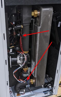

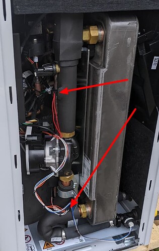

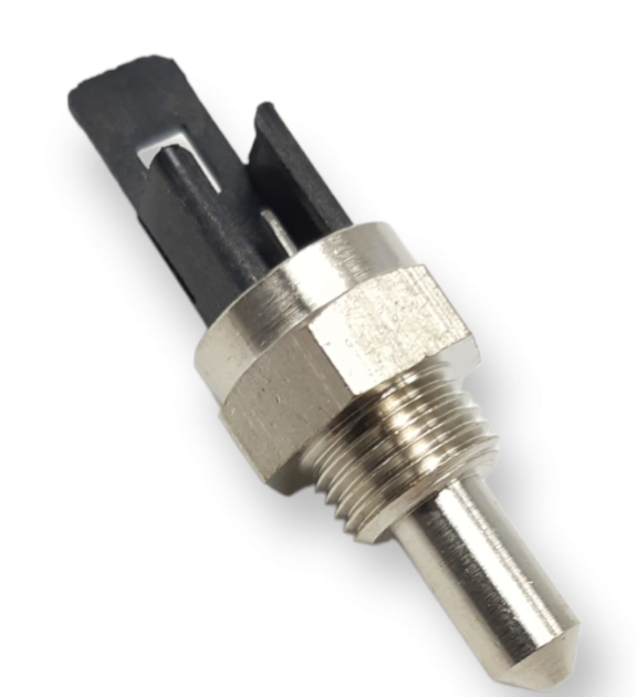

Here’s what I think are the temp sensors, they look like they are in pockets with two red cables attached:
 ![Google-Photos](https://community.openenergymonitor.org/uploads/default/original/3X/5/5/55a1193ed1af40b73b0a0a95ed433f759f742246.jpeg)
~~It looks like one of these Vaillant sensors, the same as they use for boilers (part No. 2415622). Can anyone confirm that this is the exact part? Since it’s an OEM part I can’t find any spec data:~~
 ![Screenshot from 2024-04-03 21-11-44](https://community.openenergymonitor.org/uploads/default/original/3X/6/0/60f11d8e079b64b8ff7fb9d3c7a34de48f679191.png)
**Update 5/08/24: the sensors are actually clip-on, [see recent post](https://community.openenergymonitor.org/t/vaillant-inbuilt-monitoring-vs-mid-meters/24230/79)**

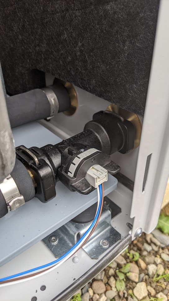

Here’s the flow sensor:
 ![PXL_20230827_135857173](https://community.openenergymonitor.org/uploads/default/original/3X/7/b/7b5b6bfb9eee53d7767c76d0973e107f1f0e6816.jpeg)

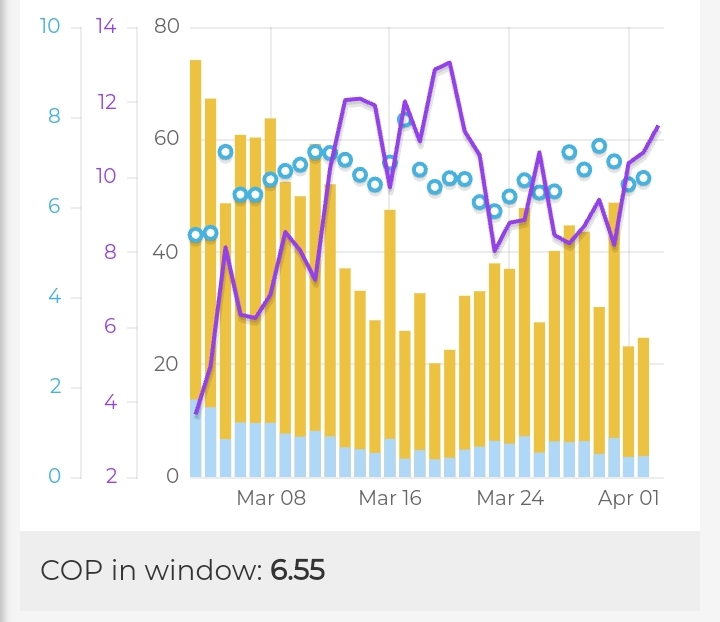

**Post date:** [3 April 2024 21:55 UTC](https://community.openenergymonitor.org/t/vaillant-inbuilt-monitoring-vs-mid-meters/24230/73 "2024-04-03T21:55:57Z")
It’s hard to see how pocket sensors could produce errors as big as I’m seeing…
 ![Screenshot_20240403_224939](https://community.openenergymonitor.org/uploads/default/original/3X/b/e/bec2be292b637aabfc4434ae1ab42c3096be18a6.jpeg)
30 day COP of 6.55 doesn’t seem believable, and the trend doesn’t match the outdoor temperature like others do. MyVaillant is overestimating heat by about a third, but not consistently.
Could there be air or something messing with the flow sensor? Is there a setting within Vaillant to tell it about glycol?

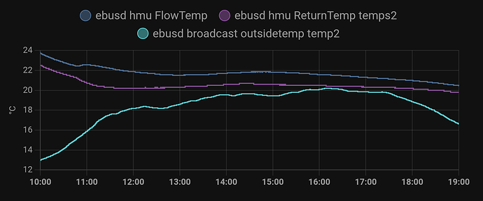

Looks just like my system.The inconsistent variation with temperature comes from two points in my opinion:
- Fixed dT error: The temperature measurement offset error is fixed and does not vary with flow temperature as opposed to the true dT which increases when flow temperature increases (Vaillant uses fixed flow rates).
- Compressor cycling: Between cycles, when only electric energy from pumps/standby is accumulated there is no heat energy error. Say you have a true COP of 4. During a cycle you utilize 1 kWh electrical energy and get 4 kWh heat. Vaillant overestimates by say 25% and displays 5 kWh heat and a COP of 5. Between cycles only the pumps are active and for sake of this example you accumulate 0.3 kWh electrical just from the pumps. Vaillant includes this in its COP figures and will display 5/1.3=3.8 as COP. So at outdoor temperatures when the pump is not cycling, you will see more of the expected temperature dependence of COP, whereas this levels out when outdoor temperature forces the pump to cycle so that pure pump power becomes a significant fraction of overall power used. For my system at warm outdoor temperatures, this leads to a COP reduction from 6.5 just looking at the compressor cycle to 4.8 including the pump power between cycles.

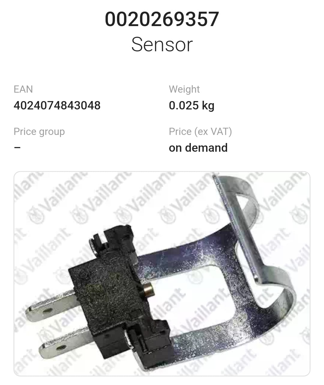

**Post date:** [5 August 2024 00:33 UTC](https://community.openenergymonitor.org/t/vaillant-inbuilt-monitoring-vs-mid-meters/24230/79 "2024-08-05T00:33:59Z")
> [@glyn.hudson](#):

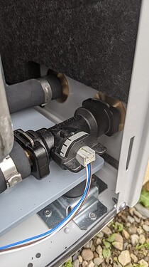

I was wrong about these 👆 pocket sensors, I’ve heard from an internal source at Vaillant that the sensors they use are clip on sensors with tiny copped tipped NTCs, they clip onto the outside of the pipe. This is the exact part 👇:
 ![453843678_10159608101362016_7579929461663667615_n](https://community.openenergymonitor.org/uploads/default/original/3X/e/b/ebefe446dc19c4c7265017f360afa4ce99ca1fc4.jpeg)
The fact these are clip-on sensors explains probably explains why some systems have significant temperature sensing errors, possibly the sensor is not fully clipped on?
The good news is that it should be a relatively easy fix to remove the side panel of the HP and check the sensors are clipped tightly to the pipe. Can anyone experiencing significant errors confirm if the issue is indeed a poorly clipped sensor? @Timbones @Andre_K @dfeist. Removing the side panel is quite straightforward, from memory you’ll need to remove the top cover first, which will then expose the screws on the side cover. You’ll need to remove the side cover closest to the flow/return connections. Please take some photos if you find any issues with how the sensors are attached,
 ![](https://community.openenergymonitor.org/uploads/default/original/3X/5/5/55a1193ed1af40b73b0a0a95ed433f759f742246.jpeg)

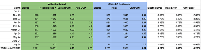

It does seem that if you get lucky and have a system where the sensors are clipped on properly, the onboard monitoring can be pretty good. Here’s another data point: Comparison between the onboard monitoring and MID meter data from a 5kW Arotherm+ that I [installed for my parents](https://www.youtube.com/watch?v=bHsp7fDw_bg), the data from this system is [on heatpumpmonitor](https://heatpumpmonitor.org/system/view?id=75), the onboard heat & elec data matches the MID meter within about 3-4%. However, I’m still very glad that I installed 3rd party monitoring, the data granularity has provided a lot of additional insight.
 ![Screenshot 2024-08-05 00.03.19](https://community.openenergymonitor.org/uploads/default/original/3X/8/0/8077a262251ef1fb6e69254a09c5fe4b6f413f56.png)
Interestingly, the Vaillant ‘Energy efficiency’ figure shown in the app had average 7.3% error compared to MID and was different to the calculated **COP = (environmental yield + electrical energy) / electrical energy**, I decided to use the calculated COP figure since it was more accurate but most users would probably just look at the ‘Energy efficiency’ number. Can anyone explain this discrepancy?
 ![Screenshot_20240805-011820](https://community.openenergymonitor.org/uploads/default/original/3X/2/a/2a7e8dd6df78a1ae14f8278afc3e3b4e0b630704.png)
All these figures were taken from the MyVaillant app, I’ve not yet compared these figures with the working figure displayed on the Vaillant controller.

How would I identify a poorly clipped sensor? Is it wiggly? And more importantly what can I do about it? I just want to make sure I do everything I could do once I open up the device.
