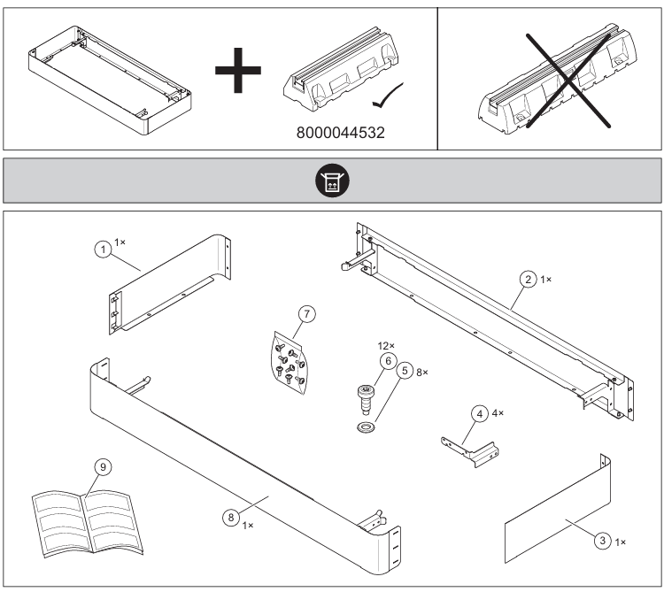

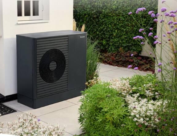

Realised it might not be clear what I’m talking about…
The new Vaillant aroTHERM Plus models can have this optional skirt, but I don’t think its available in the UK yet:
 ![image](https://community.openenergymonitor.org/uploads/default/original/3X/4/5/45047b0e32d7f7a9275a79d7b17b33688382e4a9.jpeg)
In order to install the skirt, the instructions state that shorter rubber feet should be used:
 ![image](https://community.openenergymonitor.org/uploads/default/original/3X/4/1/41cd7678c032e53540f347c18132943c378839a3.png)
Anyone managed to source these feet in the UK?

Thanks Glyn. Have you heard of installers swapping the **feet** on an already installed unit, and would you consider that a straightforward job?
My installer can’t currently source the compatible 400 mm feet, so the plan is to install on standard feet at the end of the month, then drain it down, swap the feet and add the skirt later, at an additional cost when that kit becomes available.

**Post date:** [2 October 2026 13:23 UTC](https://community.openenergymonitor.org/t/vaillant-arotherm-plus-8-1-uk-skirt-compatible-feet-availability/30339/5 "2026-10-02T13:23:03Z")
> [@Lewis\_P](#):
No, I’ve not heard of this being done, but it doesn’t look too difficult.
I’ve swapped feet on a heat pump after install, it’s not difficult with two or three people. Heat pumps are usually installed with flexible pipework connectors; therefore it’s possible to move the heat pump around a fair bit without disrupting anything, draining down should not be required.
